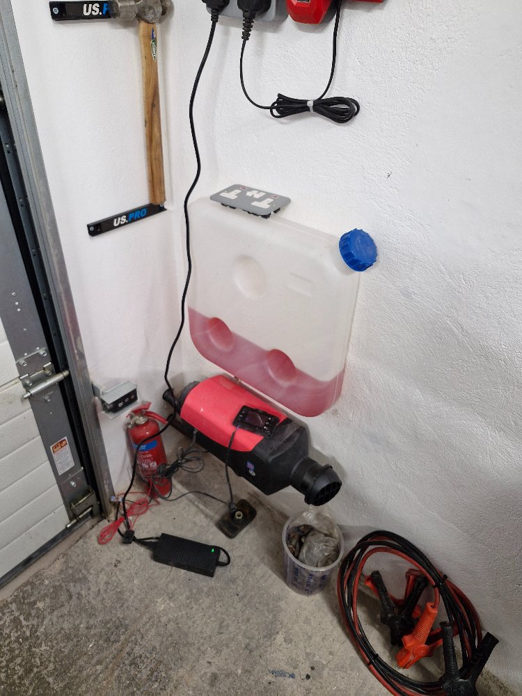

Sounds good enough for meWas in the garage for five hours yesterday with outside temps of minus one.
The 8kw (badged) heater got the inside temp up to 11c after half an hour. Five hours burned maybe 1/10th a gallon of diesel.

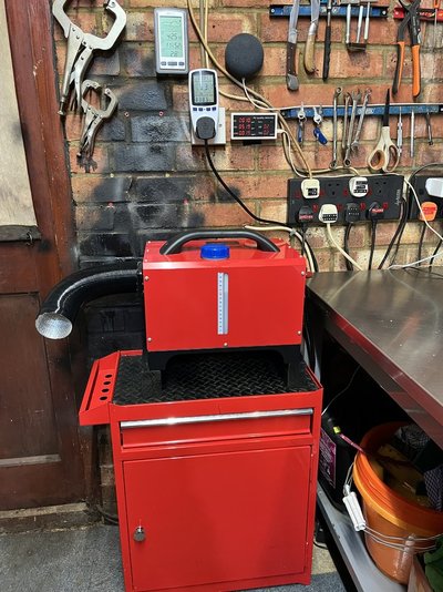

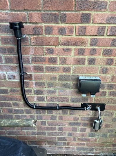

Re sooting up, mines about 1000 hours in, run off a PSU with a fairly short exhaust exit.Diesel will burn slightly hotter than kero but not as clean.
