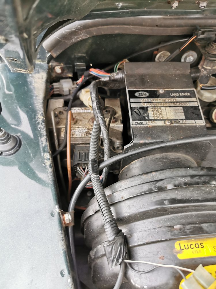

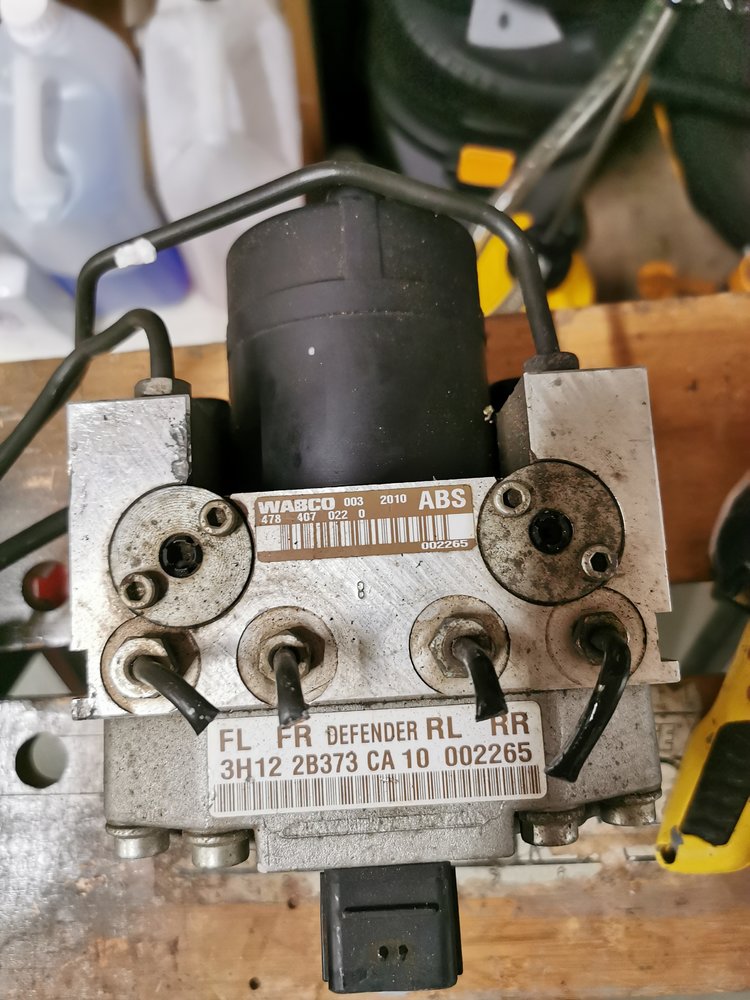

Suspect so, I see there is a company that reconditions your modulator block for £200, may be the way to go.My 110 is one of the first year which had the ABS/TC setup, I think you will find that you have a combination of the seals failing as @premmington says and corroded wiring/switches within the pump.
