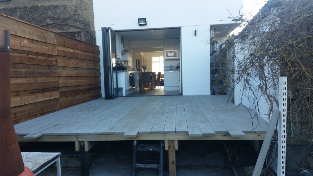

right i need some ideas on how to make the steps at the end the mrs wants them full width yeh that was easy but she now wants them to be able to lift up so we can store stuff under the deck great idea
I had though hinges and some large gas rams like on car boots ect
unless she is storing galvanised stuff under it its not going to be dry or last too long.
you sure she isnt thinking about your stuff...
you could make them up on their own frame and then as you say install heavy hinges ( personally id only install stainless or galvanized hinges) .
sit the step frame butted up to the end of the decking in such a way when its in situ the hinge is taking no weight and just keeping it in place but yet everything lines up good.
id make it in such a way that when they would be up they would have turned 180 dgs and raised out of the way.
then figure out your gas rams, id opt for stainless ones by right unless you can protect them from the elements.
I dont think i could get 180 out of the steps due the the way they will be 90 deg yes before they hit the first riser unless i re jig the stairs completly and have the first step the same height as the deck but i think that will look wrong
would you see it tho, if you done it right all you would see is the tops of the hinges it would also support itself when fully raised.
just a thought now.
it is imo but there id be a bit of work to it.
making up an independent step with the first thread level with the existing decking unit and then hinging it to the face of the deck will work but its not going to be the lightest option.
if you only raise it 90 dgs to me id see it as your loosing a couple of foot of space so now you have to get down under it to push the stuff in.
are you running a riser on the face of the decking to cover it up @ the 250mm before the step?
you could make metal frames and then bolt your threads to them, it id be a lighter affair.
without being there and just going on the picture you could cross the end of the decking level with the first thread, it id make it 8" odd longer but thats about it.
the step planks will ru at 90 deg to the main deck plan is to make the steps two planks wide and 2 high and just 2 steps, I think the deck would look odd with planks running at 90 deg across the end. I think I have talked the mrs out of having storage underneath in the last half an hour, ok it is a wasted space but i would just fill it full of usefull stuff honest!
so tomorrow i will get on and build the solid steps I think

i think its safer all round to not have storage there, safer for me because i wont store loads of good stuff under there or crap as she calls it! the steps will also be more solid and secure, easier to build, if i do store stuff under there the rats will love living there too I am sure.
