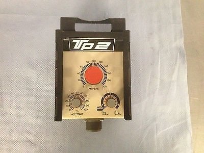

Talking stick plants is it worth buying this for when I get my one back. Have you had any experience with this remote. I'm doing more and more of it and unsure of whether to buy a dedicated unit or the remote for mineI think all those multiprocess compact 230v machines are a bit pointless without hf.to say one is better than the rest without that feature doesnt add up.

What do you mean turning on and off. Can you not just alter it on the remote while it's onIt was one of the things on my to buy list.changing the arc force or hot start requires turning off and on the machine which is a chore if stick welding a lot.

Ah I see yes you need to turn off and on with out the remote.You need to turn the machine off to access the menus to change most stuff if you dont have a remote.theres 3 or 4 separate remotes available.

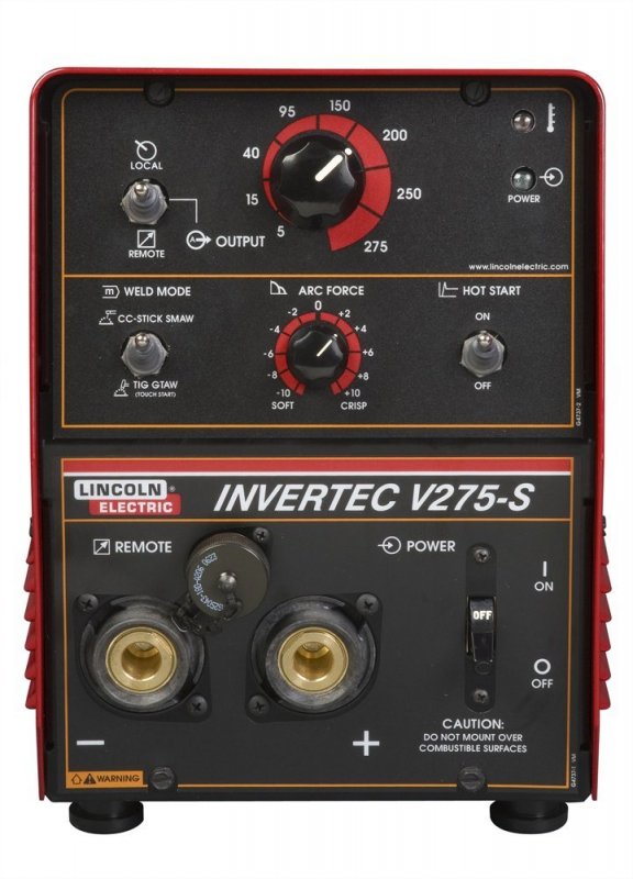

lincoln v275s for stick is a dream to use.
Whilst we're on the subject of big fancy welders, does sub-arc exist as a manual process or only an automated one?Yes there is AC mig but it's for special applications such as very thin sheets. Mig for Alu is DC + so there is plenty of cleaning
Oh yeah, it is a v270 but it looks better than the v275I can only find a v270? Bit of a difference in price and performance
this is a 275

.Just the tig and 800 quid bit thats dissapearedOh yeah, it is a v270 but it looks better than the v275.

The v270 is still a tig for under £800, it's the new, DC, 240 volt, single phase and with warranty that's disappearedJust the tig and 800 quid bit that's disappeared![]()
