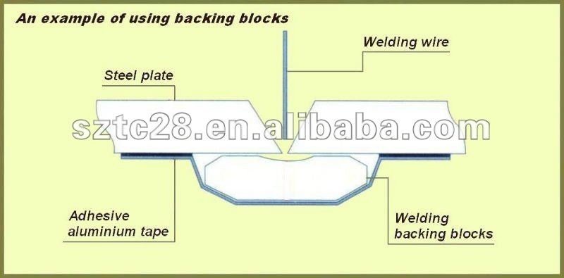

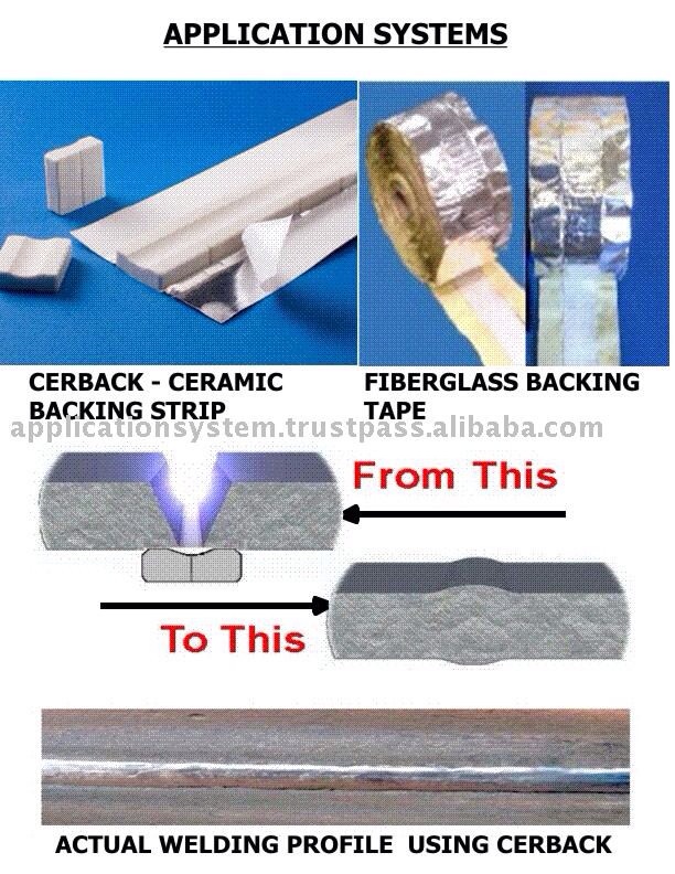

Not really. And I'm not too sure how usable they will be on such thin steel. Maybe ok. The idea is you set up your butt joint then on the back you stick down your ceramic backing tiles then turn it back over and weld it from the front. The intention is to slightly burn through onto the ceramic behind which will stop you blowing holes. The shape of the grove in the ceramic creates the perfect looking root side. I'll put some pictures up if I can something good.
