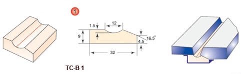

you don't stack the beads directly on top of each other.You put the first bead in-the root- then you build up by "tying" in the other beads to the root bead.The root ties the joint,then you add passes to the root, tying in the root to the parent metal of the joint.
Here is chuck e9s take on it.
It was not that common in our shop back in nineteen hundred and frozen to death because we had a plant that would run electrodes of something like 6mm, and possibly, we ran an oxy A torch down to preheat-I forget.
