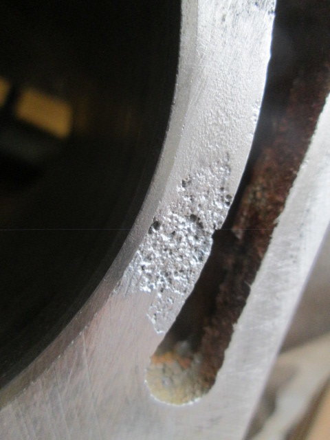

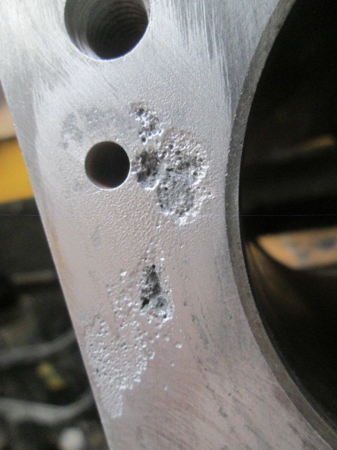

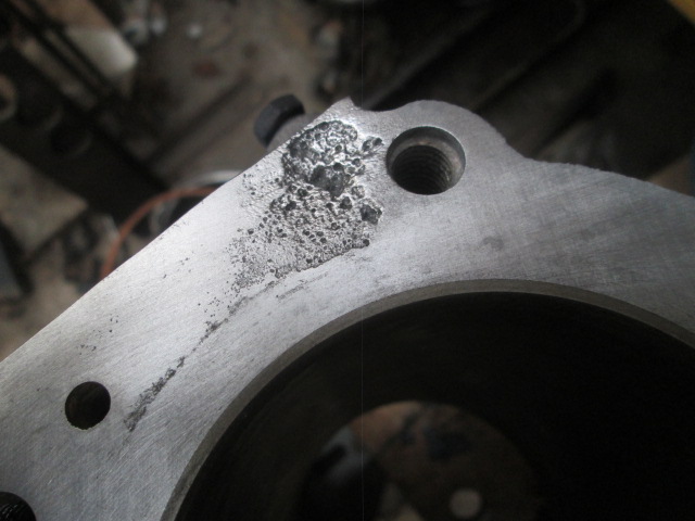

With my ongoing problem with a Rover V8 engine in my Coupe, the next obstacle is corrosion on the block to head face. On one cylinder it is right up to the liner, so more like as not there will be a compression leak to waterway.
It is its original engine, and while it might be easy to find another block, as I have more or less decided to sell it, I would rather it go with its original engine as I dont want to spend money on it.
I tried JB weld Extreme Heat, but that came straight off with a pressure washer, despite the claim that it is waterproof. I have got some Technoweld somewhere, but I imagine the problem will be getting enough heat into the block for it to work. It melts at 380 degrees C and is supposed to be harder than aluminium, so should work ?
Anyone had any experience of it, or maybe got any otherbodges low cost repairs ideas ?
