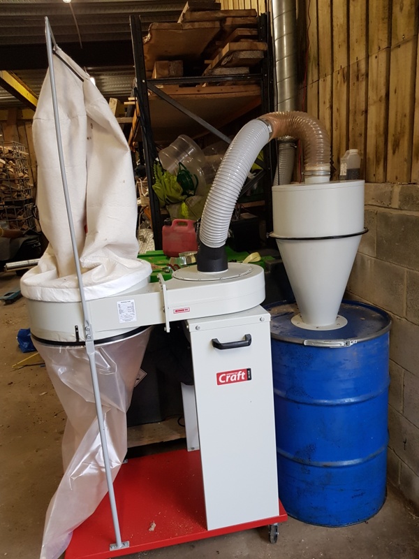

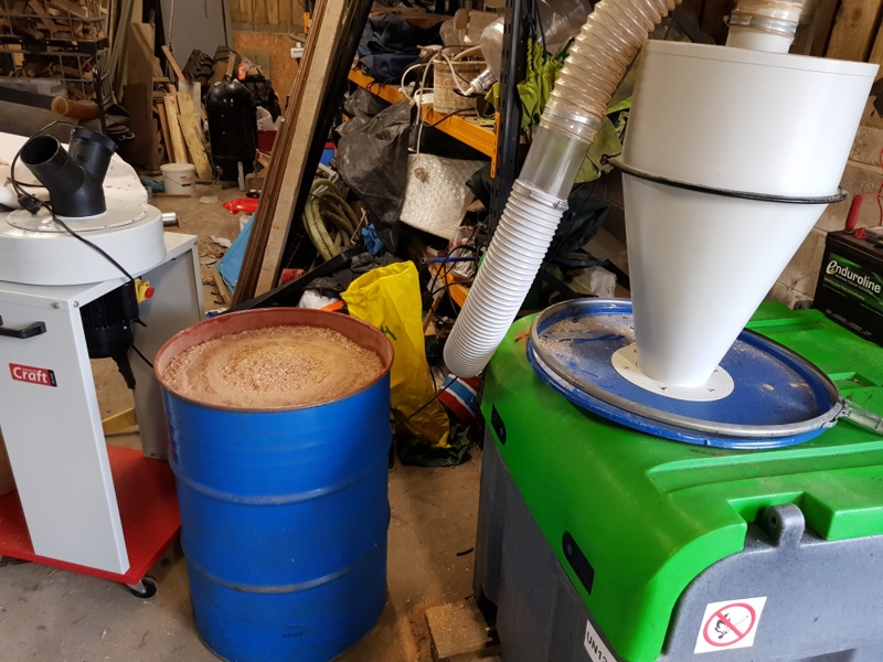

I have been looking into this because I want to build one as well, and it seems that Bill Pentz has a load of good info on his website.
Saw him referred to all over the web, thought I'd share.

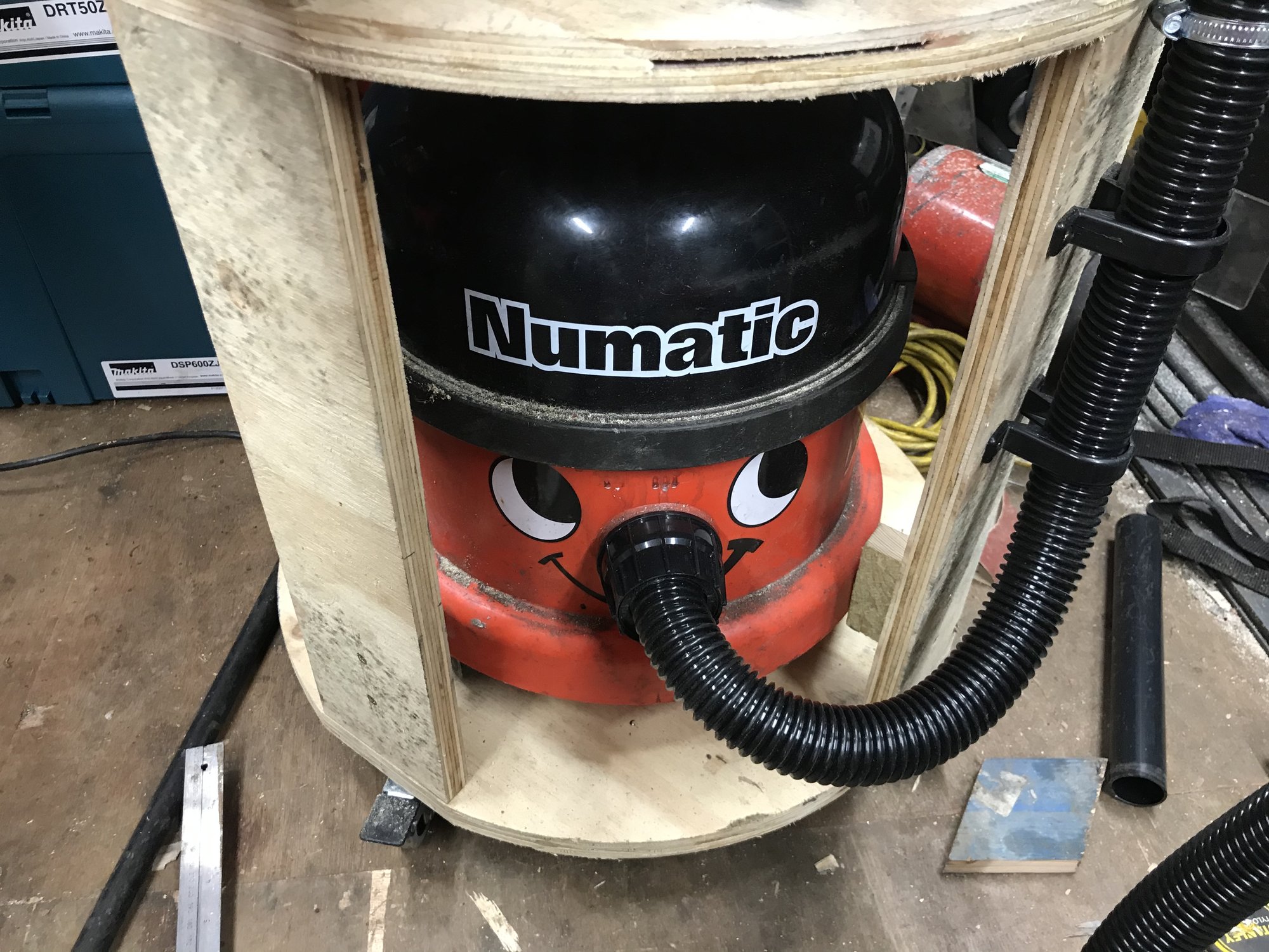

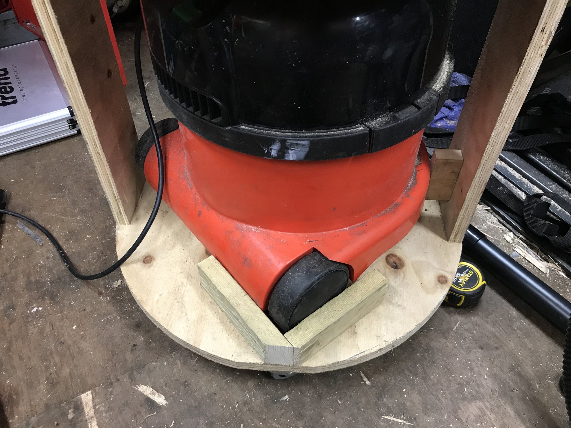

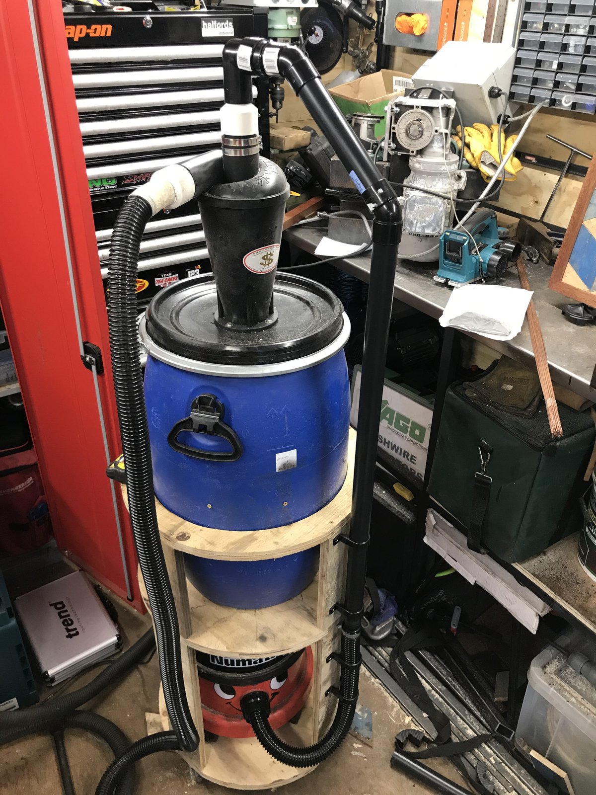

I needed to finish the cyclone mostly today because the old Henry hose I had going to the top was crushing a fair bit when sucking so I picked up £10 worth of plastic pipe bits and made a new tube which is great and not so restrictive. View attachment 270609
Then to keep the hoover in place I put some little Packer blocks in place and made a Corner bit to retain it where it is. I can just lift it over if I need to get it out now which is nice. View attachment 270610View attachment 270611 All I need to do now is put some steel uprights on to secure the hose when I wrap it around the barrel. Also I plan on doing a switch on the side so I don’t need to keep switching it at the wall. I’ll have a little think before I do that though.
My hose ends have vents that can be opened and closed
Depending on the tool I'm using these can be useful. Sanding for example it's good to let a little airflow through as the inlet holes are blocked by the workpiece and gives both the machine and hoses an easier time.

Yes it is. 32mm I think.is that solvent weld pipe Kim
Yes they’re 50mm ends. You got the spacers with yours I assume? Do you want me to link the step down spacers that I used?Hi,

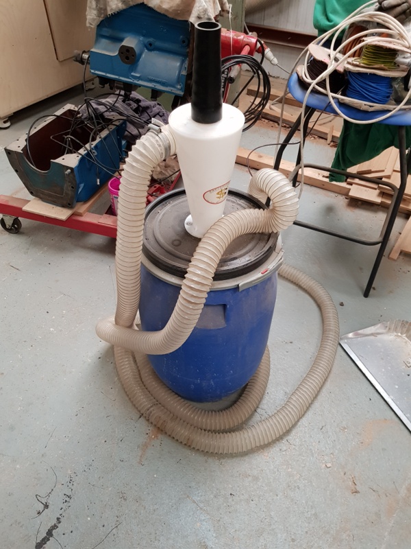

For my small needs I've just bought a new Henry it's due to arrive tomorrow;
https://www.ebay.co.uk/itm/HENRY-HOOVER-NRV200-11-NUMATIC-COMMERCIAL-VACUUM-CLEANER-2021NEW-NRV200-C2-MODEL/251379065108?ssPageName=STRK:MEBIDX:IT&_trksid=p2057872.m2749.l2649
Like Kim I too have bought this cyclone it's already with me; it looks to have 50mm dia entries.
https://www.ebay.co.uk/itm/Cyclone-Filter-Dust-Collector-Woodworking-For-Vacuums-Dust-Extractor-Separator/143837033897?ssPageName=STRK:MEBIDX:IT&_trksid=p2057872.m2749.l2649
I already have one of these mixing buckets so today gave it a good clean out; it will need a lid but I've got plenty of sheet material; it's strong;
https://www.screwfix.com/p/ndc-poly...tr/7963k#product_additional_details_container
I'm looking forward to putting it all together assuming I don't get driven out of the workshop again with the freezing weather.
