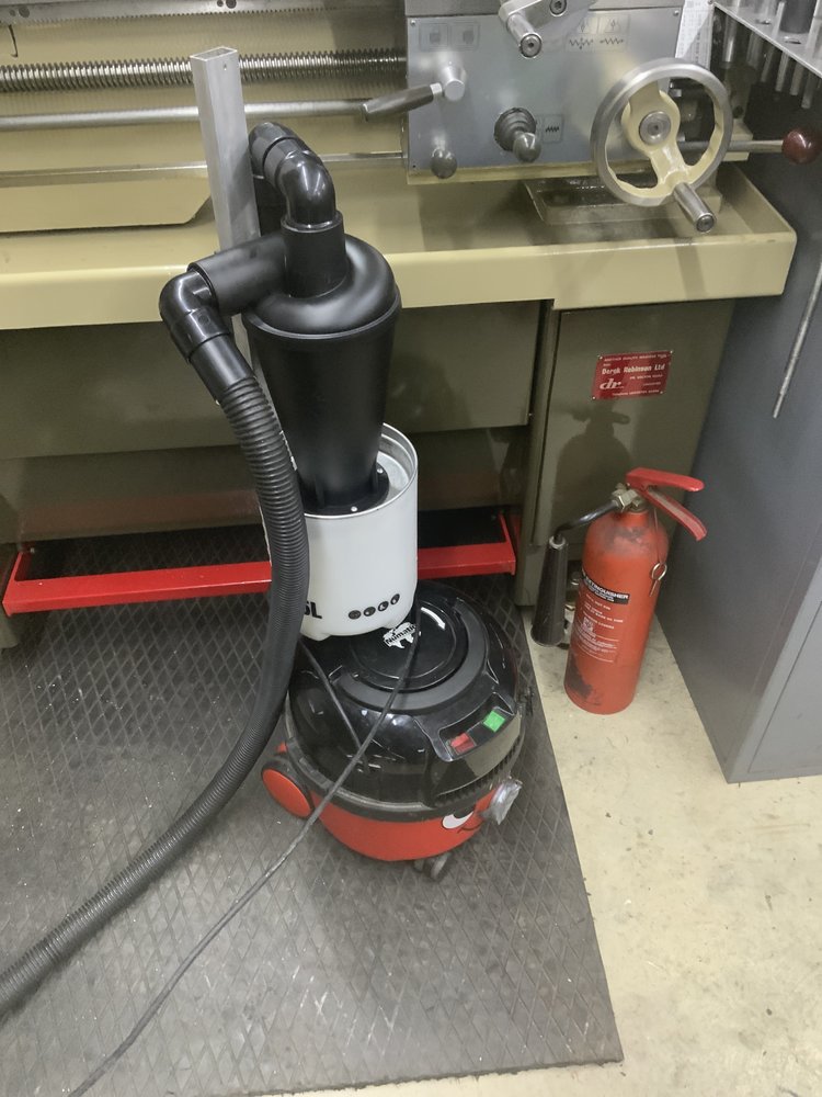

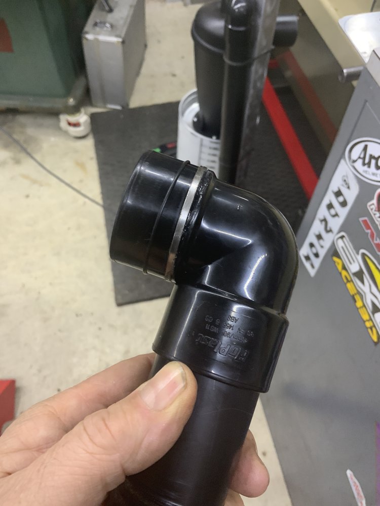

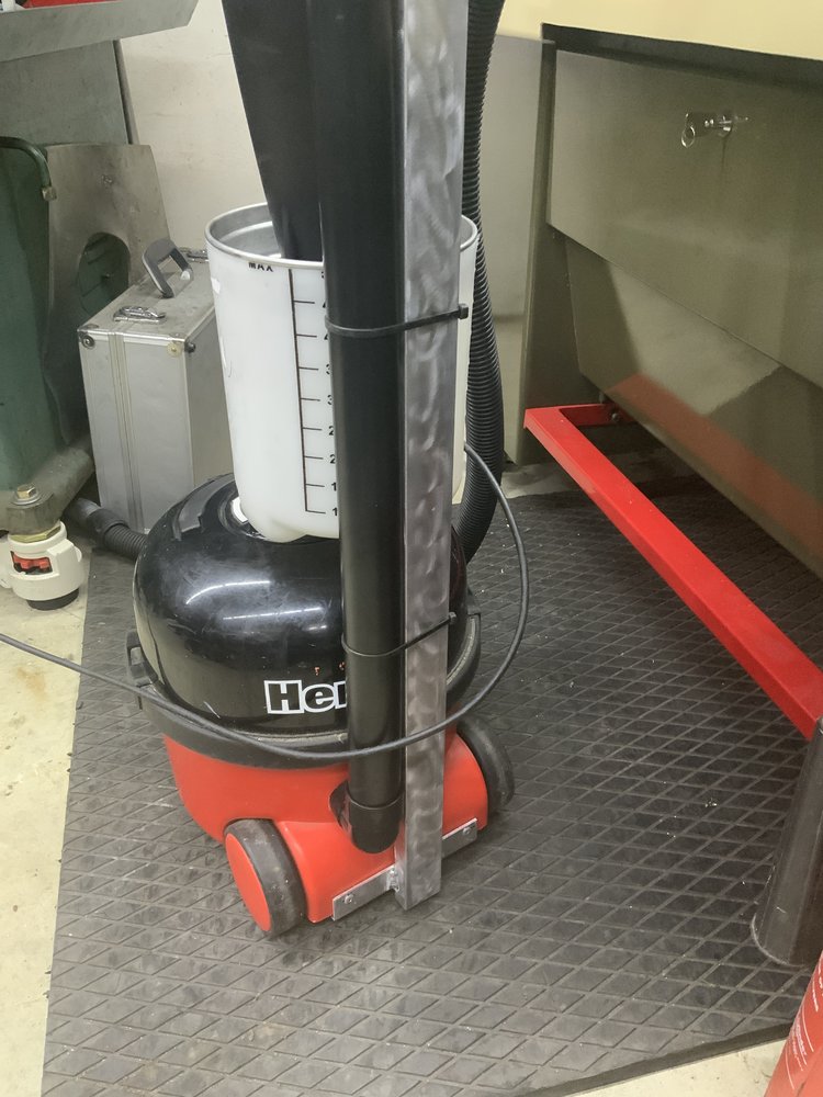

Our Henry's are virtually new so I can't give long term evaluation but the domestic one is fine for the bungalow so I bought a commercial Henry for the workshop to replace the very noisy Record Power vac I've used and disliked for a long time; as I've stated earlier I'm connecting the Henry in the workshop to a cyclone which is still work in progress but I have run it with the cyclone and it sure tugs at my hand when I place my hand over the inlet; the hose isn't large diameter unlike workshop vacs which usually have the 4" hose; I'm sure for my needs though the Henry with cyclone will be OK; once I try it in anger I'll post details but my friend David is using a vac I gave him years ago and he already has a cyclone fitted to it saying it works a treat with very little dust/debris reaching the vac filter it dropping into the cyclone receptacle instead so the vac filters remains pretty clean. I think it will depend on what you want to use your vac for; if it's for use on a heavy planer/thicknesser will it cope with the volume of waste produced.

The three machines I want to extract from are vertical bandsaw; big DeWalt radial arm saw and my home made 4hp saw bench; these put out lots of the finer dust; I'll eventually try it on my 8" planer/thicknesser and my bigger 12" thicknesser but I've got quite a bit of work ahead making extraction for all the machines; I've got plenty of sheet aluminium and also a very nice Parweld Tig welder so once the weather improves I'm looking forward to some interesting work.
