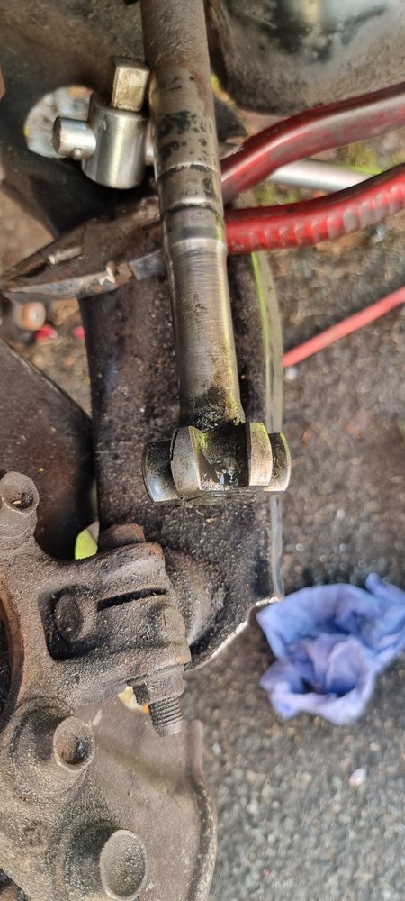

Ok..I am back where I startedstripped it all down again and the fault (is me!!) is the CV joint has not gone in far enough to pass the circlip and the joint is just spinning around... So two hours later I can't get the joint to go in and I can't get the joint to come off...even with the new puller !! So I think I need to get the help of a mobile mechanic who should have a lot more experience than me .... swimbo says that's what I should have done in the first place!! (and she's right).
