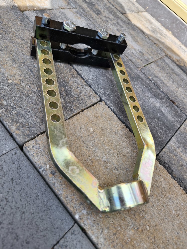

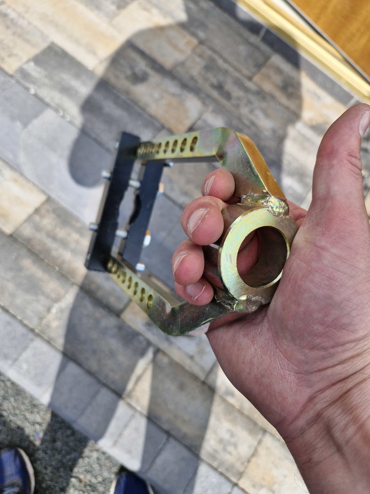

Ok ... it's off!!!! Just to answer first. It's an automatic.
I ordered the complete assembly for £80 off Ebay.. didn't fit only place I could get another was from mazda no change from £800 ... no thanks! Outer cv is same as manual £48 delivered.
I managed to cut the inner race and remove the balls .. with a lot of hammering and swearing I got the joint off but it left the spider on the shaft. ... tried everything to get it off but ended up cutting in half and using a hammer to remove it!!!!
Should be easy now to fit new cv and get everything back together .. I'll post some pics later
