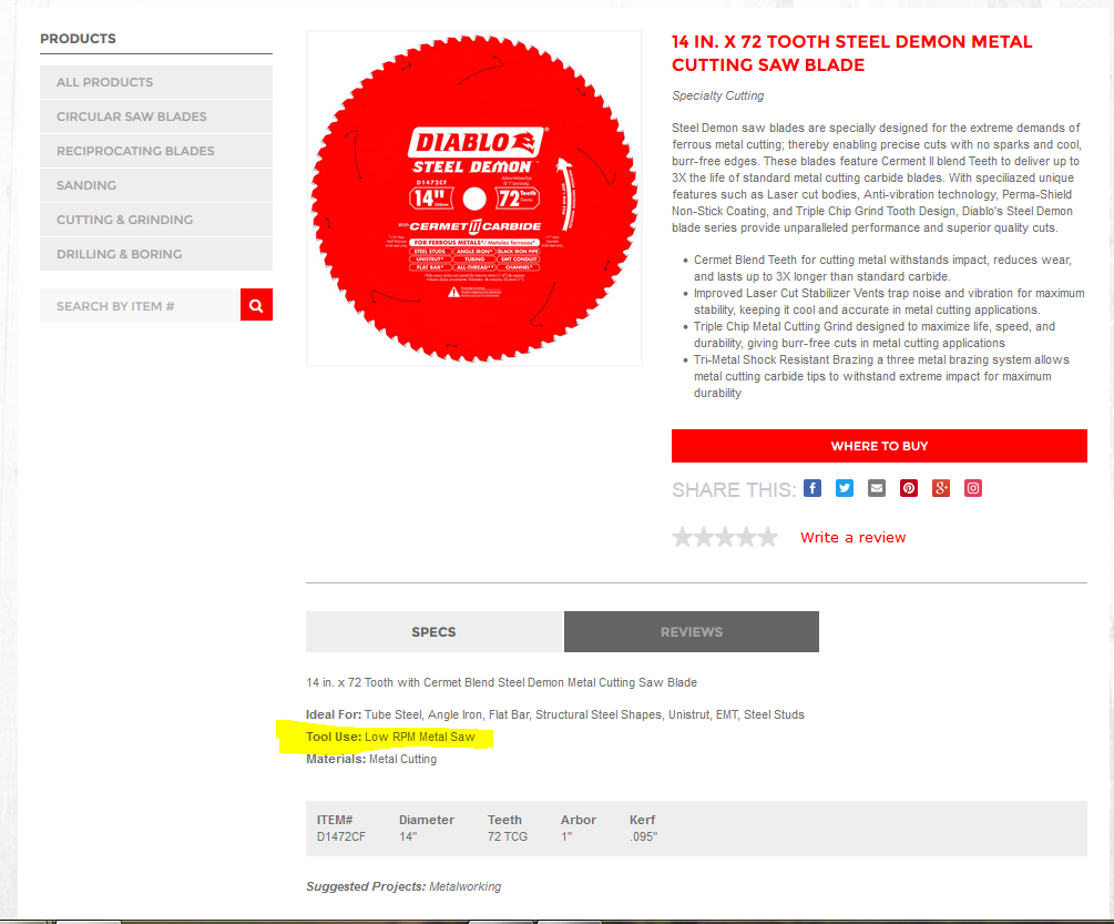

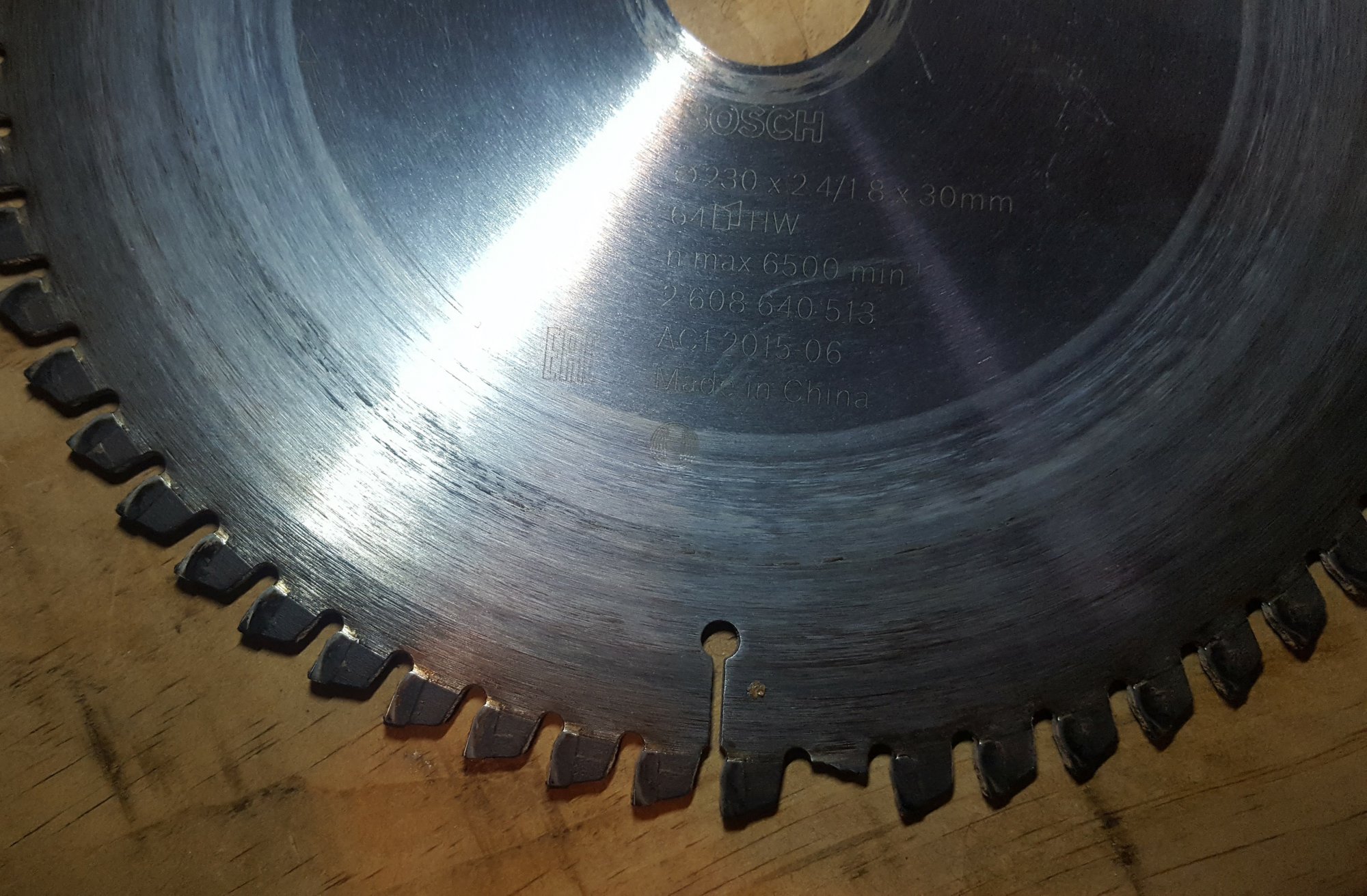

If they did exist manufacturers would be shouting it from the rooftops as currently you need an abrasive OR(and??I must admit I've just done a search and can not find any high speed blades to replace an abrasive disc
) a tct saw. I'm not doing this just to be argumentative but if someone didn't know and took that advice on face value they could end up wearing a tct necklace, or at very least knackering a blade in short order. Bad advice IMO and it's just being touted to sound clever.
I'd be happy to be corrected with a proper link but the fact no one else has seen them either makes me pretty confident they don't exist.
