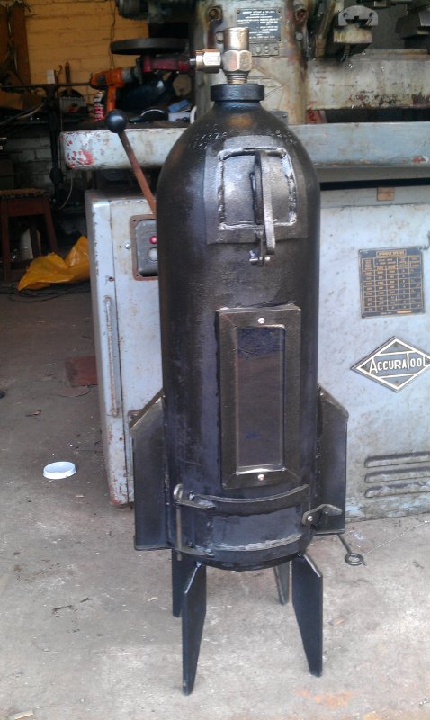

doubleboost made some wheels for his lister trolley with one. I'm it would make an awesome wood burner or rocket burner. Are they just laying around there?There's also a lot of stray BOC full size (W ?) cylinders about, ive never found any idea what to do with one, they must be at least a quarter of an inch thick going by the weight.
Smaller wood burns better because it has a higher surface aera.Why would it make a good wood stove ?
Wood burning needs the biggest logs you can fit in the fire box, the smaller it is the more often you need to fill it, and doubles the work of cutting and splitting the wood into little bits.
Heehee. I left that there for that Indudtrial effect. I would have replaced it with a big red button and stencilled DO NOT PRESS, but couldn't find anything suitable. The owner loves it, it heats an old brick outhouse studio.Do you let the smoke out by opening the brass tap?![]()
So it can make a good wood burner.This is the one I made. The air intakes are the fins. Air goes up the sides of the burner to get preheated. Control is by swivelling the bar at the bottom to open or close the bottom of the boxes.View attachment 47619
Oh yes! With a lot of effort and a bit of thought. And an 8mm thick oxy bottle rather than a calor!So it can make a good wood burner.
