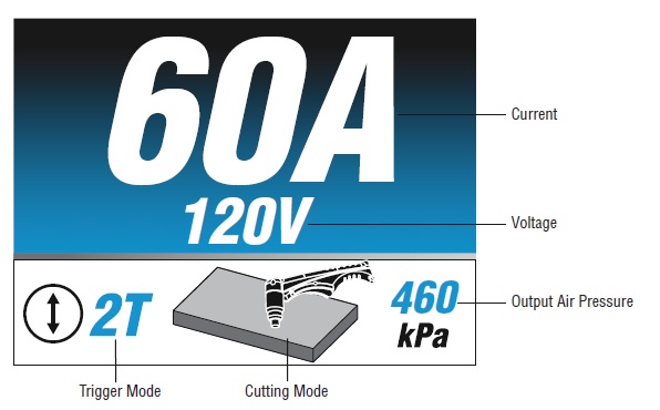

I always use 100psi too but my plasma cutter has an internal electronic pressure regulator that sets the required torch pressure. Does yours?I always run my cut 40 at 100PSI and Ive never had any problems cutting anything up to 8mm. Sounds like a lack of air pressure might be responsible to me.
