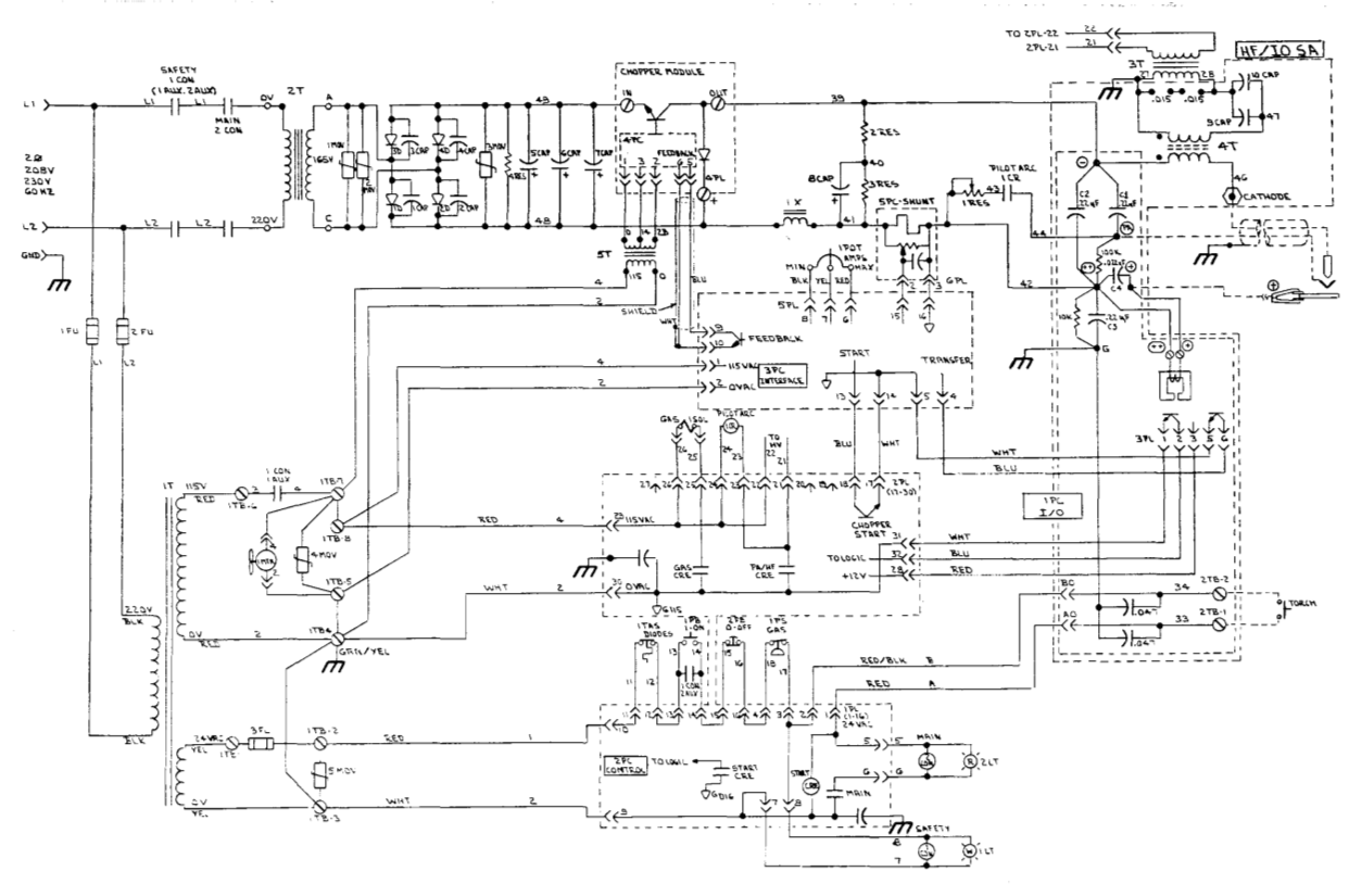

I did try a resistor in a previous design but the wattage required for the pilot arc was rather large and much more expensive than the current sensing relay. I forgot to mention that this is a 60A plasma so a big resistor with a big heat sink is needed.Try installing a resistor in series with the pilot line to limit the current, before the contactor.
