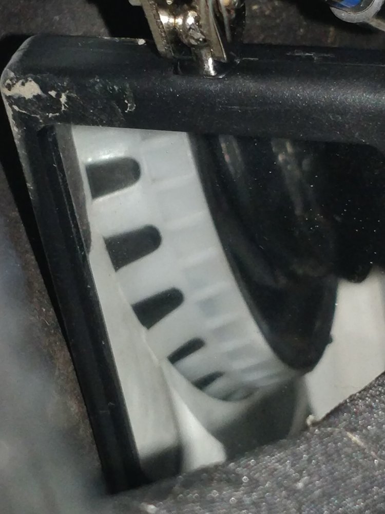

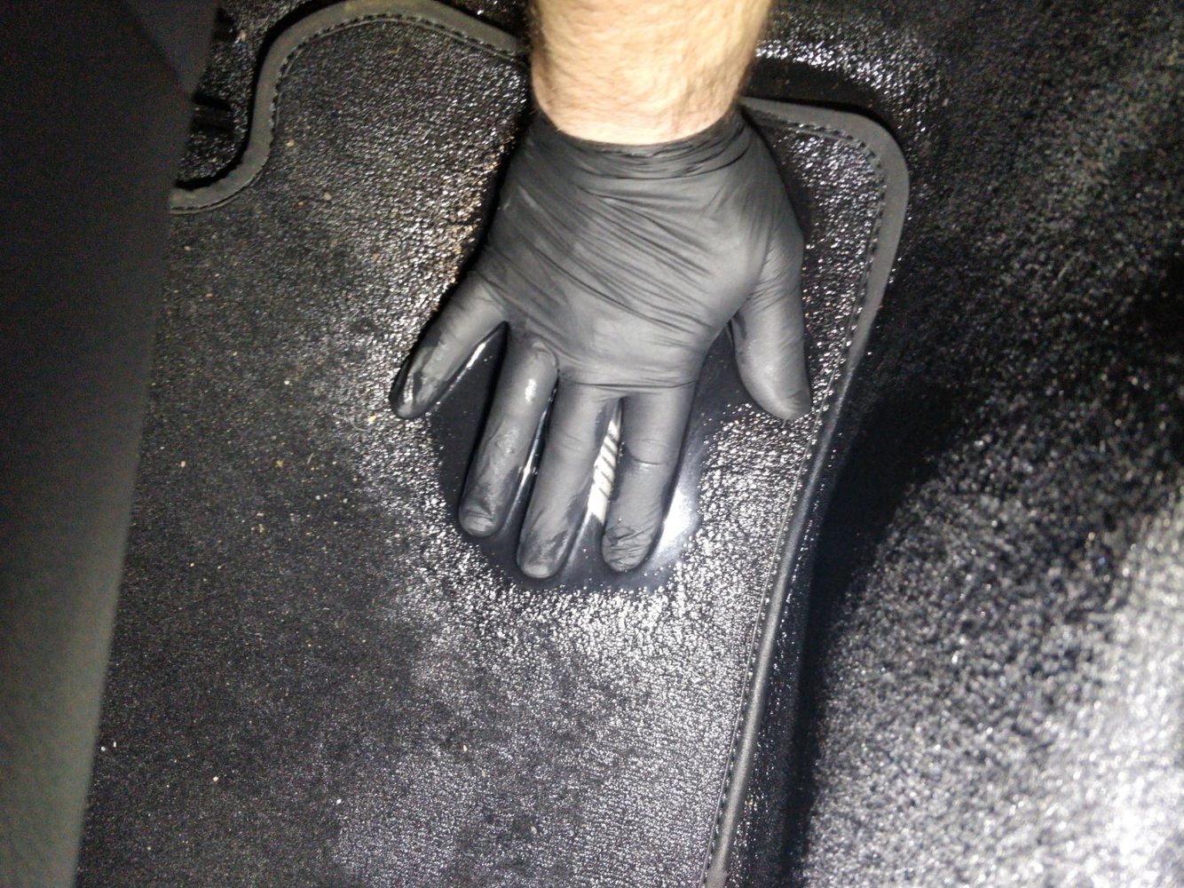

I know, I've done two replacements today.... and pushed floor grommets out on another so the water can drain out before I do a floor pan harness replacement due to a bulkhead grommet not being fitted properly at build....Correct...![]()

Don't get me wrong, I/we do lots of harness repairs (except HV) but as soon as you get water ingress to cabin harnesses, it's replacement, no exceptions. Some can be surprisingly cheap, I remember a Volvo V40 (rebadged Focus) with the PSA 1.6D engine harness being around £330 about five years ago, the ECM cost double that! There was a problem on the same vehicle with interior CAN getting a high resistance problem through a connector at the bottom of the 'A' pillar, the official fix was to cut out the connector and put two through crimps in it's place.
