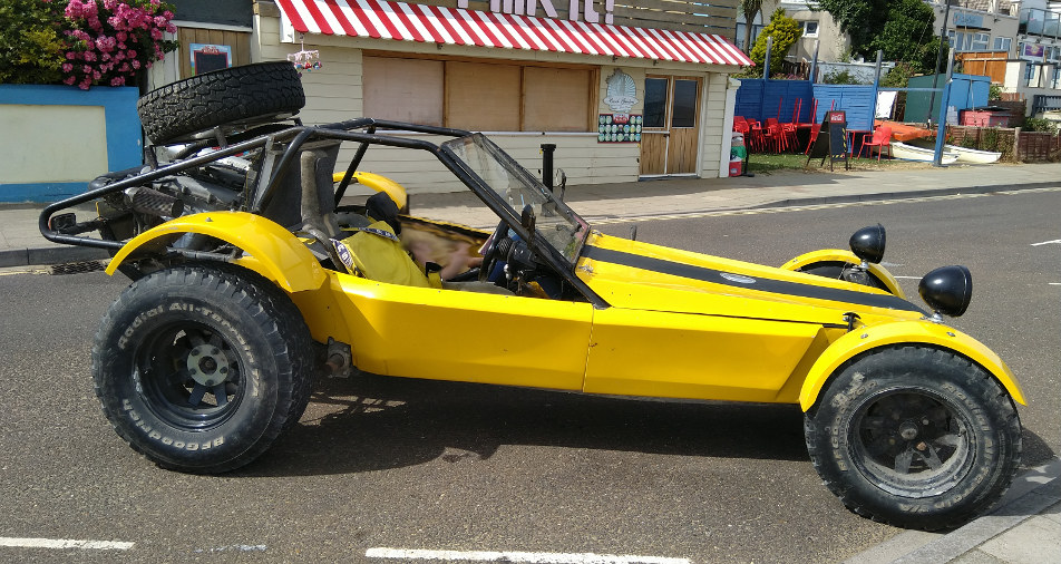

Good luck with it, they do have a VIN stamped on them somewhere mine was UVA something. The reason for the modified front screen area is that stock there is just not enough headroom without using the god-awful UVA seats.

Looks like someone had some fun with that over the years. Do you have some plan behind all your cutting and amputating, or just getting rid of the ugly and the rusty?

Absolutely! Much more fun off roadHi Nick , don’t worry the savagery has ended , I was clearing all damaged and rusted out sections .
I had given up on the road legal side of it as I would take too much to get it back legal . This will be a field car so to speak
