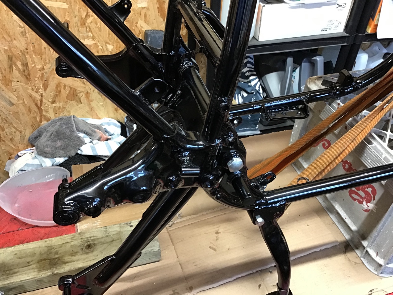

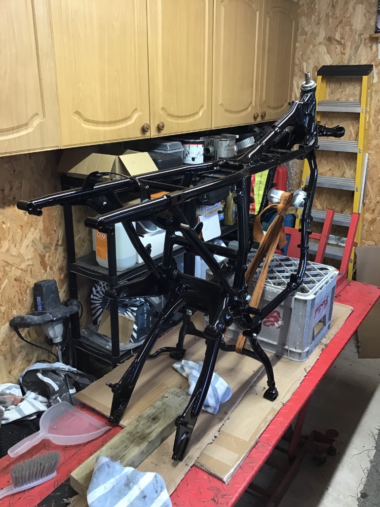

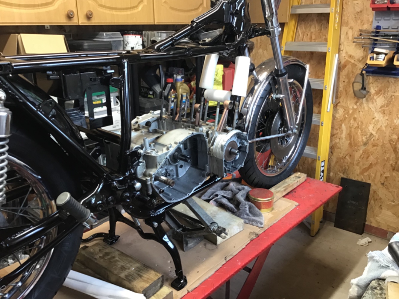

a friend of mine ,richard p, bought the 55o triple suzuki new , with insurance money from a prang on his cb 250 , he went for a spin out in the new forest, my brother on pillion, apperently they were capable of more than the speed limit , he then pootled into new milton , bike started swaying so he slowed and pulled in, as my brother hopped off...ping ping ping ..severeal spokes broke on the back wheel and it collapsed ! had to be recovered , they were lucky lucky lucky that day.Engine back in frame View attachment 505234

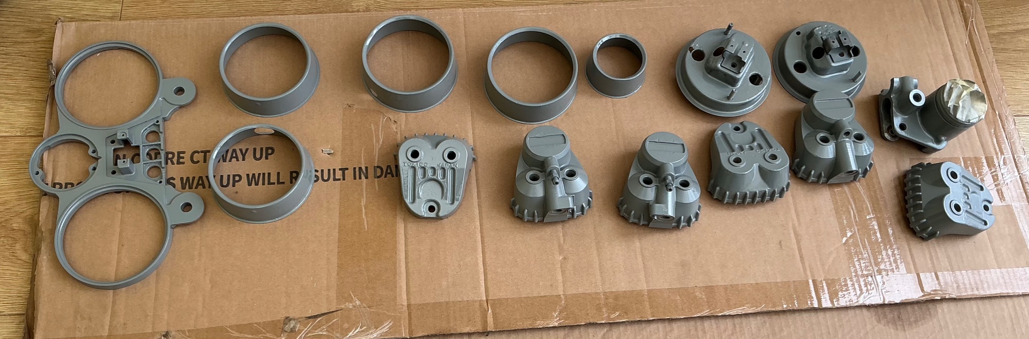

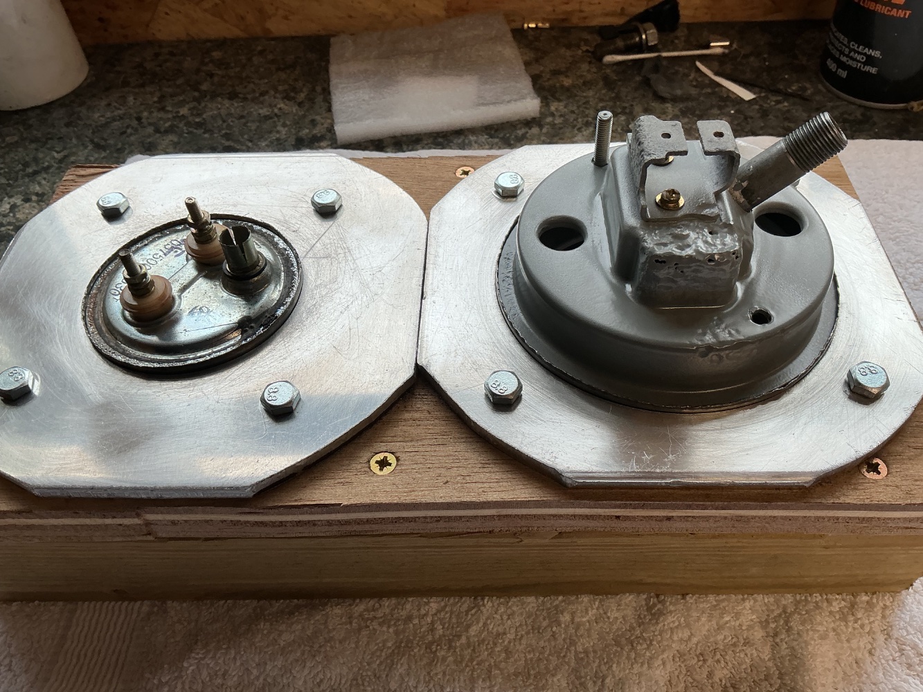

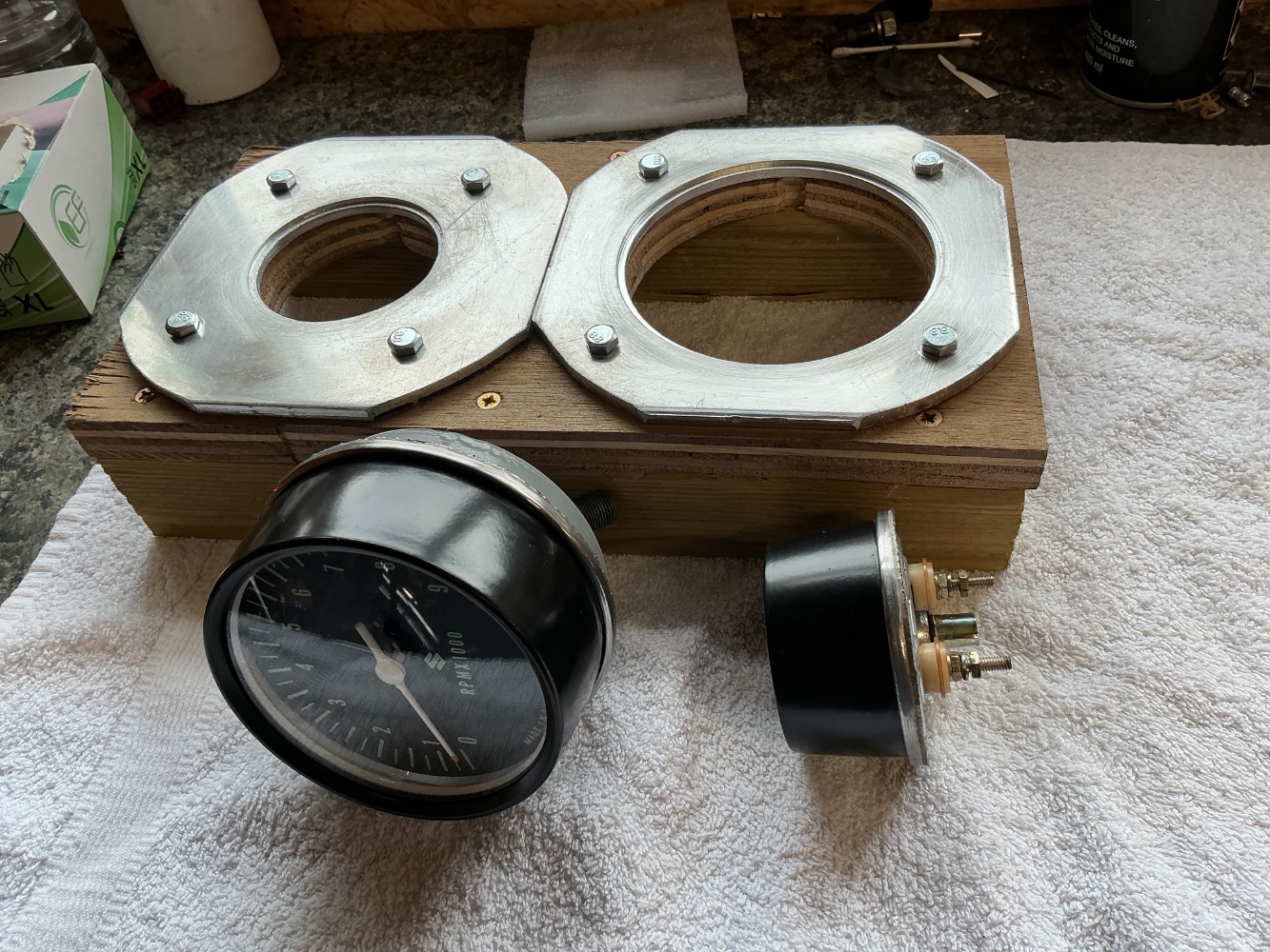

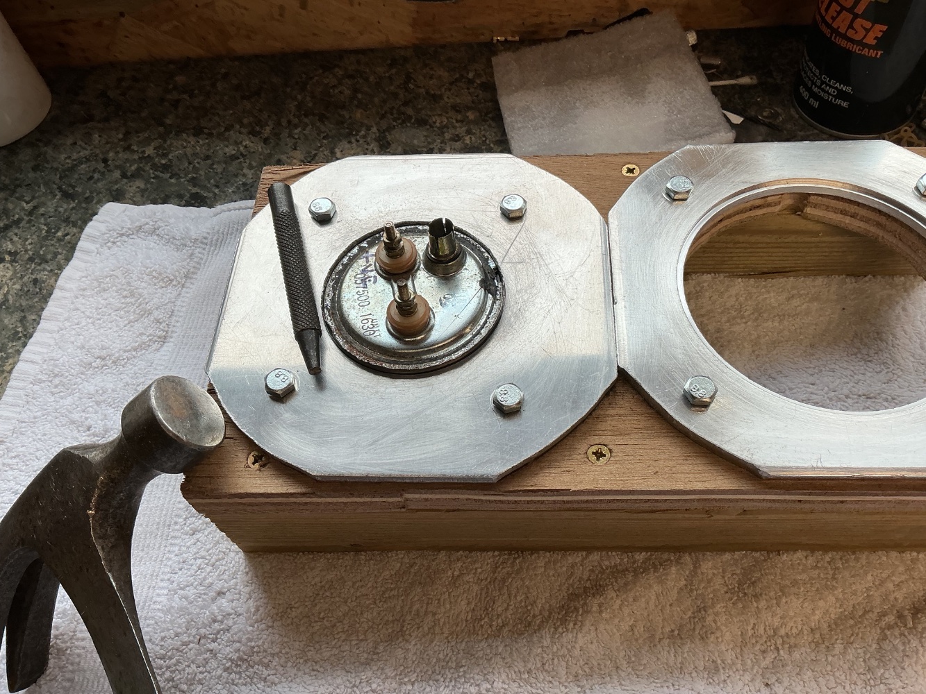

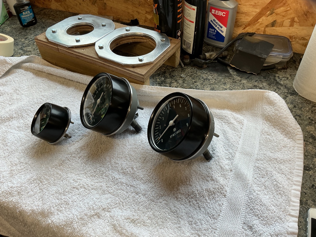

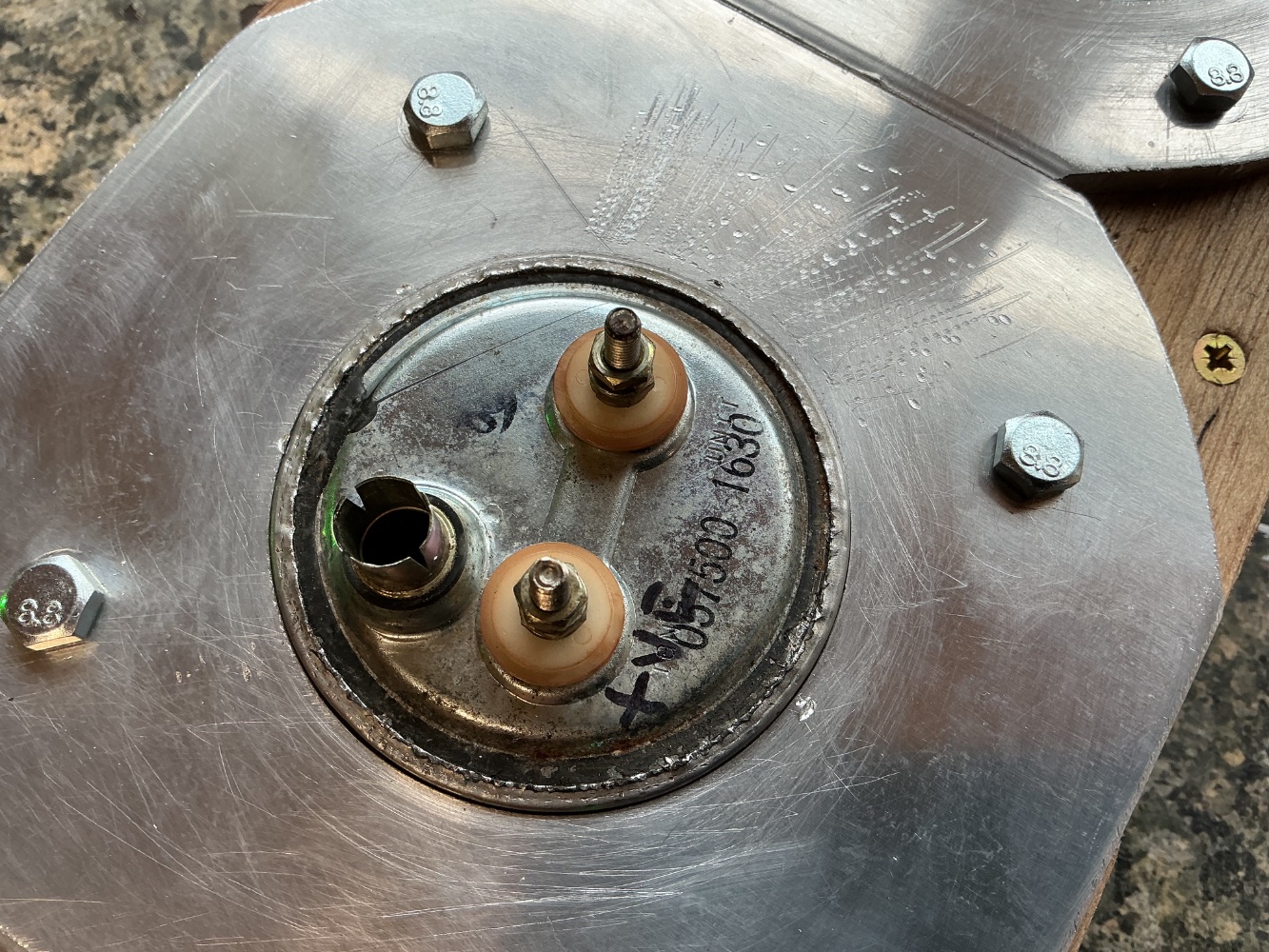

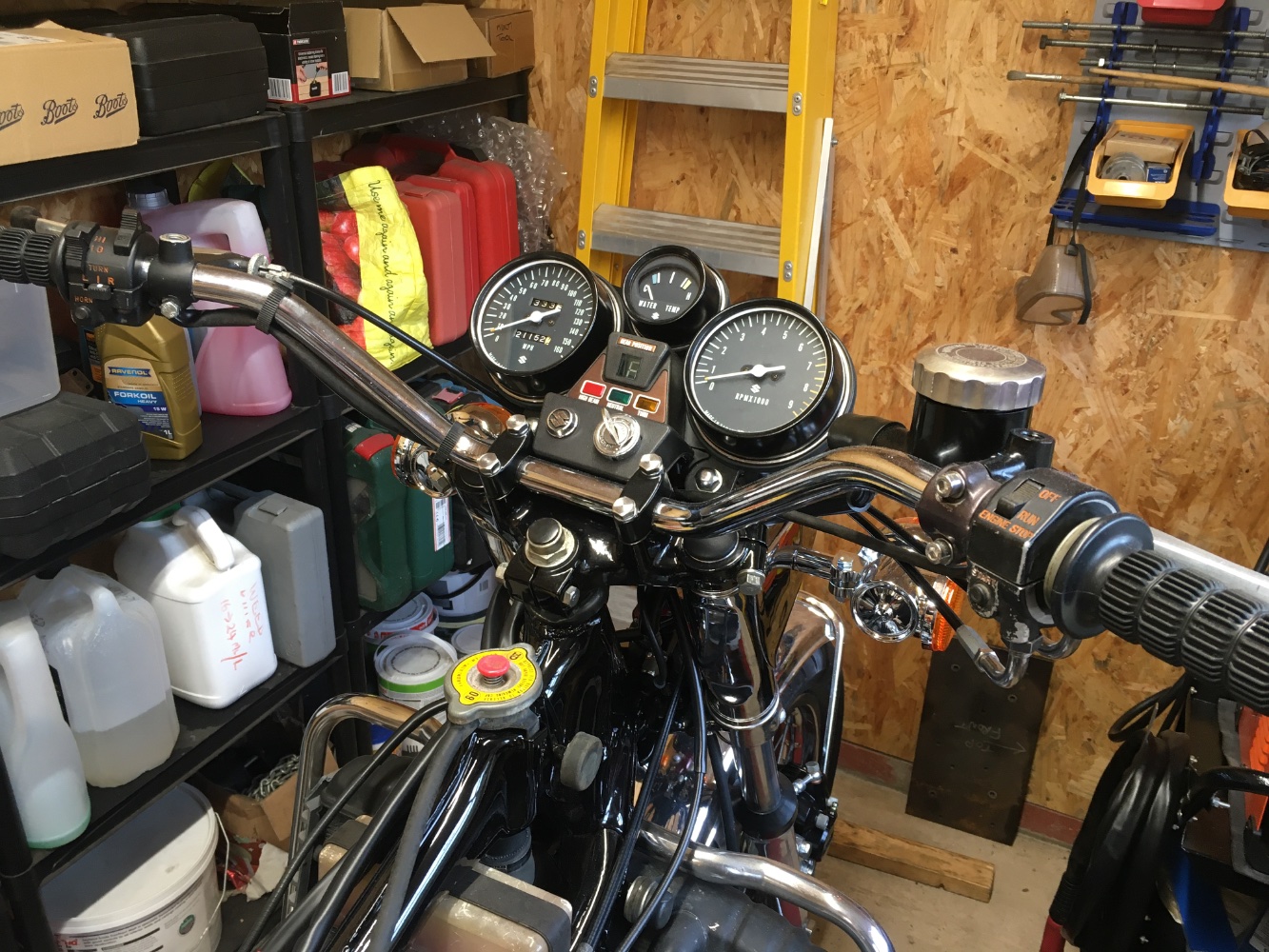

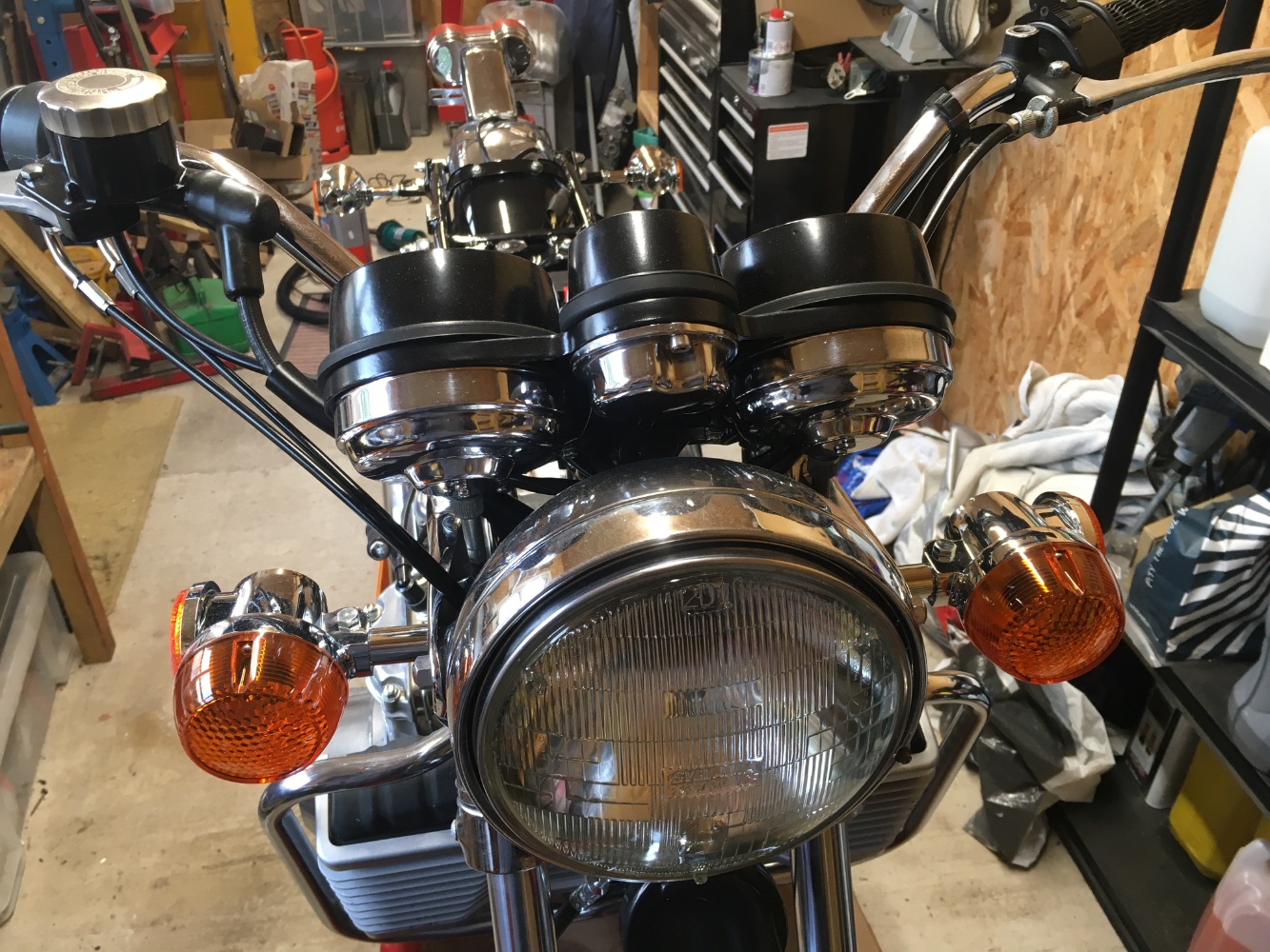

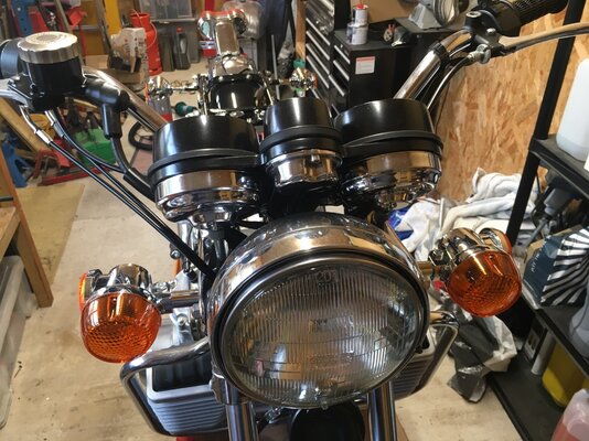

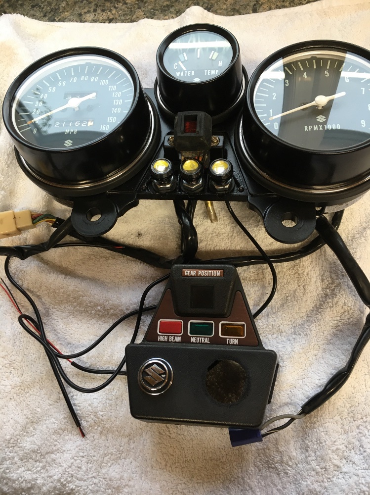

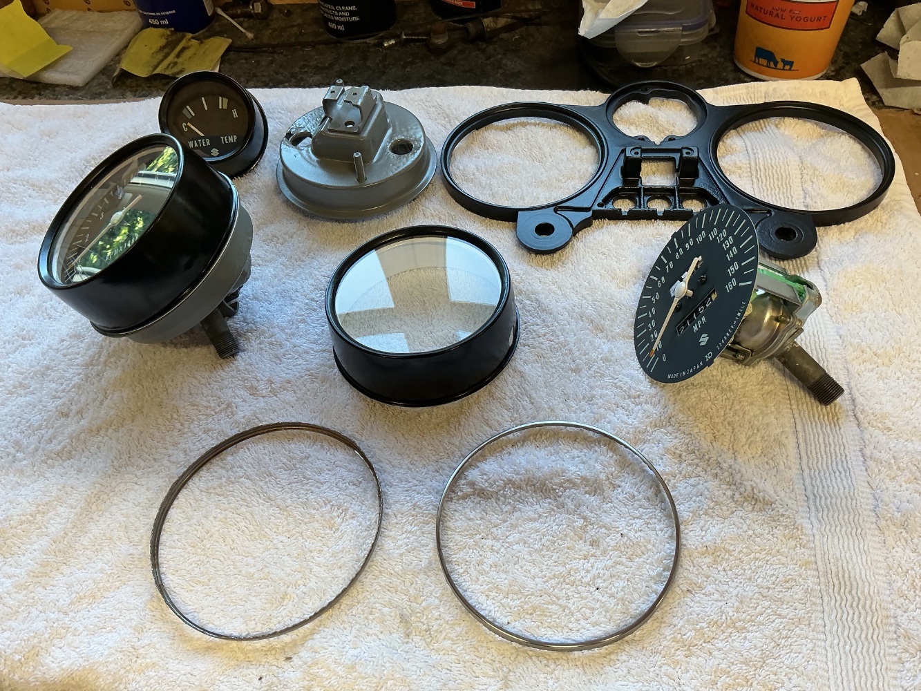

You’re continuing to do a great job! Nice one !Clocks loosely assembled. They’re going to look great. You can see the large stainless bezel rings that hold the cases together.
They need to be put in place and then crimped over the case flanges. A bit of a challenge as i don't want to mark the rings or my new paintwork. I’m thinking about some mdf with a circular hole to sit the flanges on as i bend over the edges of the ring. I’ll post some photos of it in action when I've made it.

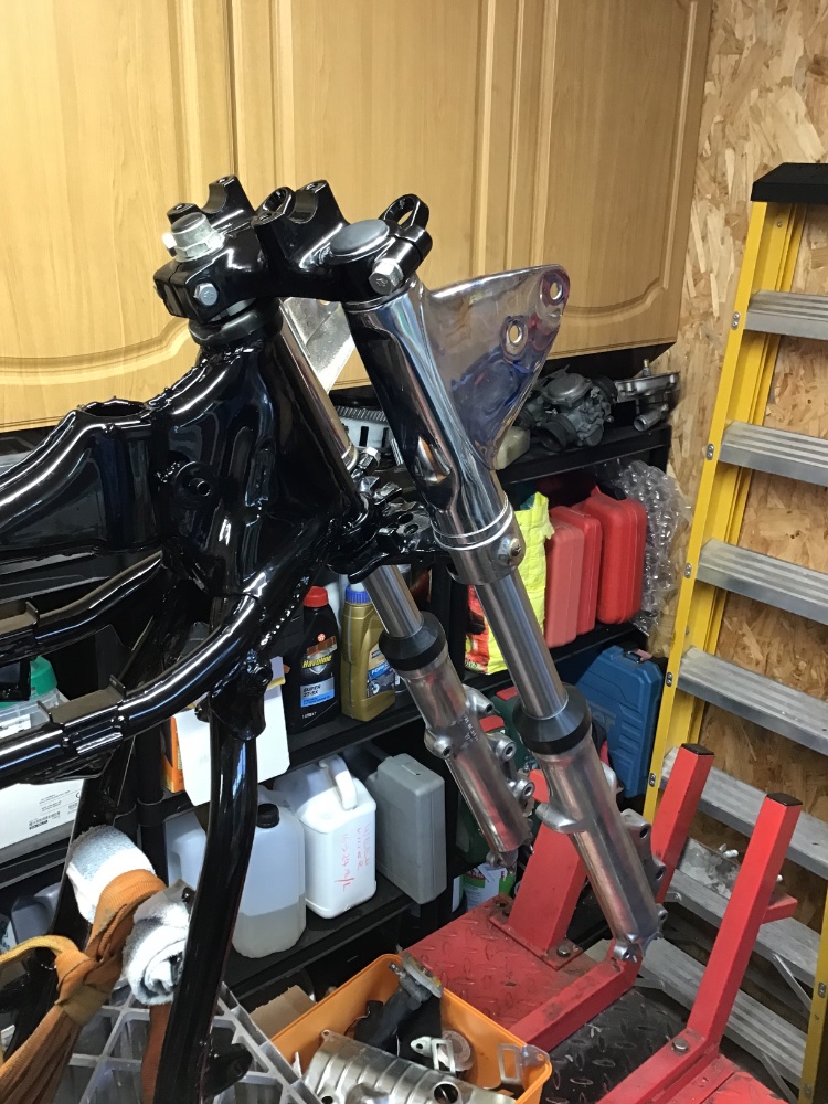

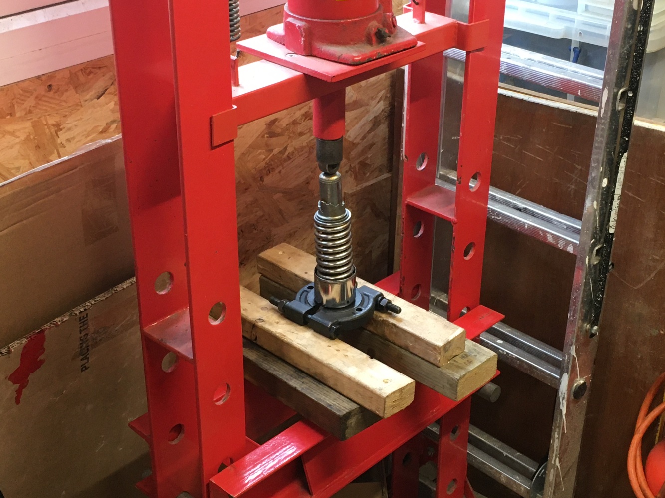

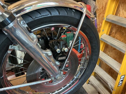

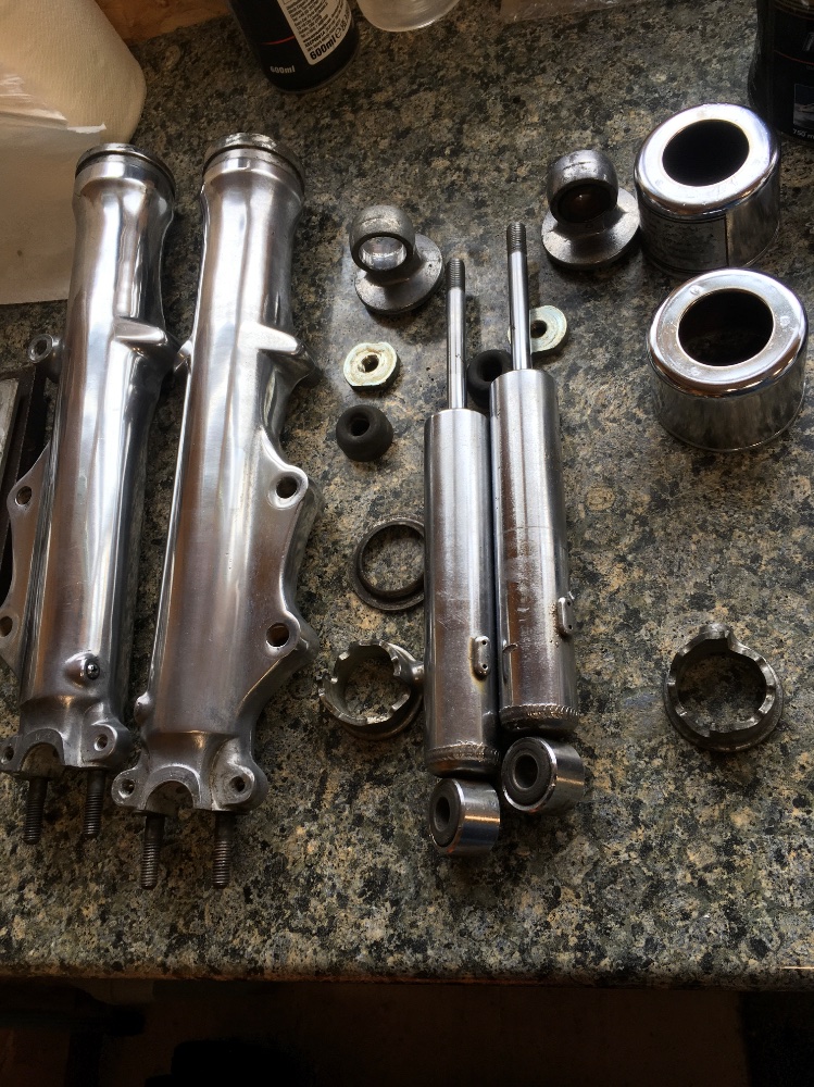

Those rears, are they ikon/konis?I dismantled the forks and installed new stanchions. The rear shocks were dismantled and cleaned up. Surprisingly still some damping left in the shocks but i won't be pushing my luck too much with them.
I used my press to dismantle the shocks using a bearing splitter to hold the spring under compression.
Dismantled shocks on the bench and polished fork sliders. Forks can be seen installed on bike in earlier photo.
Not sure that Chris has been well for some time , but I'm sure that he tried very hard to be.....That's a great job there!, not many would take on splitting a crank.
