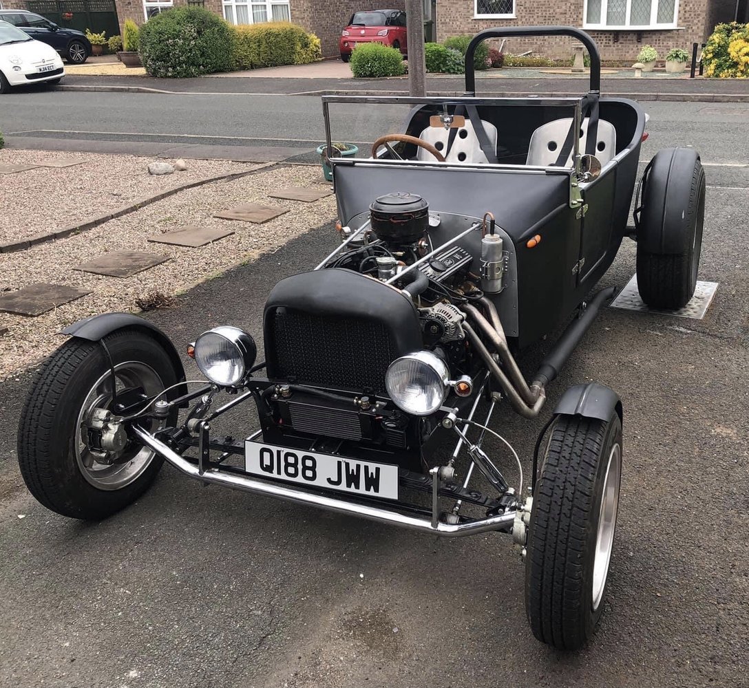

My t bucket had a V6 Essex Ford motor in it, coming into bends, back off the throttle, and the auto-box would downshift, every time. Plenty of engine braking in that thing, but the handling and ride was just too hairy for my liking. I moved it on and started another project.Back in the day I had a 96 Ford Cougar with the 2.5 v6 Duratec petrol lump in it.
