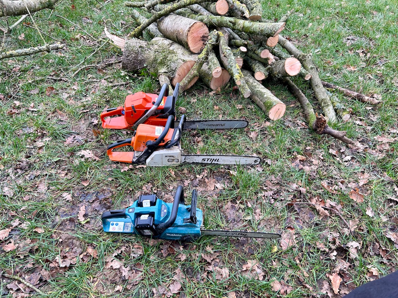

You still need to fill with chain oil which is where the real mess happens! Some saws can be quite leaky when not in use.
What size are you after? Echo CS2511WES is prettty quiet as far as petrol saws go. I rarely bother with ear defenders, whilst I do for most other petrol tools. When another climber works nearby as I need to put defenders on for theres (Stihl MS151), and not mine, even when they are 5-10 meters away.
If its small stuff, upto 6-8", then one of the 18v brushless pruning saws off amazon will do a decent job and standard battery last all day.
Bigger stuff upto 10-12", then an 18v saw will be fine but you'll only get about 7-10x 10" cuts on a 4Ah battery, so not a great amount!
Bigger wood could really use 36v or 56v batteries.
I have a Katsu/Fakita 18v brushless saw. With battery it weighs more than the 2511 petrol saw. They cant get close to petrol for weight.
Toolstaton do their Hawksmore brand brushless tools, I have heard the saws are ok, come with batteries for £120 or 200.
I wouldnt bother with a mains one, the cord would irritate me.
I know the problem, I have to be very careful not to bring fumes into house, shed or garden. All my saws kept in the shed are drained before they are put away and that works adequately.
