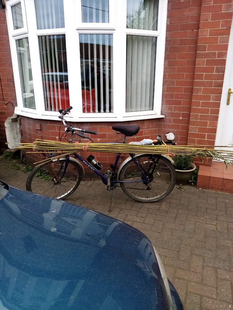

Give it a go mate 24 ribs for the framework about 3/4" diameter 60 weavers. All ours were cut from a local willow bed. we just laid a rope on the ground and eyeballed the shape from there. Find a plank for the seat and set to i got the callico for the skin from empress mills ont tinternet and a tin of bitumen emulsion from wickes its a day long absorbing project oot in the fresh air.I always fancied making one of those.

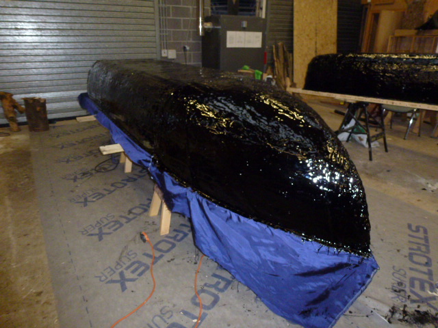

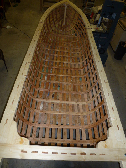

Wow! Those are magnificent an absolute credit to you and your friends the work looks first class. Thanks for posting that..BrilliantOften meant to put a thread in the projects section about them. Here's a few pics.

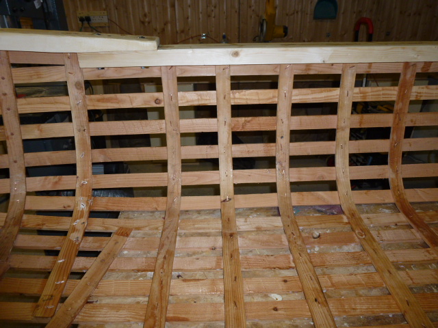

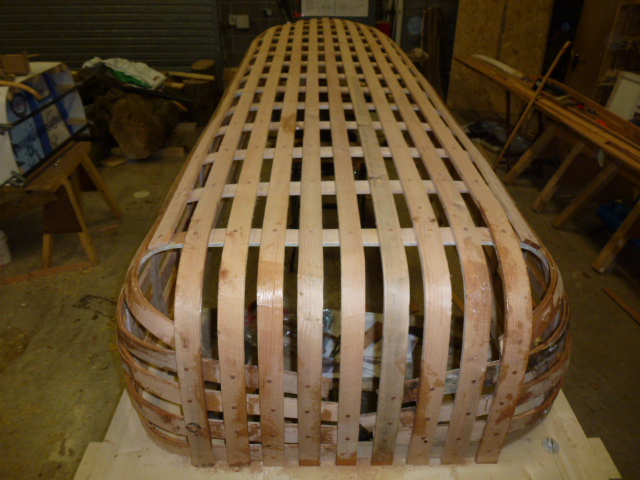

Lattice frame of larch steam bent into shape & tenoned into the softwood gunwhales. The cross points were glued & nailed.

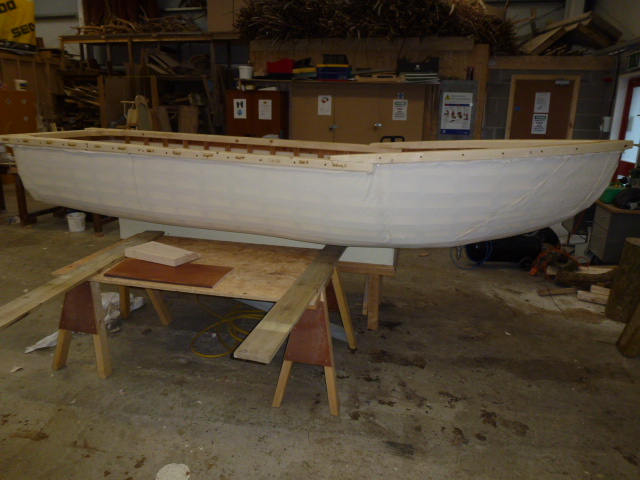

First canvas cover fitted, I think it was glued to the wood with cascamite then the inside was painted with a water based polyurethane varnish to seal it & stop the tar bleeding through.
Second cover of ballistic nylon fitted & tarred.

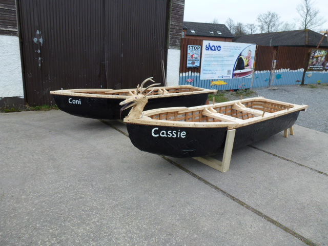

This was launch day, which went very well. They floated very well & were relatively stable. Most of the shed members & many others had a go at rowing them. But due to having no keel they were difficult to keep straight & coupled to inexperienced & mismatched pairs of oarsmen there was a lot of laughter.That was until the photographer went out on his own. His family were all eel fishermen & boy could he handle a boat! In his hands it flew up the water!

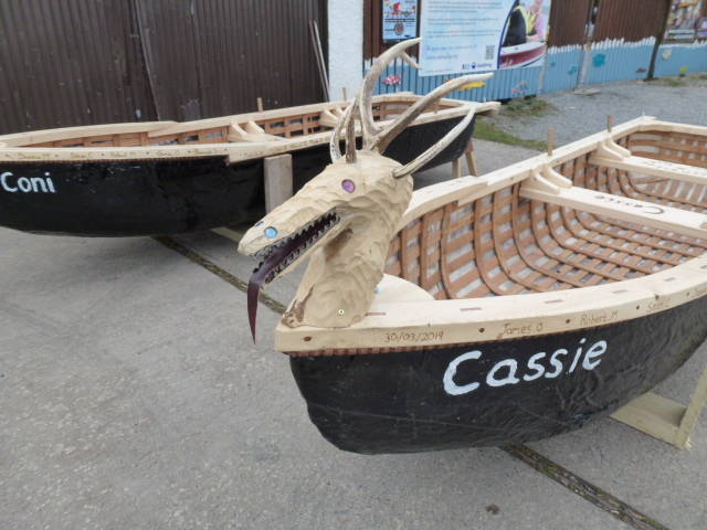

Our tutor Sean carved this figurehead for the boat.
A few months later the boats were on display at an event attended by Prince Charles & Camilla. He was very interested in the boats, particularly the figurehead. One of our shed members, who is a real joker was very nearly asking him if it reminded him of the wife! There is definitely a resemblance!View attachment 296890
