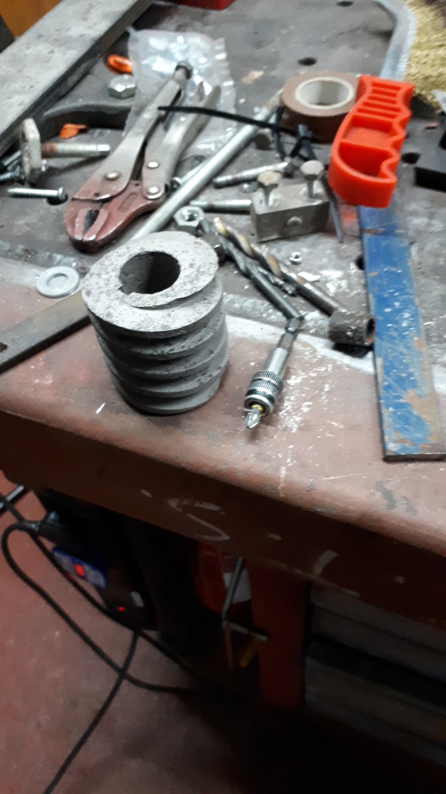

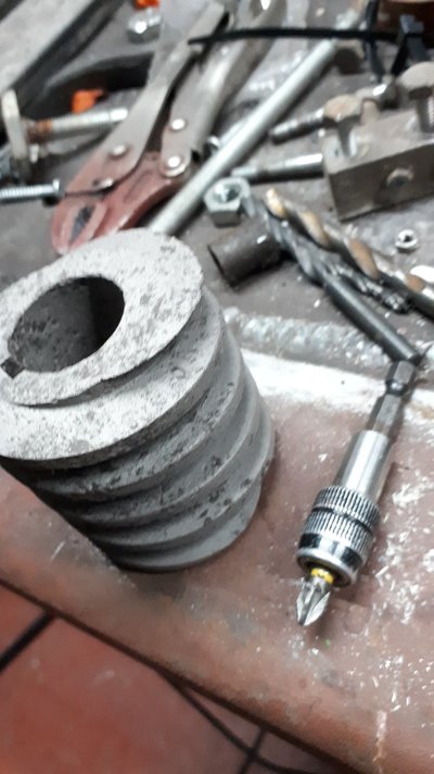

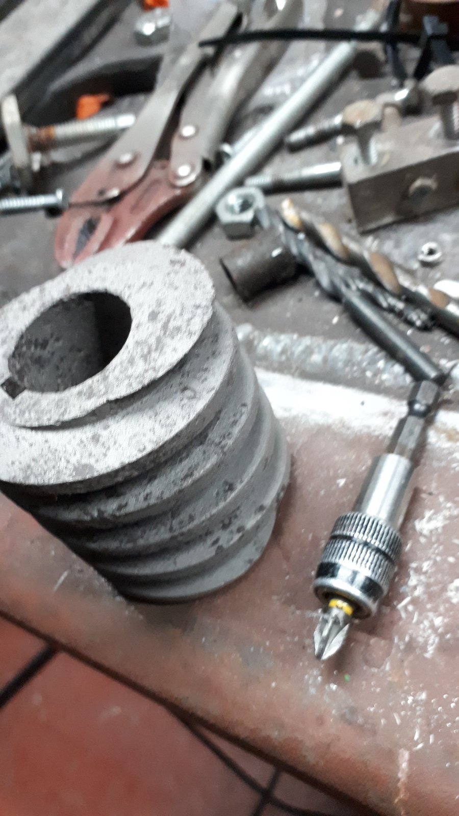

for the duff worm drive the drive/input shaft looks ok, I'm guessing the cog underneath has worn away? - I've had worm drive gearboxes like that on mincers do the same... normally because of a duff bering throwing the drive shaft out of line. mine have all been phosphor bronze, £700 a time to have one made :-o
