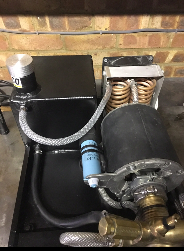

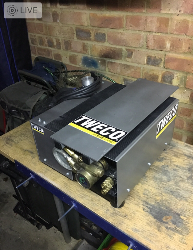

My two cents. A simple way of the cooler stopping after a set run time is to fit a run on timer. The cooler will start when you press the trigger and run on for the set time period which is set on the timer, then stop. This is the simplest way and not much grey matter required to get it done
