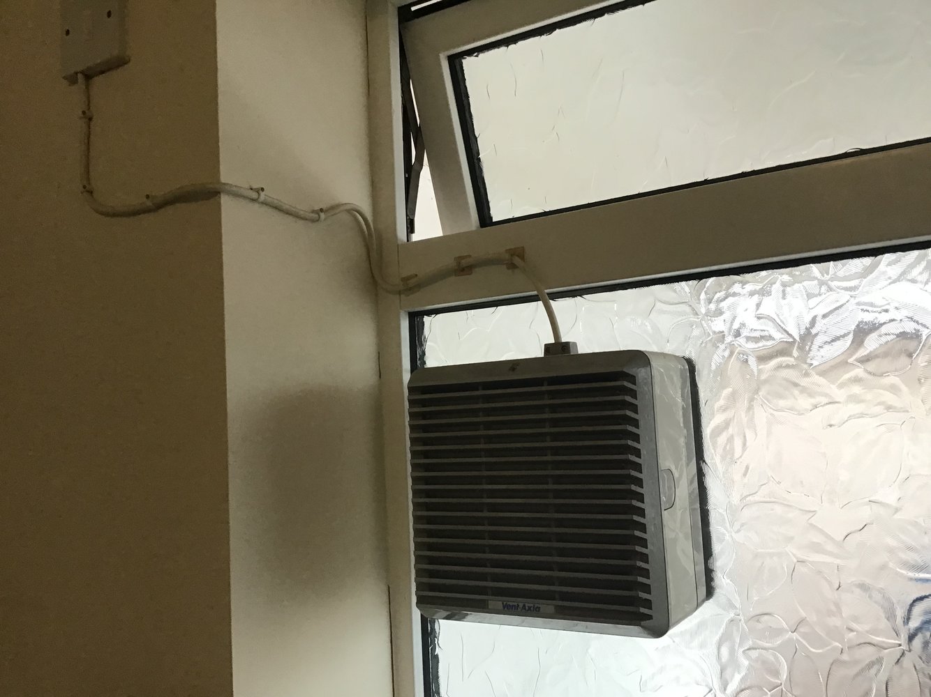

The best is positive input, far more effective than extraction but probably not that easily achieved in your situation.
An easy experiment is to put a fan in the door way and crack open a window. You will be taking drier air from elsewhere and displacing the wet air.
In my tiny ensuite I have heater blower fan, this made a vast improvement as we set it to heat the room, raise walls past the due point.
Then post shower leave it on blow for a couple of minutes with no heat completely resolved our issue
