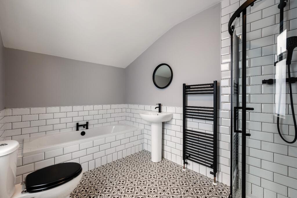

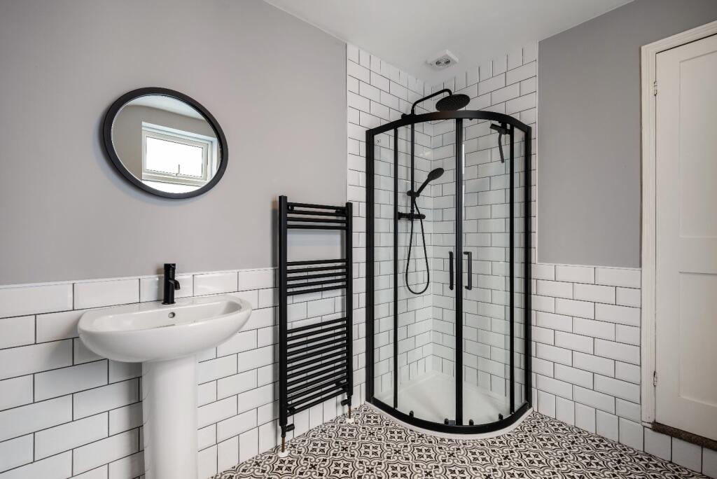

Is it on the ceiling? Might well not be in zone.Fan is also in Zone 1, so i think a standard Manrose fan is not correct anyway?
Can't see any solution past pulling another cable sadly.
How high is the ceiling? If it's over 2.25m it is out of zone 1 and should be fine with the Ip rating of IPX5!
Rules be rules.Yep so out of zone 1
Not by much but it's definitely not in it!
Nicking a switched live out of a light would save a lot of faff. Do fans need an isolator switch?Fan is also in Zone 1, so i think a standard Manrose fan is not correct anyway?
