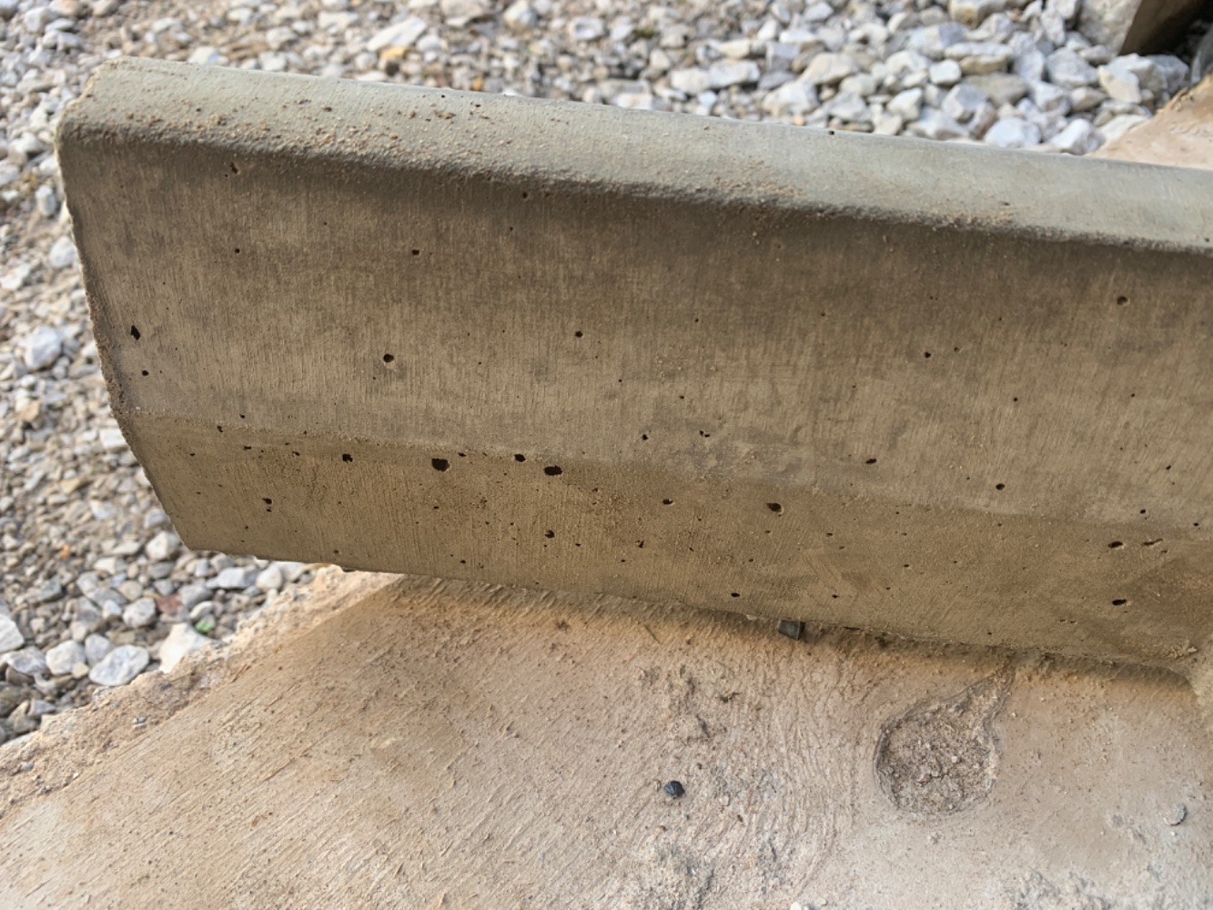

Yes ^^^ have seen this in steel concrete forms, and yes they apply a piece of tape every tine.I've never done it but I've seen people have tiny air holes in the top so they can blow them out with a compressor
I guess when you re-use it you need to stick a bit of tape over the hole so it doesn't fill up

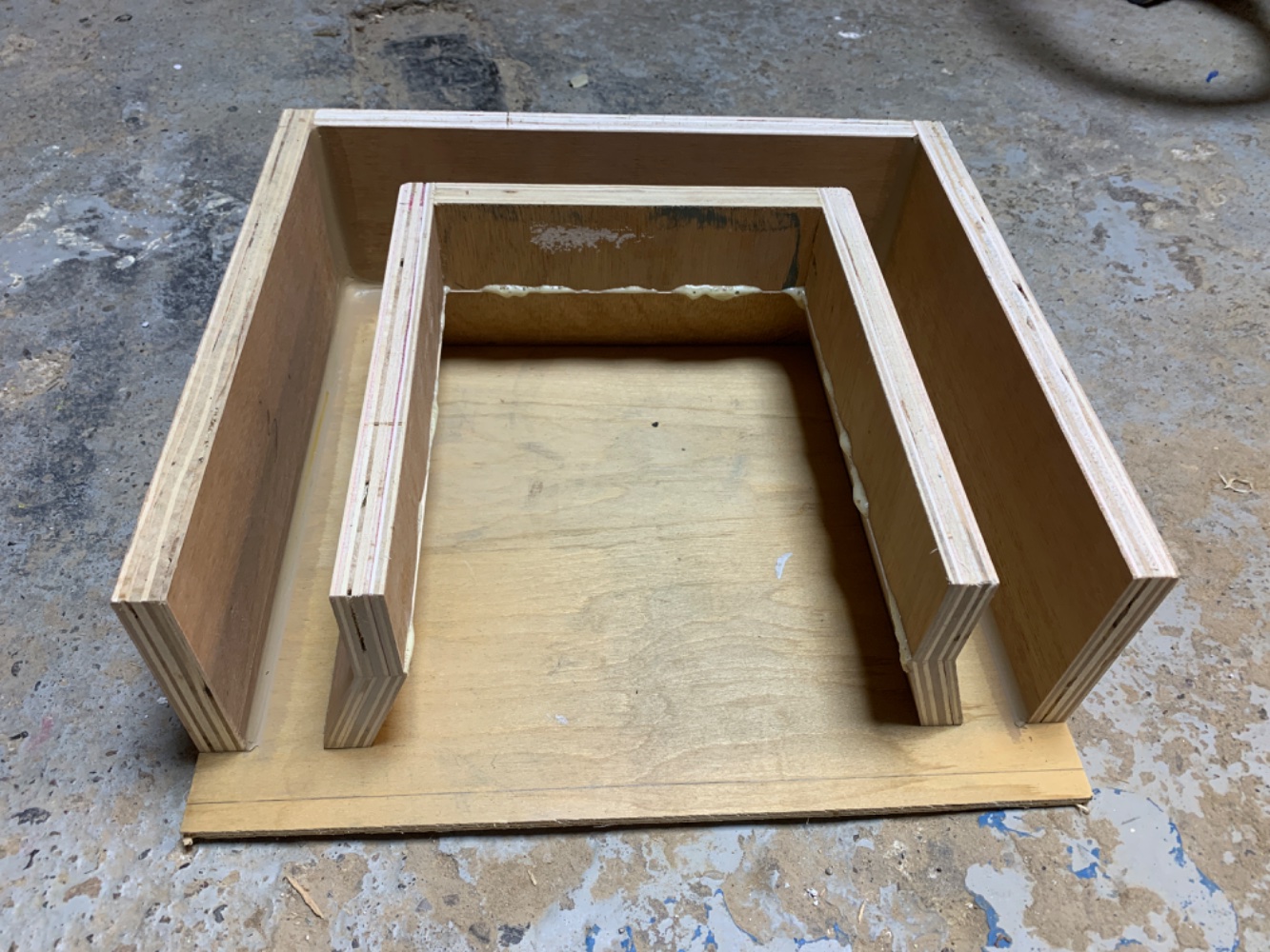

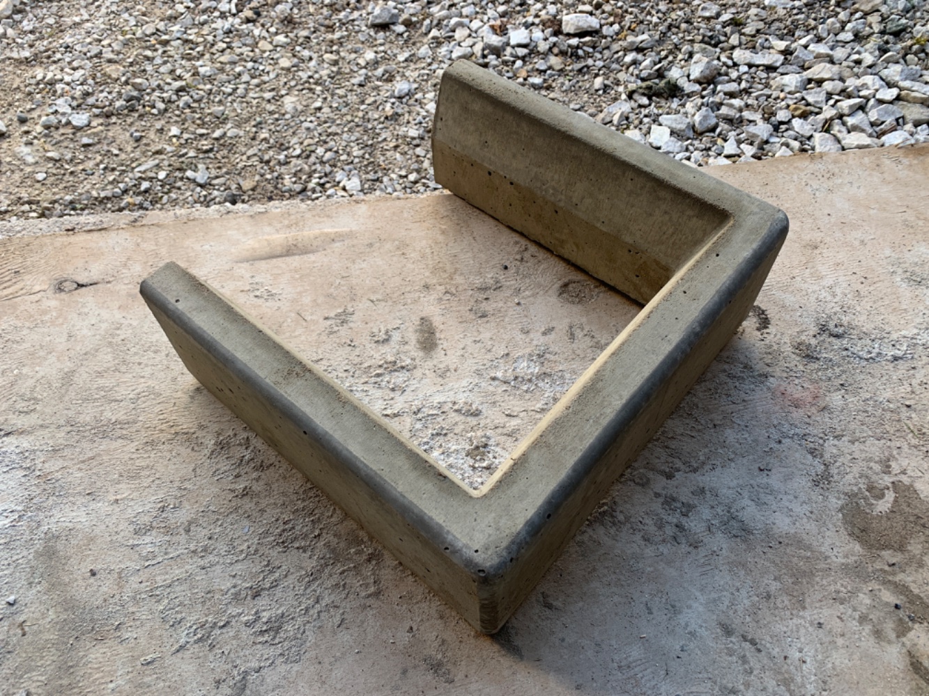

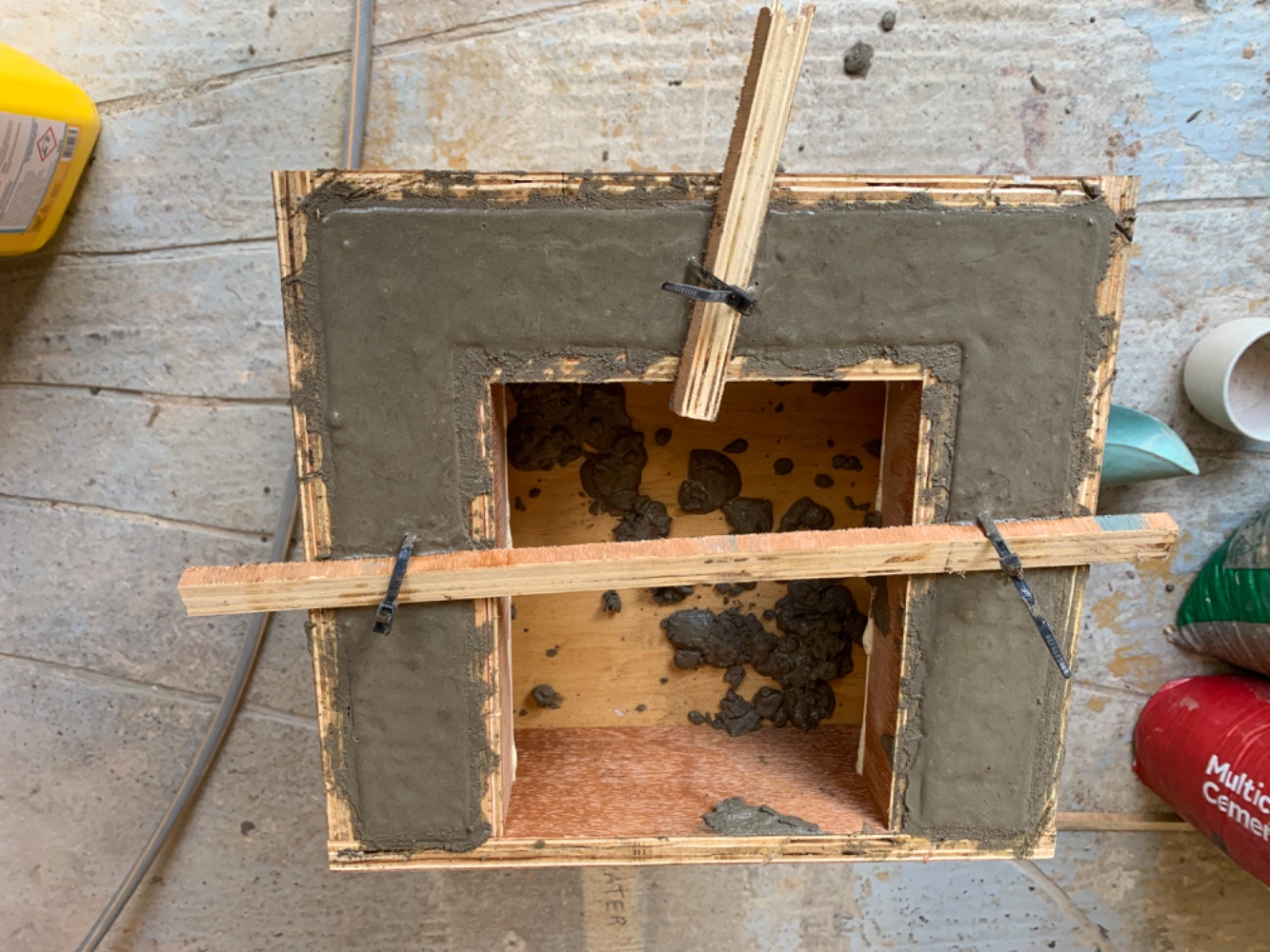

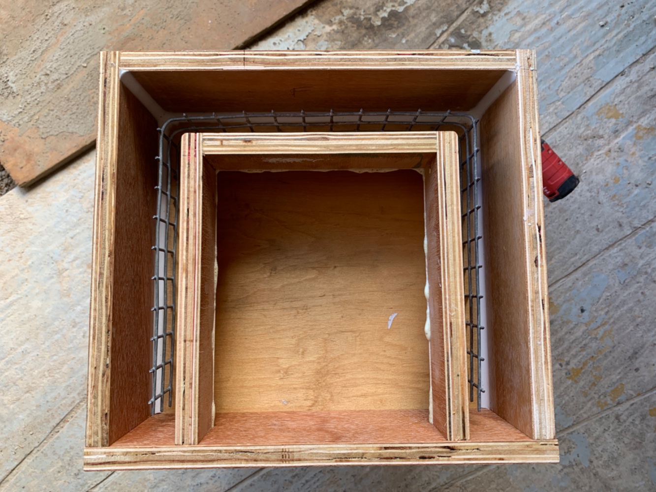

Horrible weekend, Friday my brother in law passed away, I gave CPR while waiting for an ambulance but he’d been gone a while. Had a crack at making a form as I thought it would be a good distraction - I couldn’t focus, every measurement went out of my head, kept cutting wrong. Got there in the end.
A concrete poker!that looks pretty good to me
if you can blunt and old drill bit, or maybe stick something on the end of it, putting it inside the concrete should get rid of the bubbles - something rubber on the end would work if possible :-o
