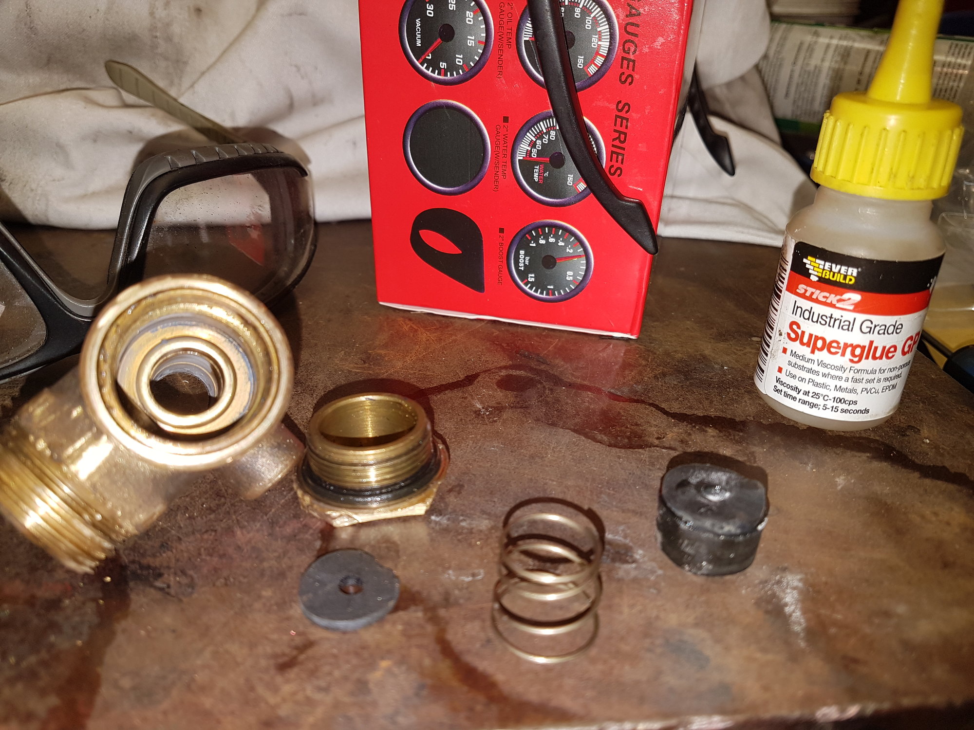

Just ordered a new nrv I tried to fix the old one but it didn't want to play. It looked original to be fair
That rubber bung looks knackered though.
If it can't stagger passed 80psi then it's new motor time especially as the start coil seems to work but the main windings don't take over, not helped by the unloader only working when pressure switch operates.Bloody thing is still messing me about. It must be the motor, it builds up pressure to about 80psi then just stalls it keeps trying to start but doesnt. Do I spring for a new motor or scrap the compressor and get a new one.
