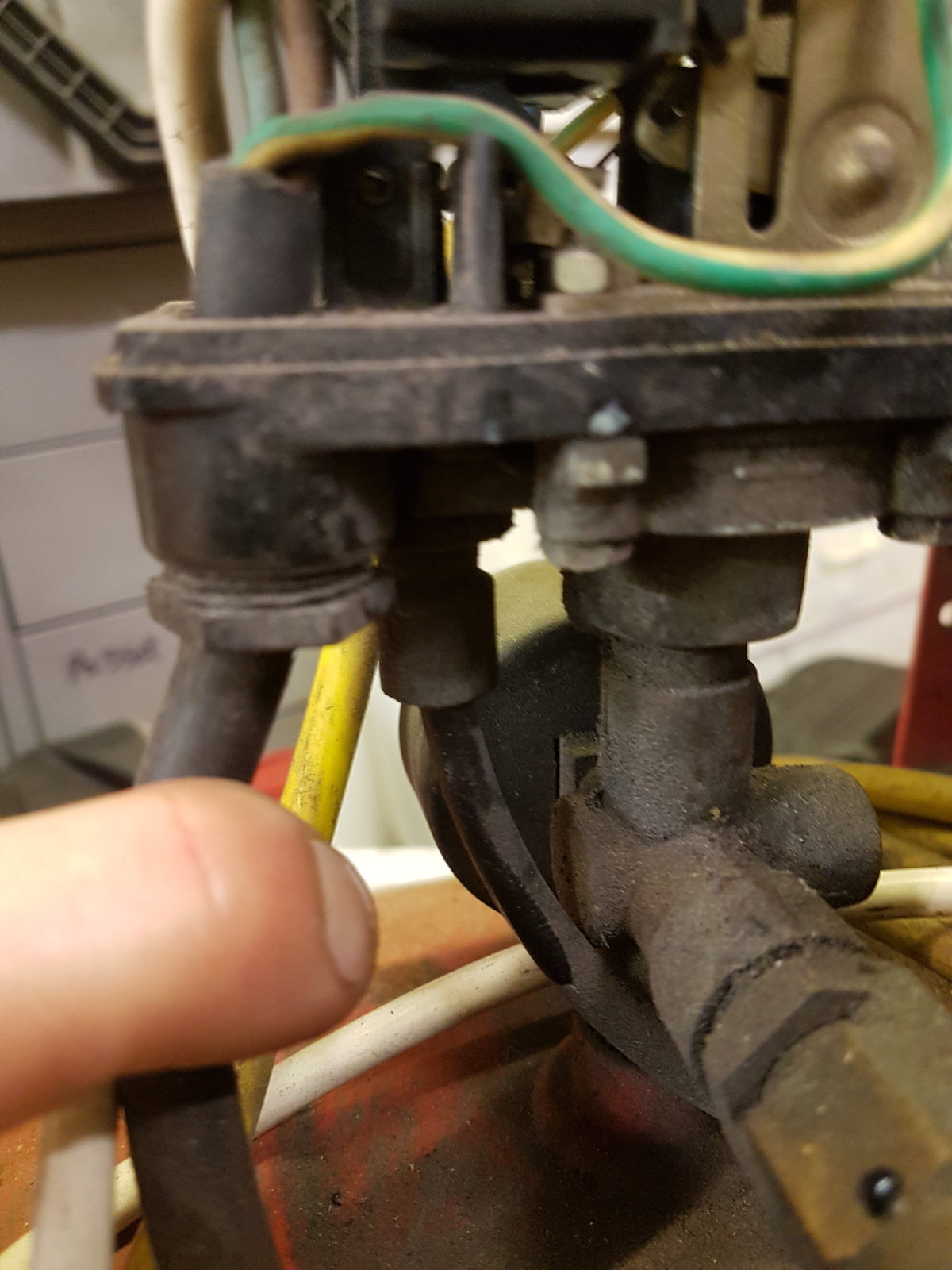

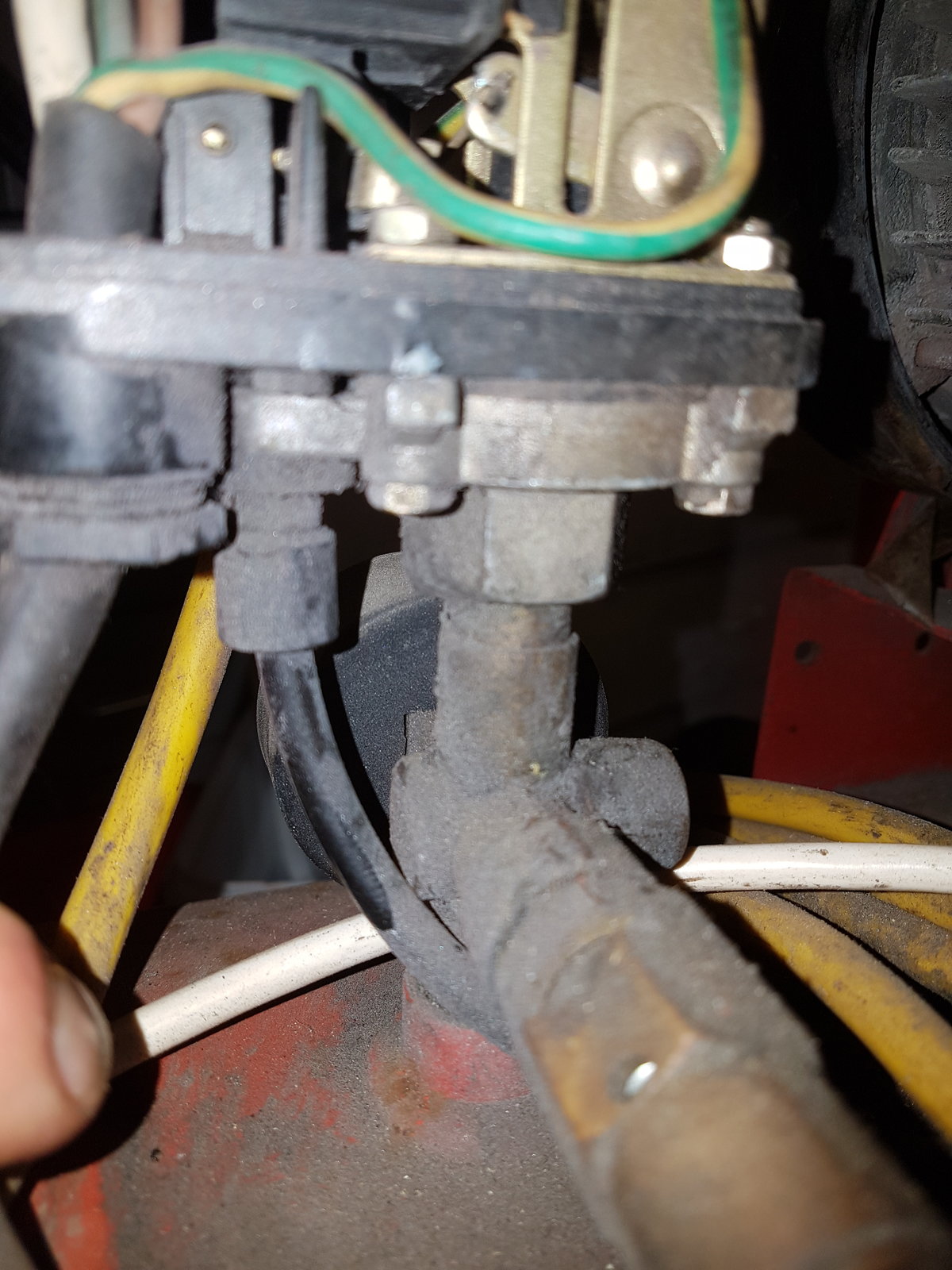

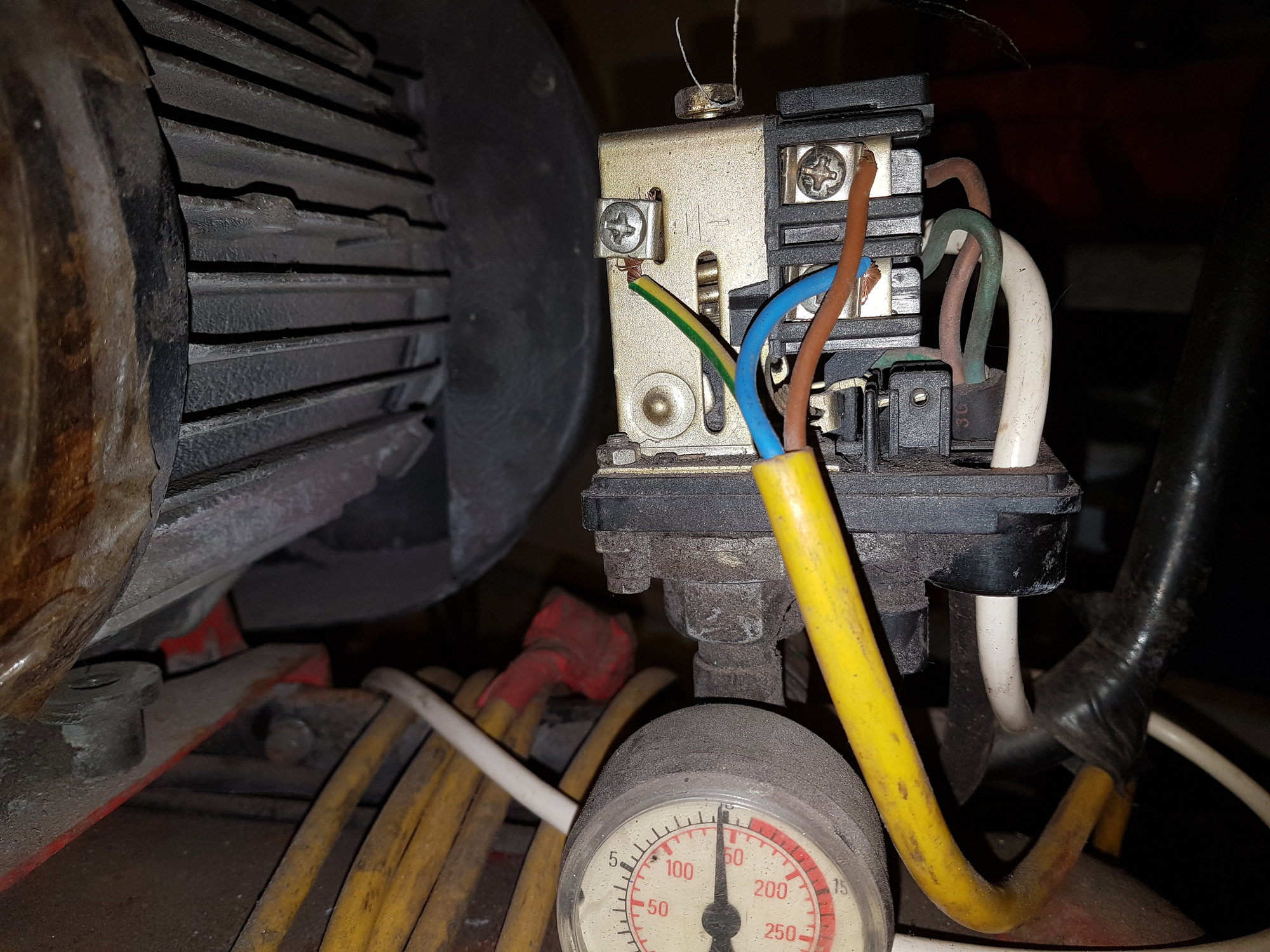

it seems my compressor dont like working too hard!
I was using it for blasting with the pressure pot for the first time today when I noticed the problem.
first it over heated and the thermal cut out needed to be reset
But then it started acting strange the motor would try and start and stop then it would try and spin a few times then stop then try again this kept going on it was quite near being full not far off the 150psi when i found what it was doing.
I let it cool down turned it back on and it was fine but i didnt blast anymore.

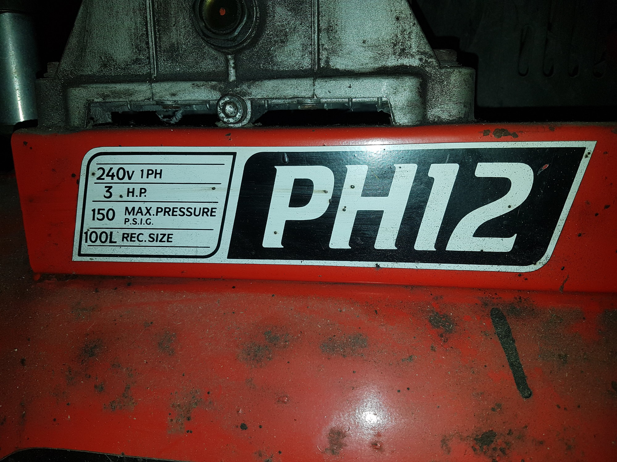

What should I be checking? it is a old snap on compressor 1999
