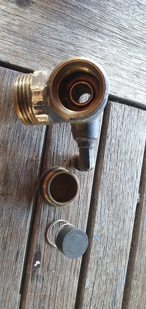

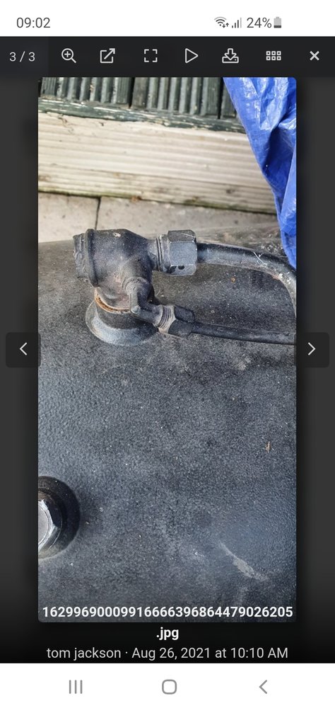

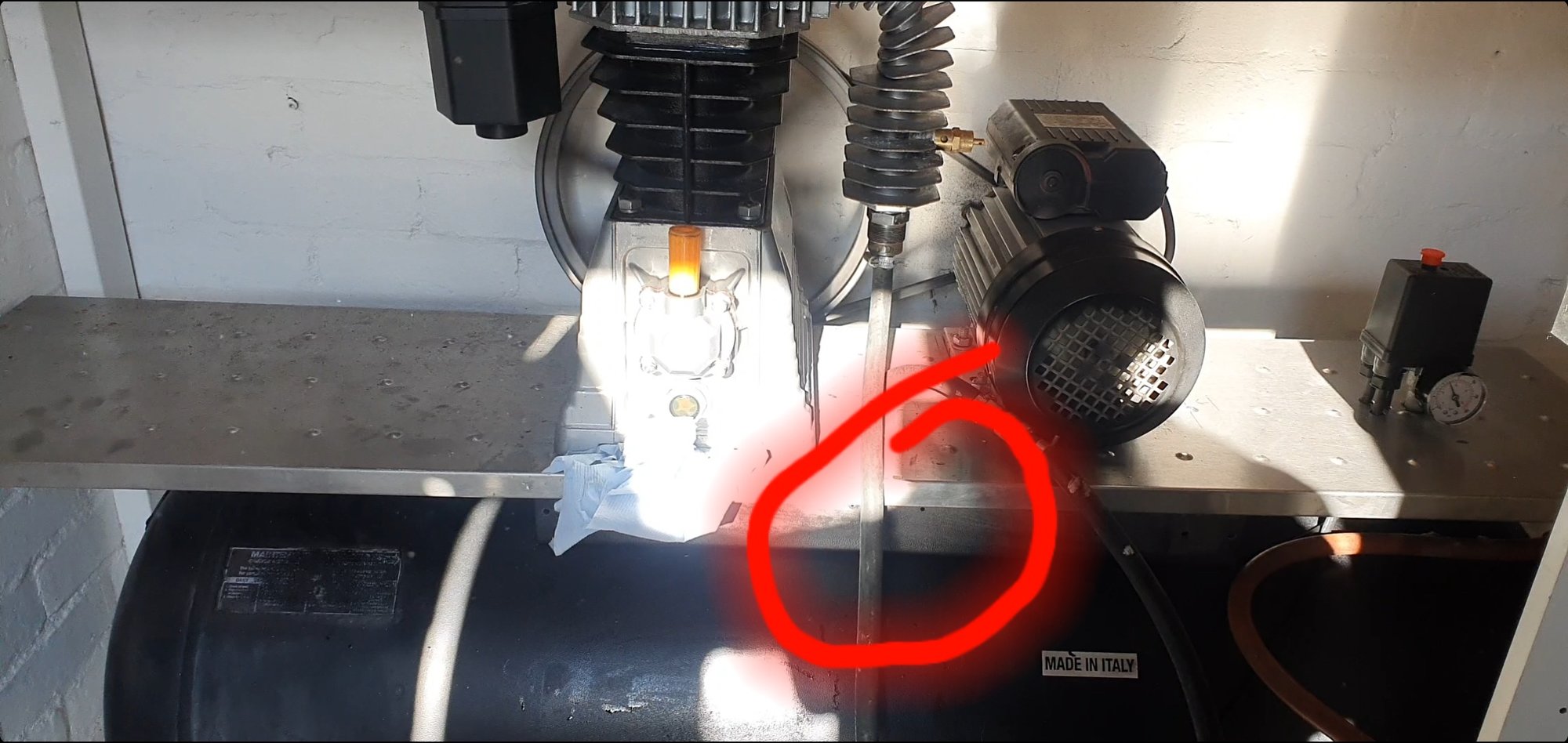

Had the same issue with mine, all the parts looked OK but still leaked under pressure. I got one of theseok ive took it off completely so could take to local compressor shop but they don't sell these and can't get me one, so i took it apart and this is whats inside , all looks clean as well
the one i had was the same and letting air past the rubber seal as it was slightly worn like yours . i just rubbed it flat on a bit of emery cloth and it stopped leaking past itok ive took it off completely so could take to local compressor shop but they don't sell these and can't get me one, so i took it apart and this is whats inside , all looks clean as well

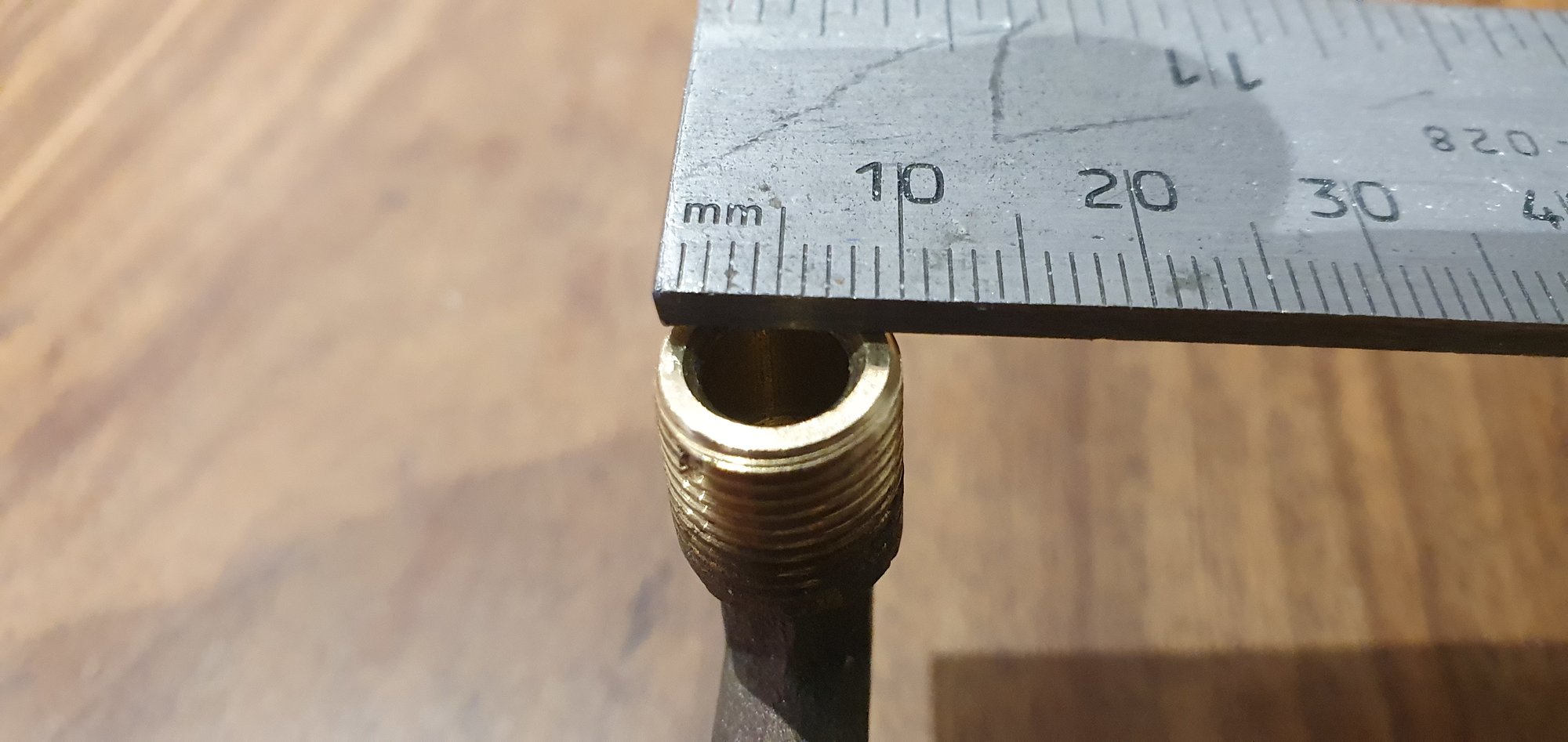

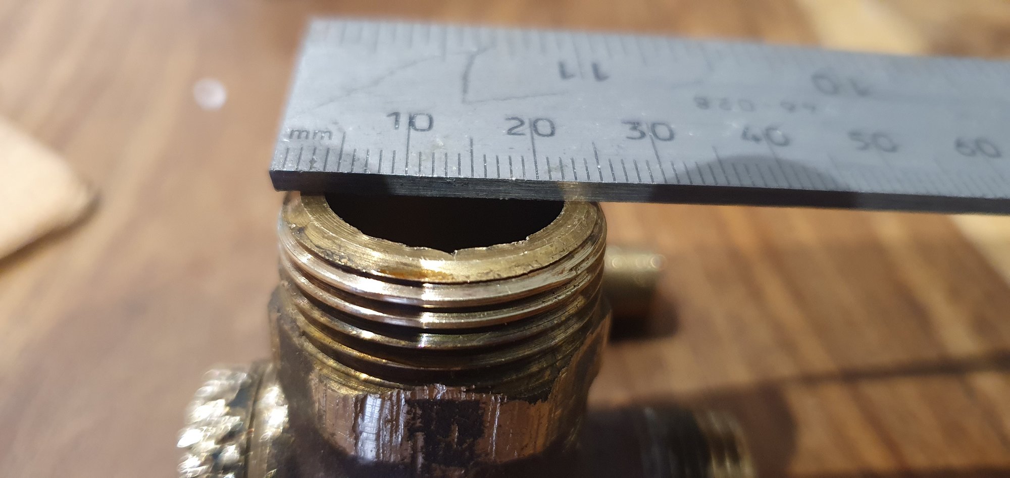

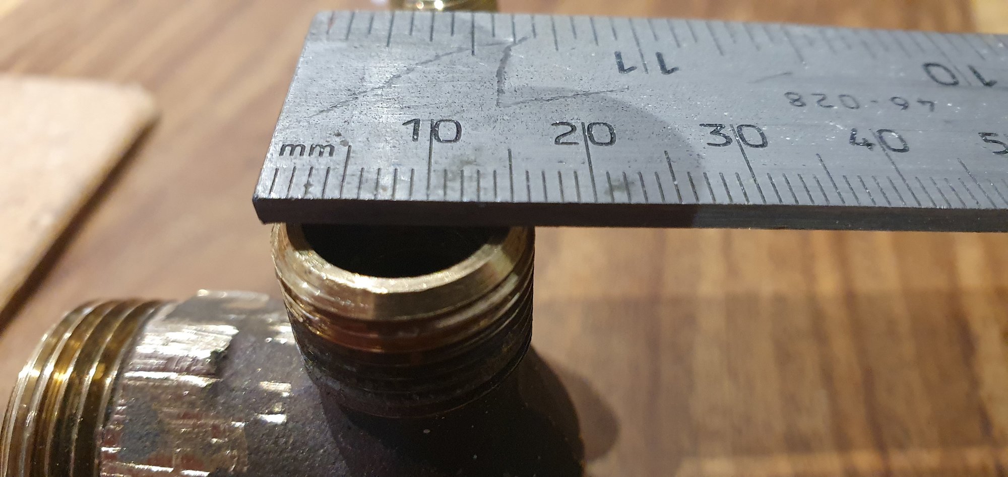

which i think is a tad expensive, so now looking for a way round maybe fitting a smaller size can i reduce the 1" so can fit one off the standard size valves like was suggested a few msgs back
