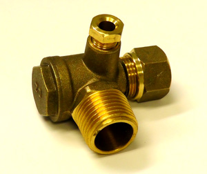

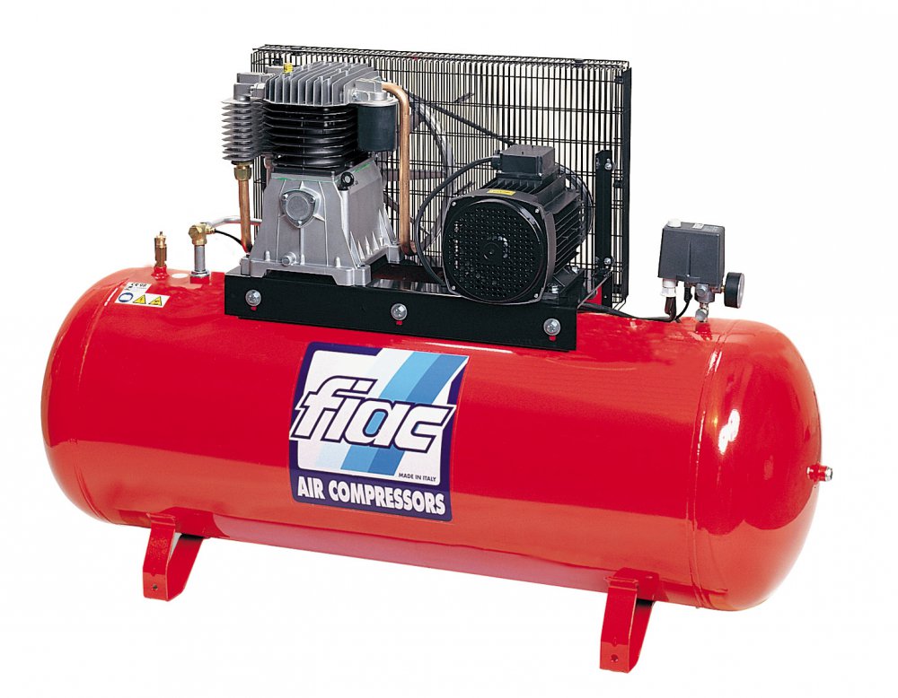

anything like thisits a FIAC compressor, has a clark 3hp motor, no idea if the pump is original so the make is a difficult one really, bit of a mongrel
you've got it and the only reason air isn't gushing from your pump is that there are a further 2 valves in the head of the pump usually reed valves one inlet and one out let, once you fit the new valve you should be good to gomakes sense now, so as the nrv wasn't fitted the pipe was pressured back to the pump hence why its leaking from the dipstick tube, the unloader valve wasn't even connected as the thin pipe was just laying onto of the receiver, it will be reconnected though once the NRV is back on

I Know what it does and where it is connected,here you go norm, this pic clearly shows the delivery pipe and un loader connection to be one and the same port
It is open to atmosphereIf there is no non return valve, I don't understand why air isnt gushing from the unloader valve as its fully open when the compressor reaches full pressure
on a lot of compressors the un loader line is connected directly to the delivery pipe so if you remove the non return valve it would empty the receiver through the un loader valve, I know you say it cant if its not there which is obvious but we were trying to work out what was and wasn't connectedI Know what it does and where it is connected,
but if it not there it cant leak !! neither would the line from the pressure switch because there is NO feed from the switch the unloader line goes TO the pressure switch and is relieved by the pressure switch.
