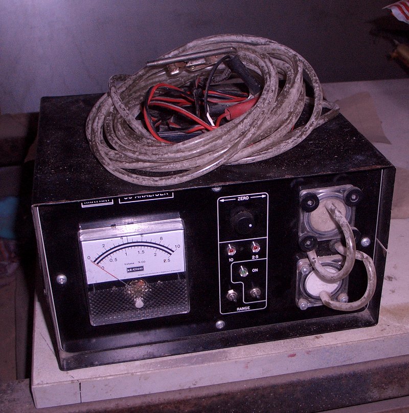

just lift the piston a tad, engine speed should rise a bit then fall if the mixture is correct, I use a 12v CO machine..........Stromberg 175 on a Volvo B20
