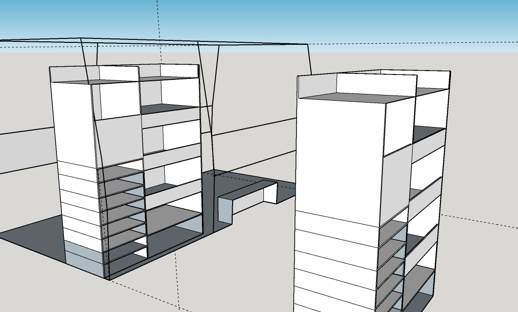

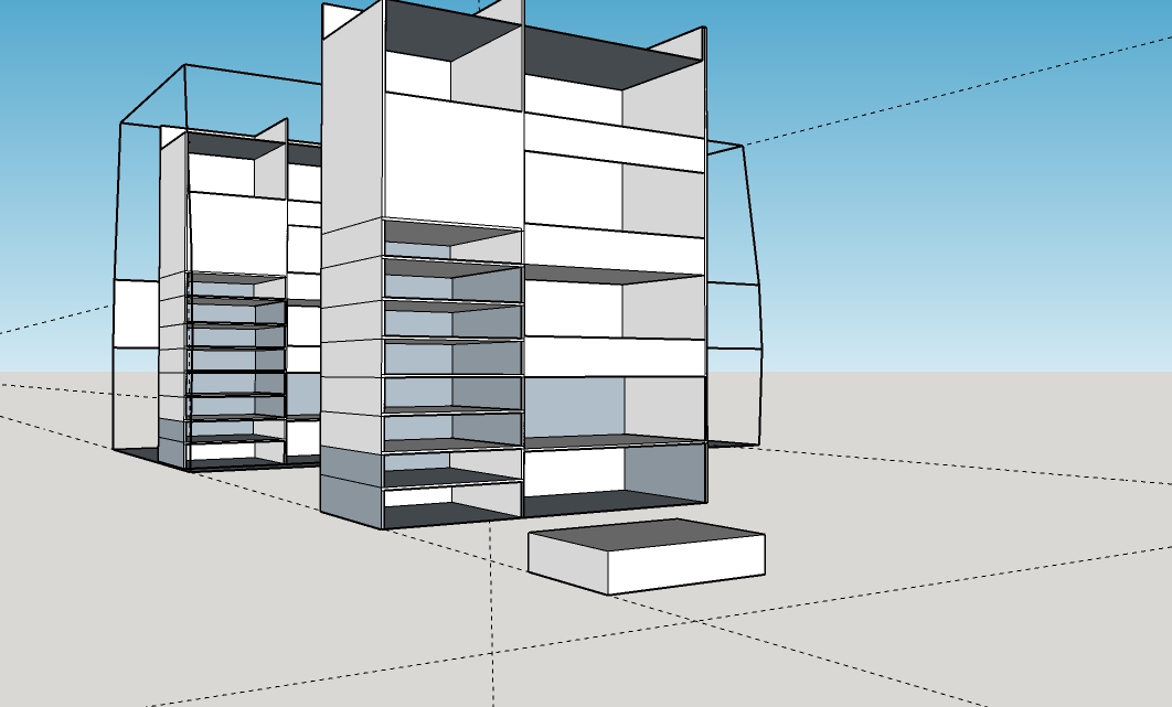

    conveniently i found camper drawings to the correct dimensions in sketchup warehouse. saves me a job.
    lhs 9 slots for screw organizers. big section for dustsheets.
    rhs 2 big drawers and shelves. access fro side door only. shelf on top from inside to keep door runner clear.
    iveco side unit in place.jpg iveco side door unit and sortimiser.jpg iveco barn door inwards.jpg
    I was debating lifting the floor but don't think il bother. Plenty of room above racking to store levels/rails etc. Saves a lot of work and keeps the step in low as it's a rwd
    Will put a hatch under the bulkhead. Should be able to get a few lengths of 5.1 through under the front seats if needed.

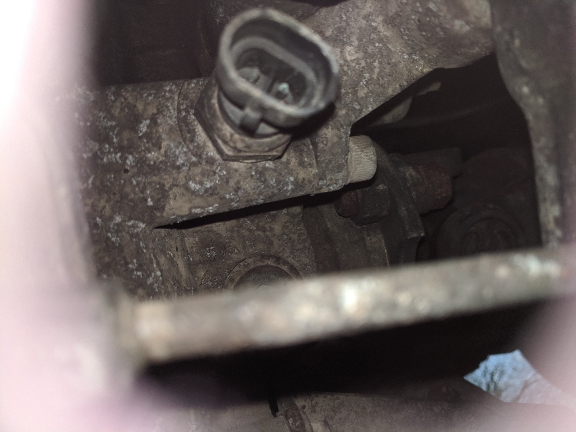

    Dragged myself across the wet drive with the torch and multimeter. (Checked the fuse first :) )
    Can't see any wires heading into the box.
    Can move the linkages by hand so i know I'm in the right spot.
    Then I see it.
    Spot the problem.
  11. eLuSiVeMiTe
    eLuSiVeMiTe Forum Supporter
    Messages:
    9,667
    Location:
    Bedfordshire England
    No wires.
    Cast around inside the chassis and find a rogue plug. Unwind it and sure enough it reaches and fits.
    Pop the cover and getting 12v from the probes.
    Quick clean both sides plug it in and I have reversing lights.

  12. zx9
    zx9 Member
    Messages:
    3,550
    Location:
    South East London
    It is wireless, must be the high specification model. :)

    Pins on the socket cleaned up ok. The plug was ,18 inches away from it unfortunately.
    Someone forgot to reconnect it.
