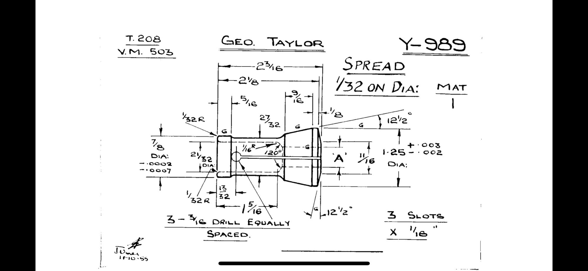

Drawing coming up ....View attachment 307989
whilst I’m certain sorting the spindle would be an easy job for some, it’s beyond my back yard bodging abilities !

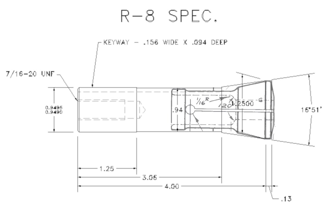

That will machine to R8 size directly, so long as there's enough meat behind the taper. What is the drawbar thread?
