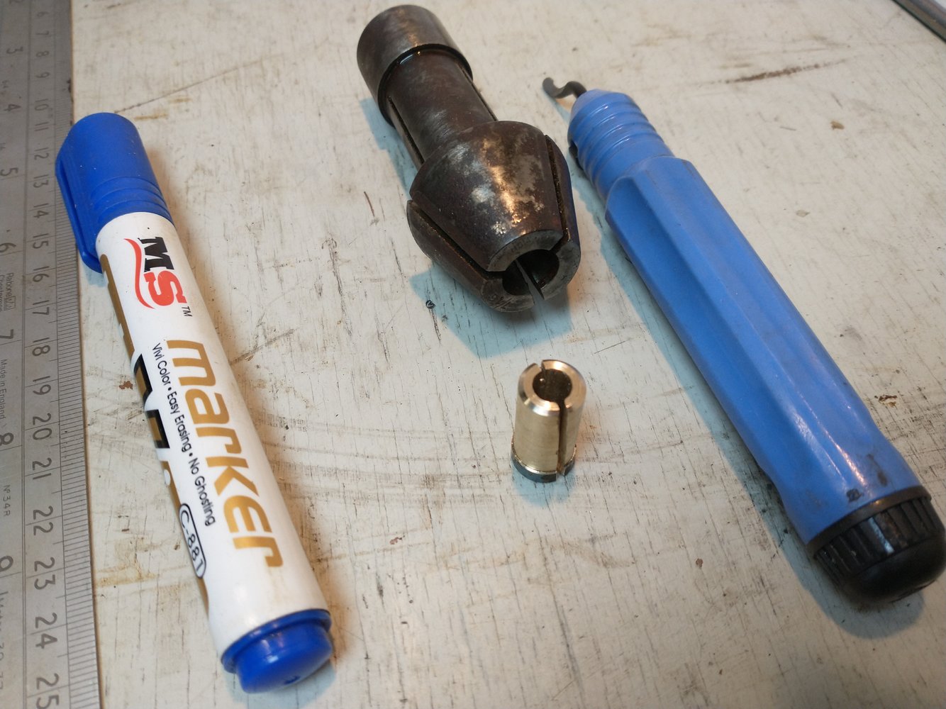

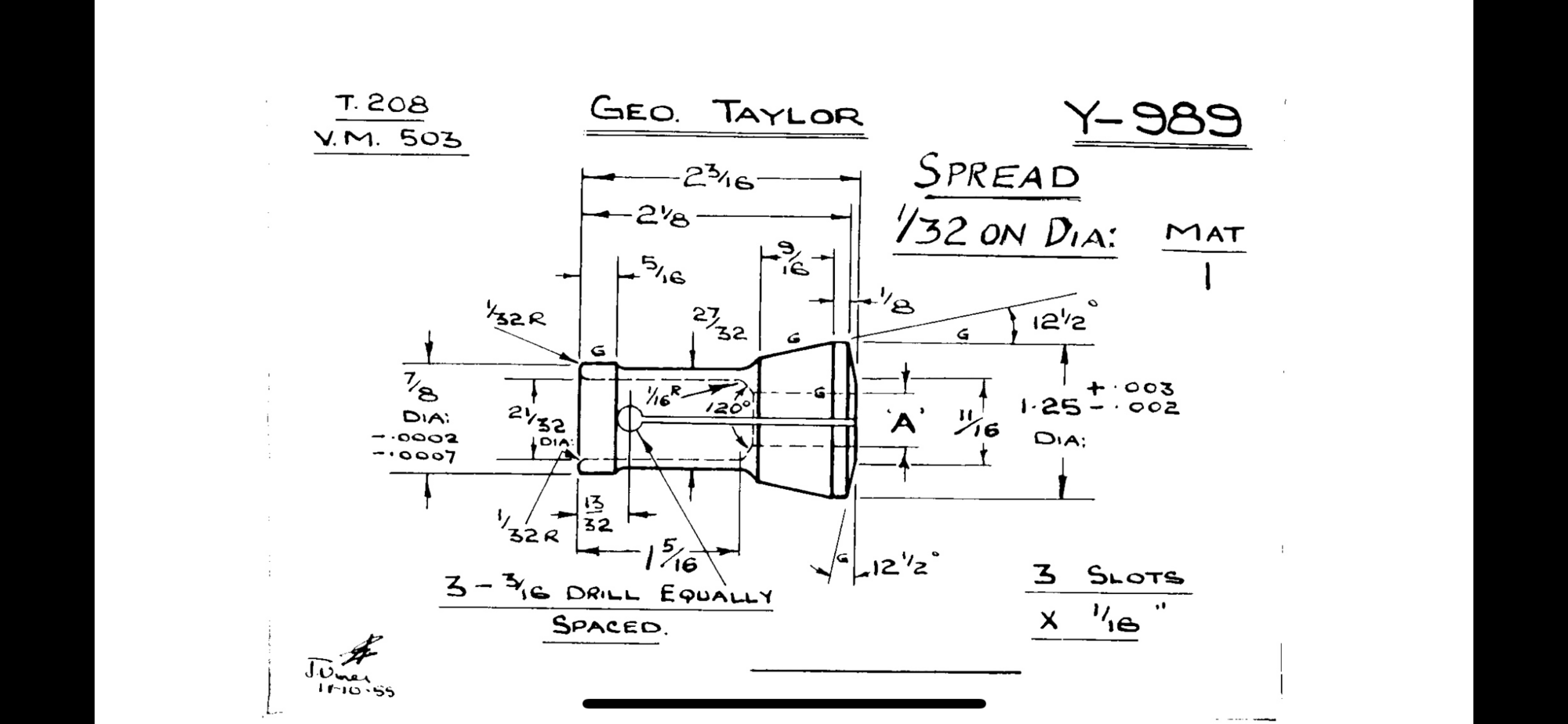

Ok, so I’ve found someone who can make the Taylor collets, but at 100 quid a pop I’ll be getting them one at a time. That said, what would be the most useful sizes to go for first? 6mm? 1/4”?
I did look into getting a 16mm made and running a straight shank er20 collet holder in it, but I think I’ll lose too much depth and rigidity on the machine, and it seems a shame to ruin it for being cheap!
