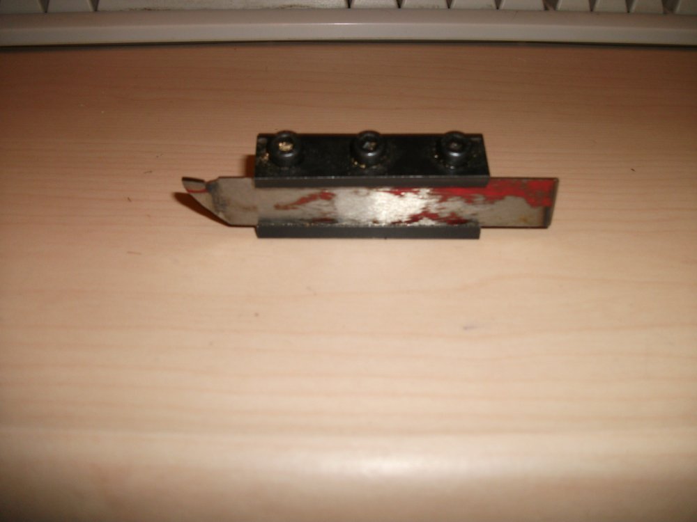

Mine has lots of teeth to the inch whats the benefits of finer blade and how course a blade can you use to cut steel??You can get the HSS blades re sharpened over and over until they are too small to be useful, then you can cut them up to make all manner of things like lathe tools etc.
like here a parting toolYou can get the HSS blades re sharpened over and over until they are too small to be useful, then you can cut them up to make all manner of things like lathe tools etc.

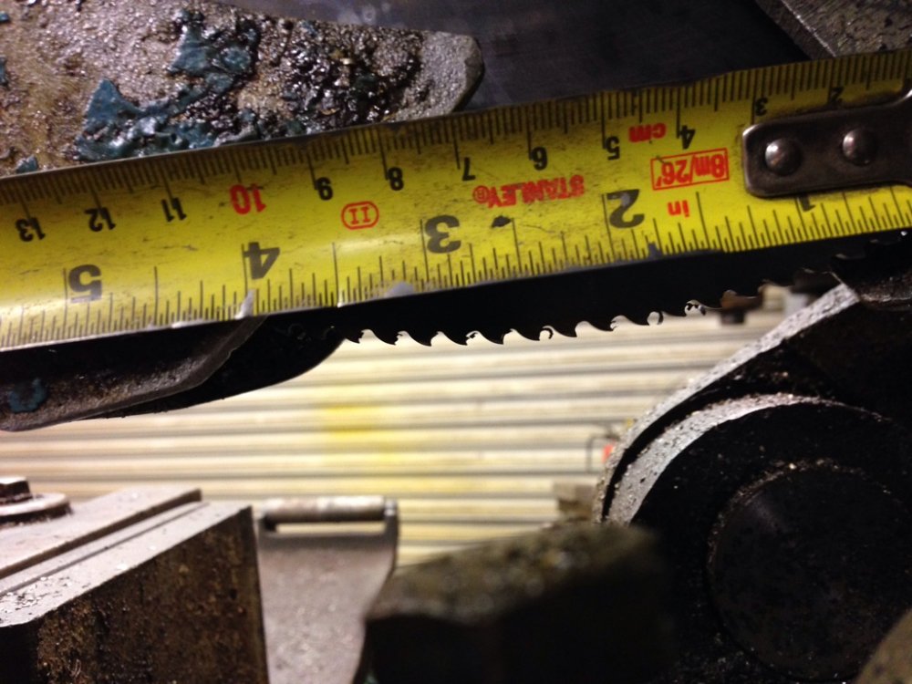

Is this like the blade you have?
How course or fine the blade needs to be depends on the material and the speed.
My saw has two speeds so I use a medium tooth count blade slow for thick material and fast for thin material.

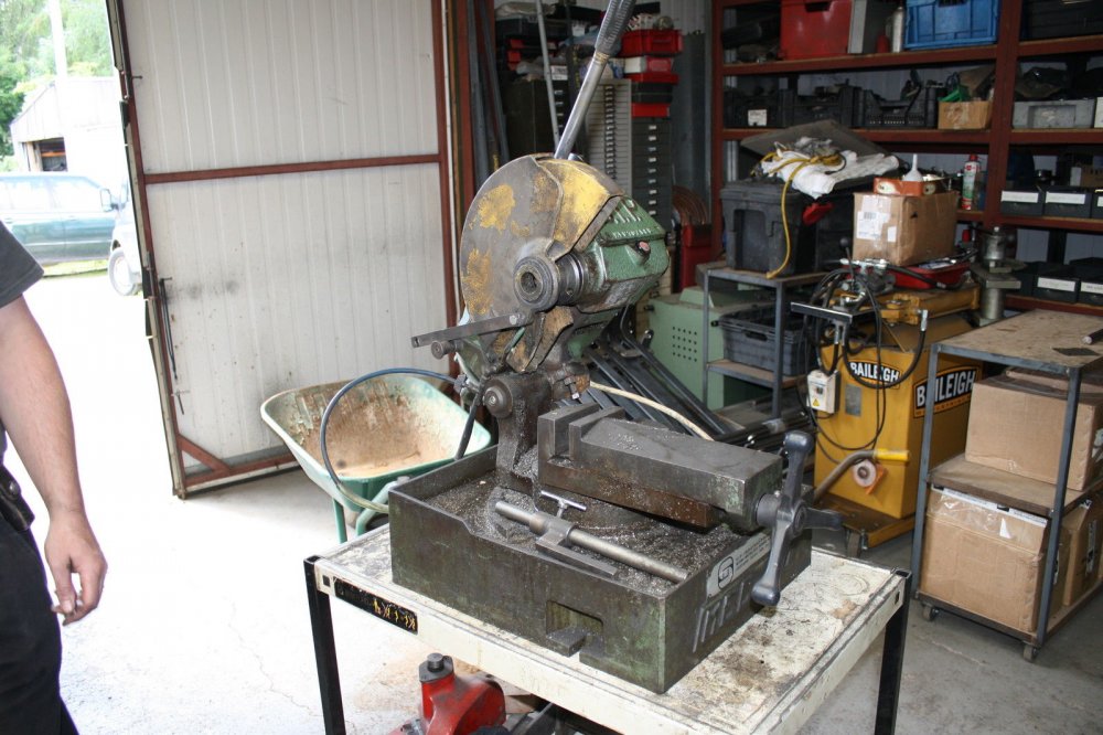

What's the baleigh industrial machine in the back, I've often admired their stuff.Mine o nly has one speed. Quite slow. Its a bit like this one only smaller at 8 inch blade. View attachment 46363
