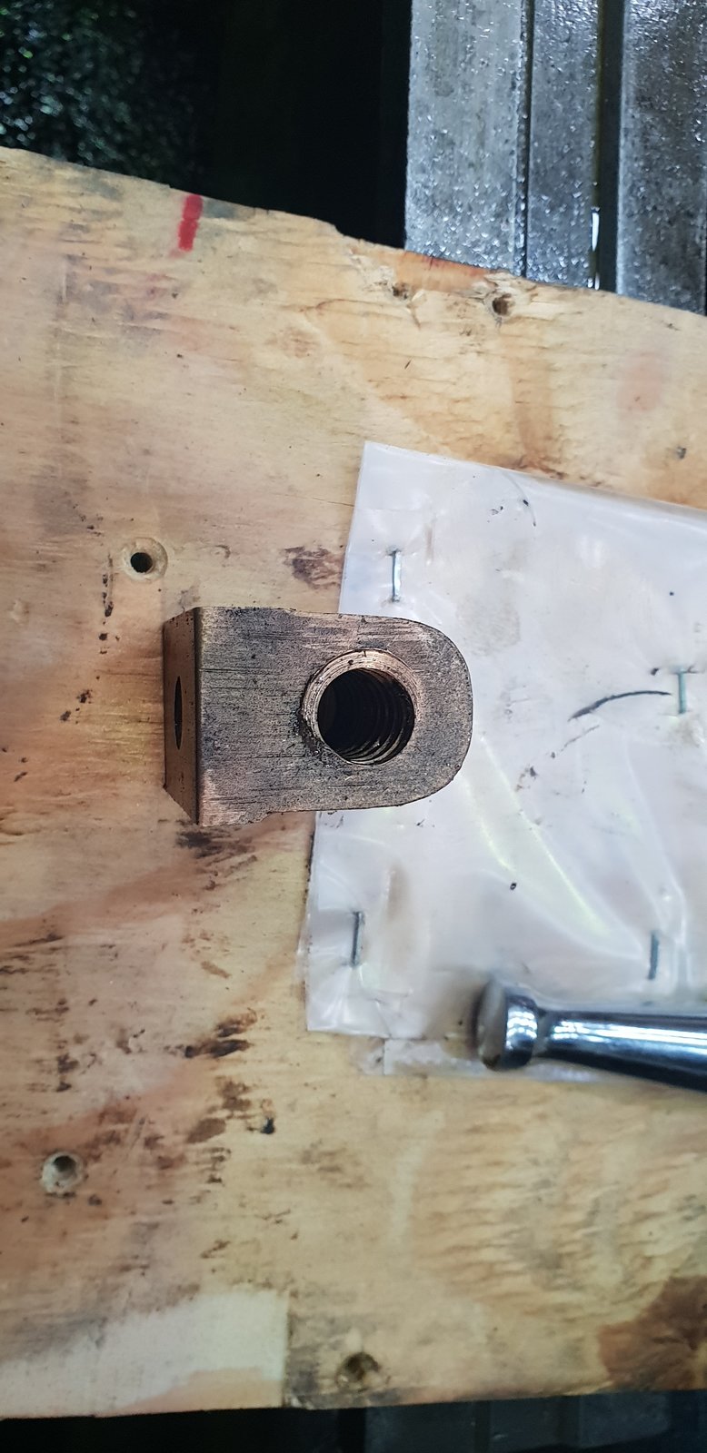

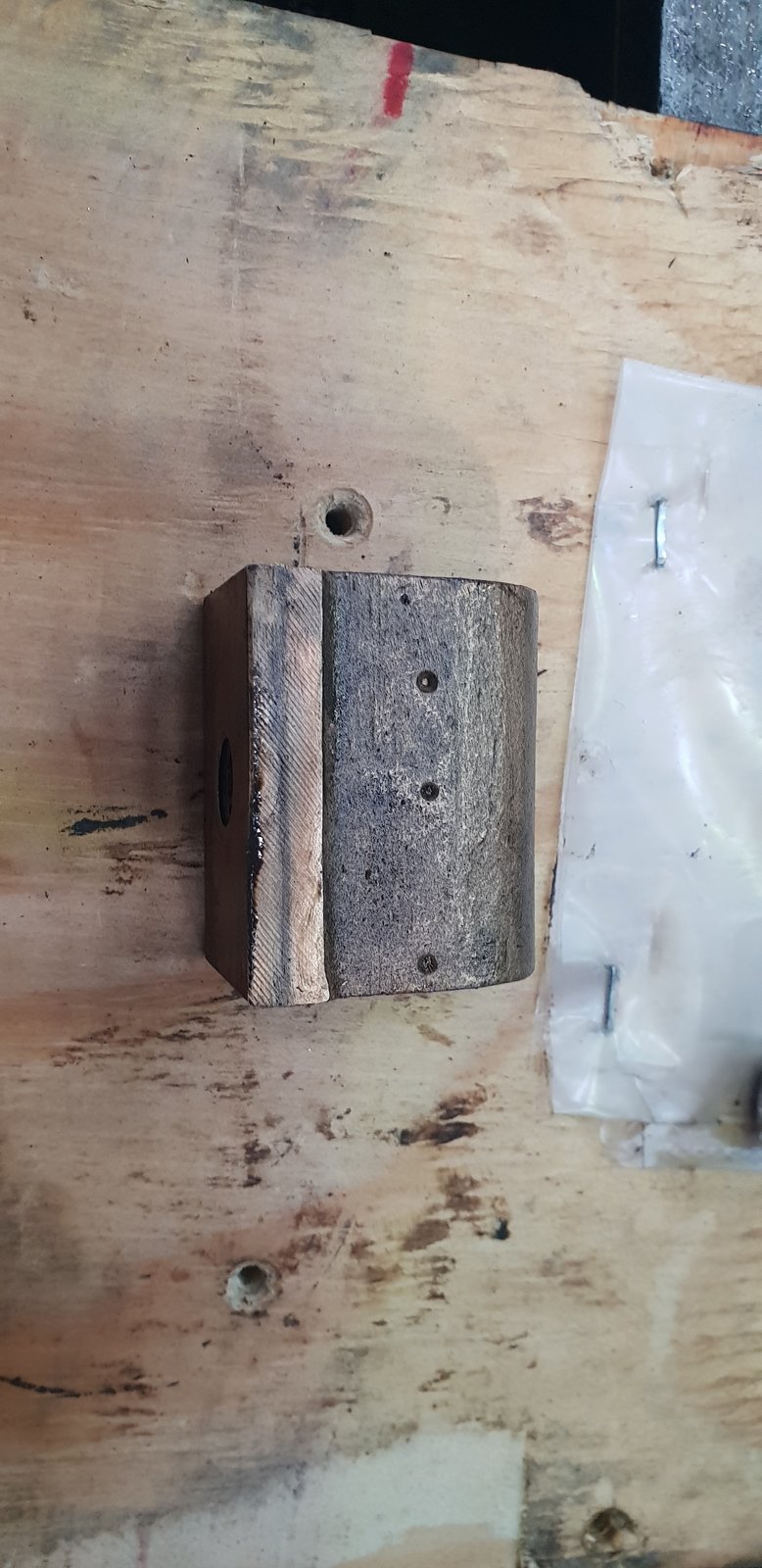

The only apparent wear in my Colchester Triumph is the cross slide nut. There isn't much backlash but you can push pull the cross slide and it definitely moves a tad and makes a clonk.
Anyone know where I can buy one?
Or would someone on here be interested in machining one for me?
On the plus side when I removed the nut I can slide the cross slide back and forth and there is no slop of any description - smooth as silk
