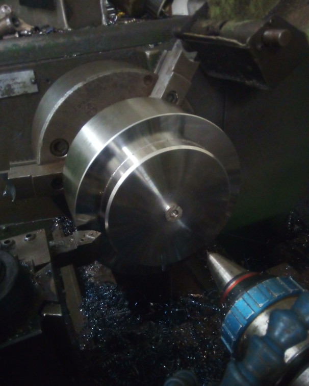

    They are reasonable lathes but a lot better out there, the round heads however are much better than the 2000 that I have, I had to fit a servo to the spindle and bypass the headstock gears because they are made of cheese and the noise is unbearable.
    Still use it a fair bit, turned a 220mm Dia lump of EN8 with it today, just have to put a 2.1/2" bore in it now.

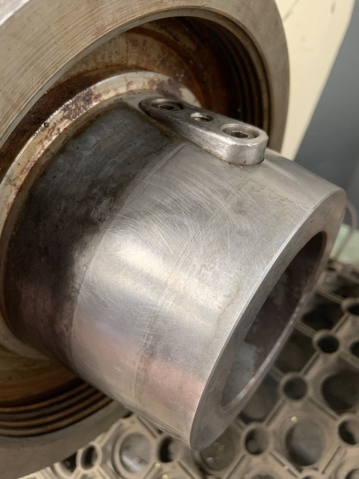

    Nose does have a internal taper. 3.00” down to about 2.825”

    Well it’s not a L1 spindle. It’s L2. How rare is that gonna be.

    Unique possibly!!!
    L1 is big enough - L2 must be huge. Not going to be easy to find chucks though!

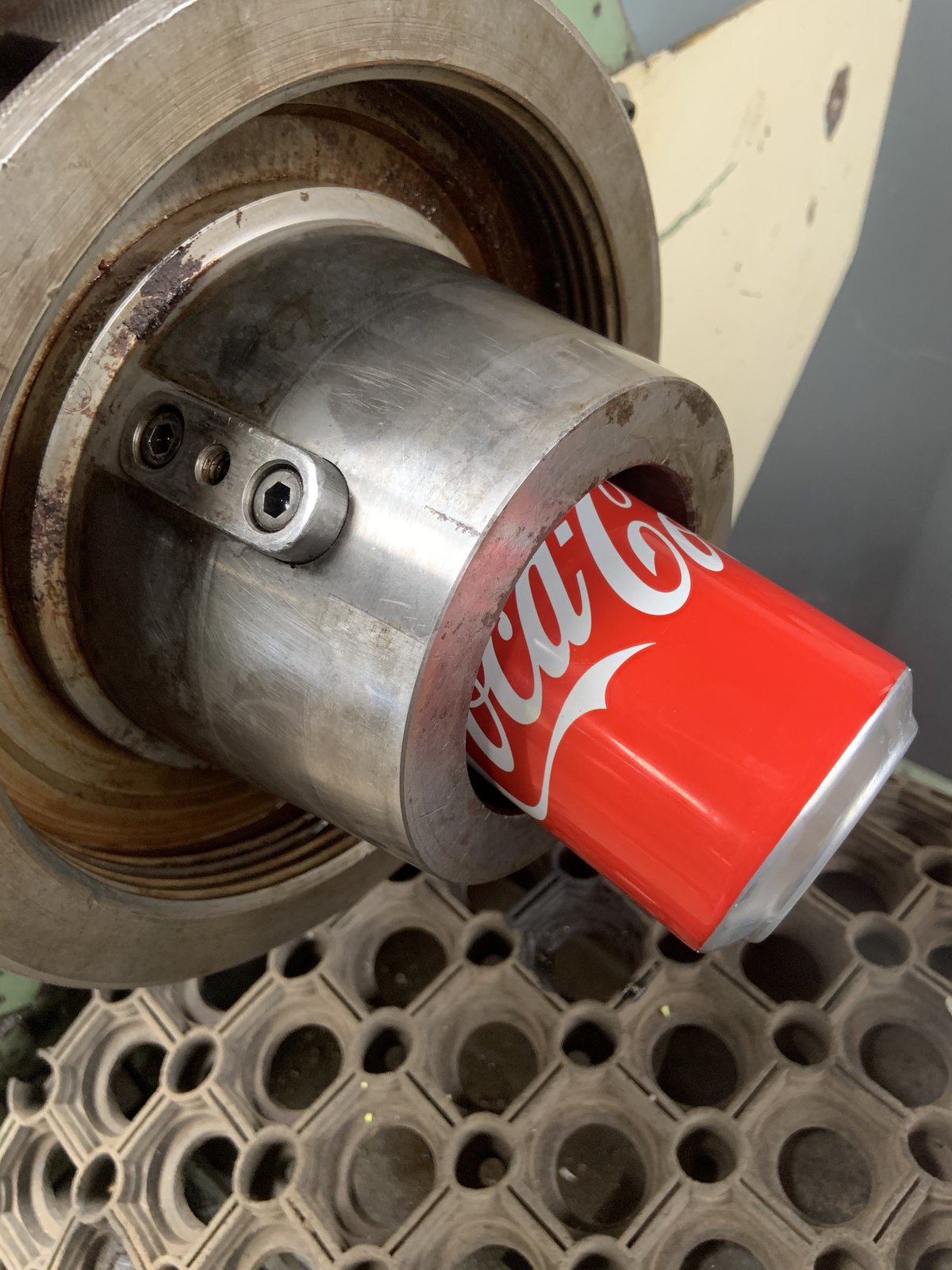

    That’s a coke can. It’s looser than a, well, God knows it’s massive!

    There are a few on Ebay USA. If anyone buys it we can offer cheap shipping back from there.

    Back plates are available from Bison so it’s not all doom and gloom.

    Jeepers, how big are the bearings?
    Wonder how many of these were made?

    Huge. Bearings must be 7 or 8” in diameter.
