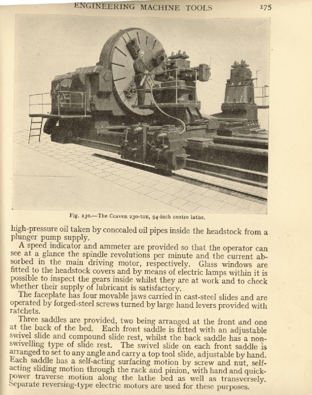

What's that in mugs roughly94inch
I would love to see something like that in use running a job, just as long as i wasnt paying for the electric.Just a toy chuck then?
Ha I wouldn't even want to change the tooling let alone the bearings.Definitely wouldn't want to change the bearings on it

Still going to be expensive, but once it's all reassembled and you're creating swarf all this will be but a distant memory. Thanks mate. I've now got a very accurate idea of size. That's a big lathe27, to the nearest mug - I thought everyone knew that.......![]()
