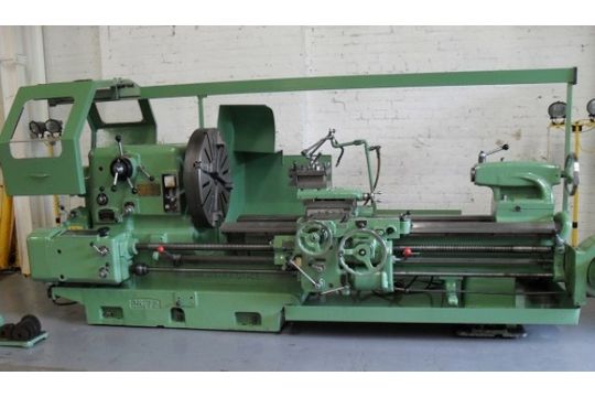

Bleeding thing would weigh more than my whole latheSpeaking of lathe chucks. My visit to colchester lathes was good. Not only looking for bits for mine. Also looking at all the other goodies. There was a huge chuck must of been 24 inches in diameter. Like to have seen what machine it was attached to
Something like this.Speaking of lathe chucks. My visit to colchester lathes was good. Not only looking for bits for mine. Also looking at all the other goodies. There was a huge chuck must of been 24 inches in diameter. Like to have seen what machine it was attached to

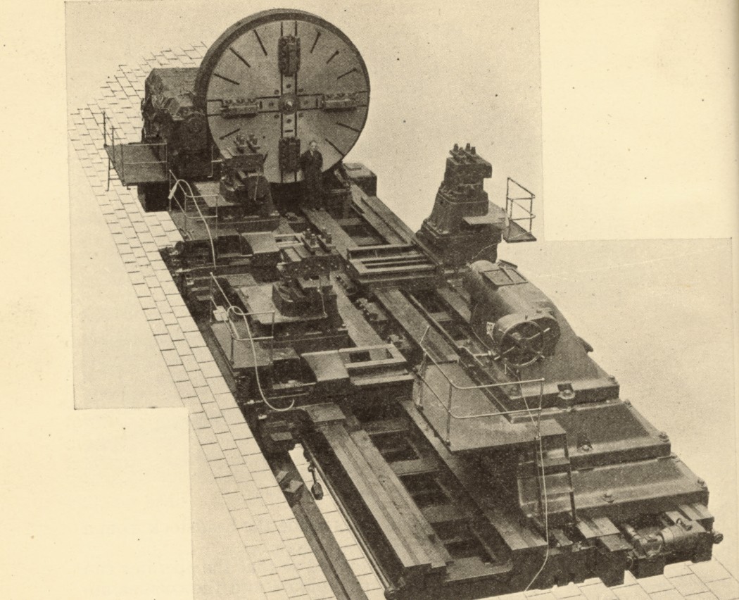

I can see the guy standing next to it but without a mug it's difficult to determine real accurate size
Definitely wouldn't want to change the bearings on itWell it is a Craven 230Ton with a 94inch centre height
