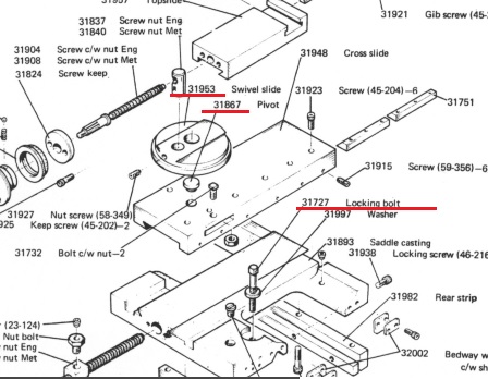

. You do need a lathe but neither of the parts you need stop the lathe you have from making the parts you need. G-clamps on the rear way in front and behind the saddle will do the same thing as the carriage lock bolt. A file will shape a piece of round stock spinning in the chuck sufficiently to make a top slide pivot.
