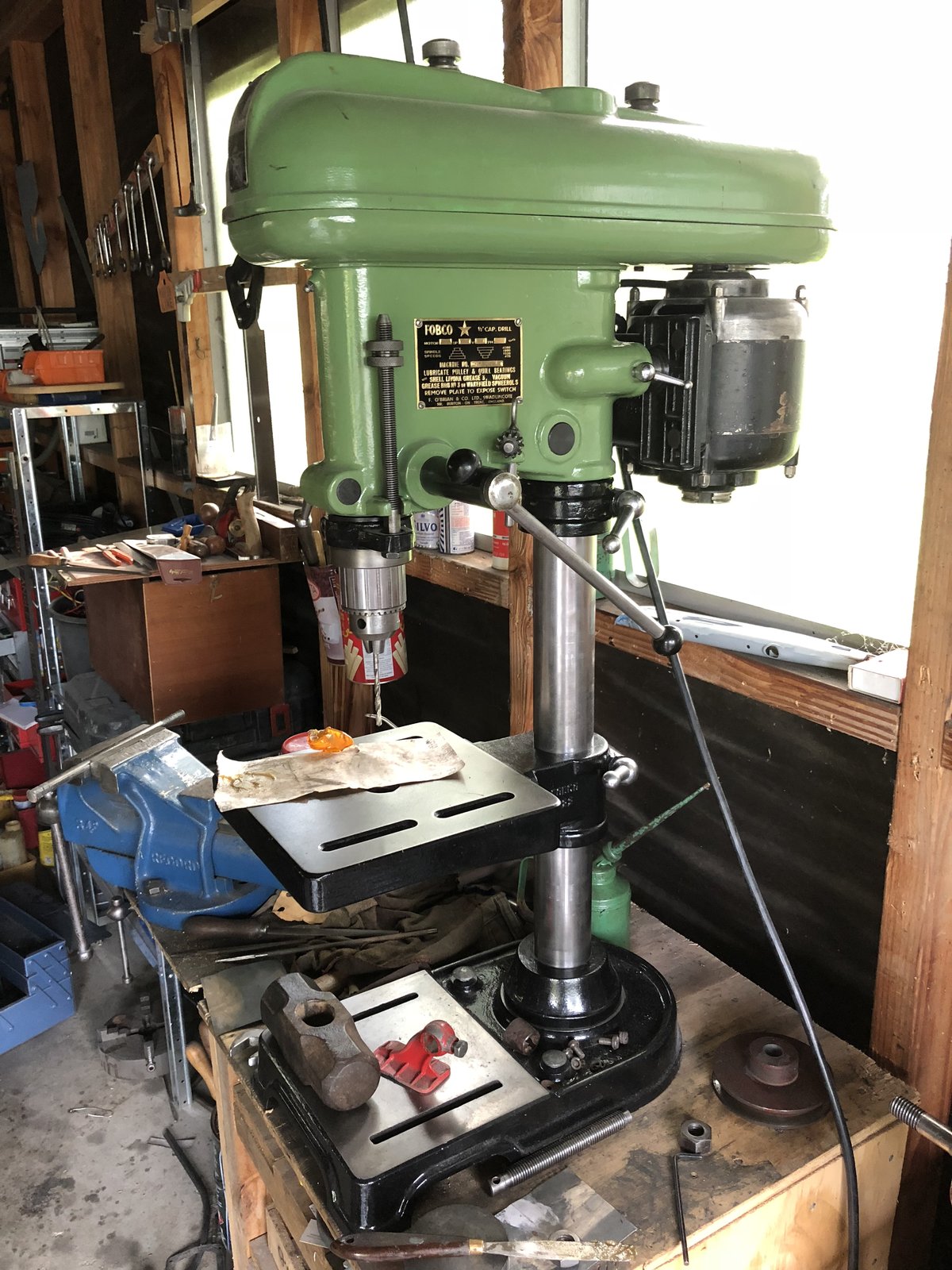

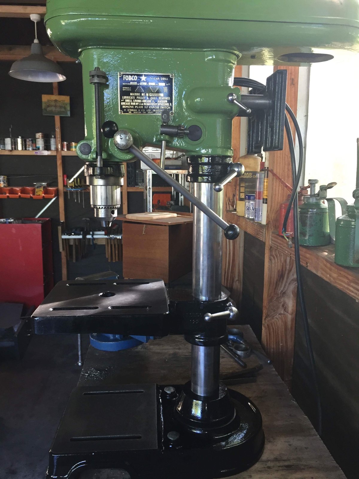

Looking good, for the top coat did you go for a gloss or semi gloss? just researching paints for mine and cant make my mind up
Whatever I am painting, spray jobs or skirting boards I always like to remove masking tape asap.I wonder how easy you will find it to remove that masking tape after it's been on for a while? Does the blue stuff come off ok?
I've had a devil of a job getting the other stuff off after it's been ok too long.

Dont feel too guilty. Need to find a balance between speed and attention to detail.Well done, loving the attention to detail it’s going to look great when all back together. Making me feel guilty with my restoration i’m just getting it “clean” nowhere near your standard.
Those Bosch sanders are good, very little vibration compared to the DIY ones.A lovely Bosch professional oribital sanderI've been ripping through the cabinet work today. Boring as hell, but faster than doing it by hand
While id love to go to @Dieselkid level i dont have the time to commit. Needed it working.
