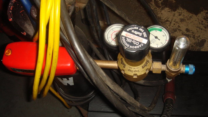

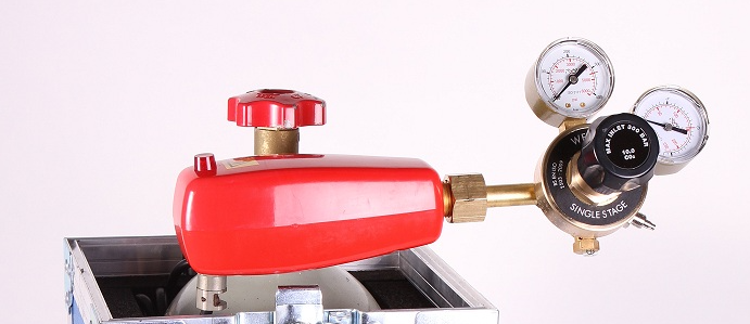

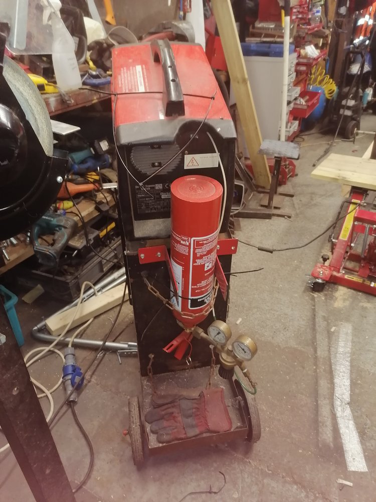

If I use my FE the right way up it will start to freeze, but mounting it upside down avoids that. Keeps the intake end of the dip tube above the level of the liquid gas.I did the same. The reg. froze up all the time, which meant the free gas wasn't worth it.
Mine was also inverted, didn't help though..If I use my FE the right way up it will start to freeze, but mounting it upside down avoids that. Keeps the intake end of the dip tube above the level of the liquid gas.
Perhaps there was no dip tube. Did you try it upright?Mine was also inverted, didn't help though..
norsemensafety.co.uk
All CO2 extinguishers have a dip tube.Perhaps there was no dip tube. Did you try it upright?
If I run into similar problems through using it for longer spells, I will have a serious look at one of those heaters.
