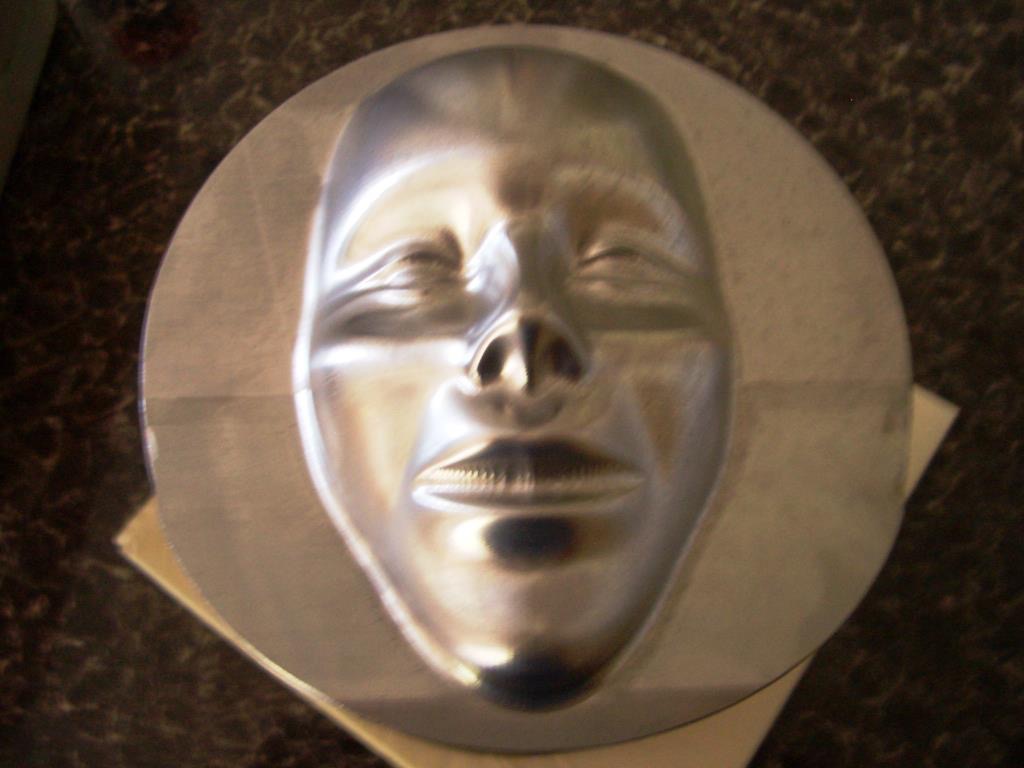

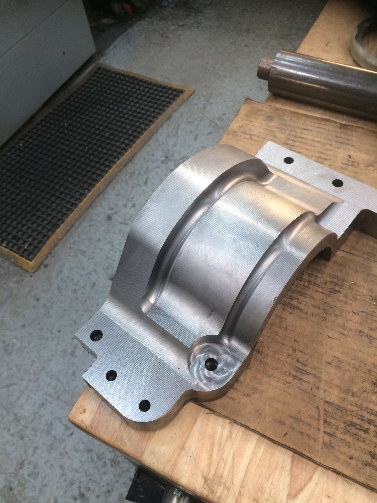

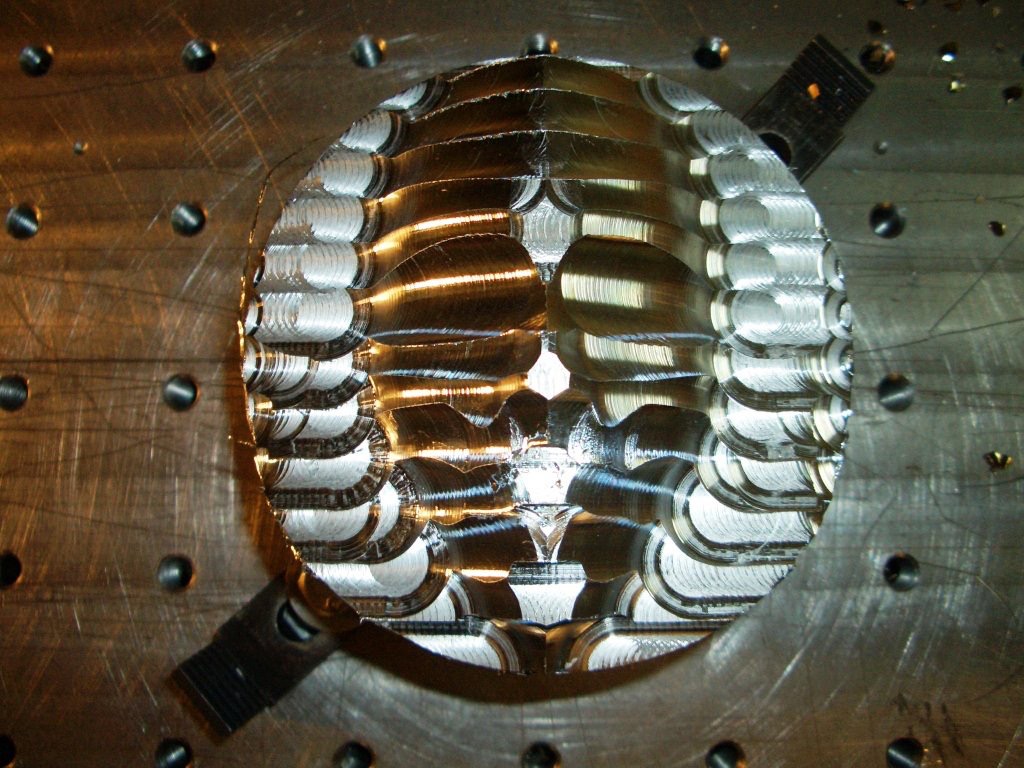

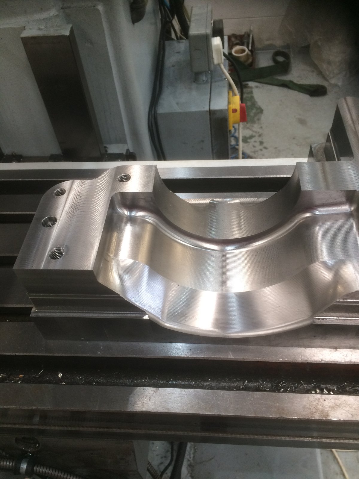

Looking at the insert I recently made for the Panther gearbox repair, First photo is all 2 and 2,5D. Front of second photo where the shape changes as it goes away from you is full 3D. The last two photos of Metal Mickey that I did a couple of years back are full 3DView attachment 208841View attachment 208842View attachment 208843View attachment 208844

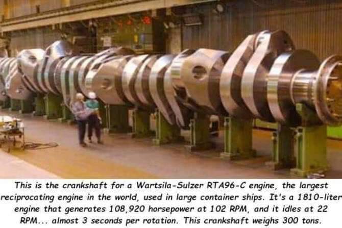

It's been a while since I seen one of those. Had the misfortune of changing a cylinder liner on one of those engines, unfortunately the engine room crane was gubbed so we had to use a 20t chain block. At anchor off SingaporeWe got this boys

It's been a while since I seen one of those. Had the misfortune of changing a cylinder liner on one of those engines, unfortunately the engine room crane was gubbed so we had to use a 20t chain block. At anchor off Singapore![]()
