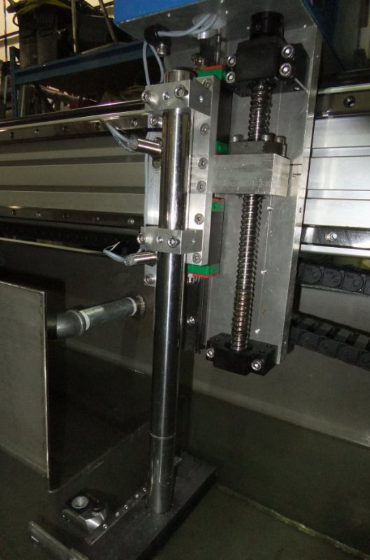

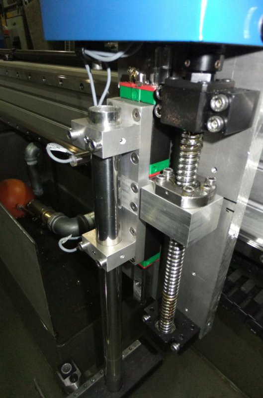

) Just visible at top right of next pic is a Huco coupler joining the stepper to the leadscrew, to accommodate any 'production errors' in their alignment
