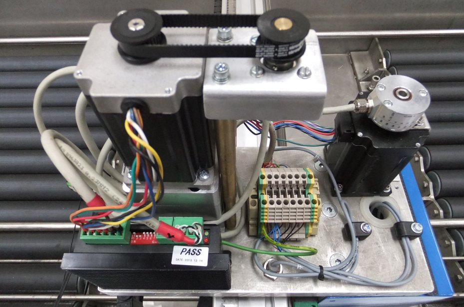

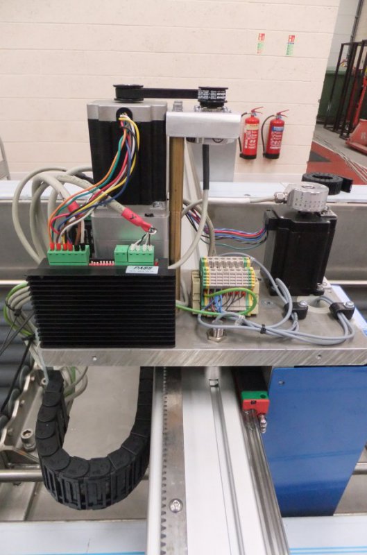

...Anyway, a quick couple of pics of my latest creation; this is the Y-axis carriage seen from one end of the X-axis beam (motor and 20:1 reduction box at left):
The Z-axis is hidden behind that blue cover, another of which hides all the untidy bits you can see here. You can see how close the carriage grease nipple is to the rail!
The belt-driven encoder is due to my forgetting to allow enough headroom above the Y-axis motor (the encoder would normally be mounted directly onto it); it was easier and cheaper to do it this way than to have a new alloy cover fabricated and powder-coated.
The rubber rollers in the background support and rotate the solid steel bars under test.
Note proxy sensors used to determine axis travel limits; the triggers are alloy cylinders with a screw through into a captive nut in the channel (seen to left of the Hiwin carriage in the first pic), makes for rapid re-positioning. Grey cables exiting hole at right in pic above are from the Z-axis proxies.

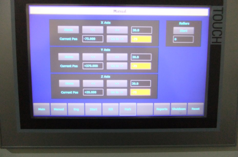

Bit blurred but this is the Manual control page of the HMI, allows each axis and the rollers to be run for setup etc.
