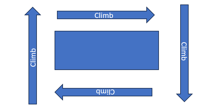

A picture is worth a thousand words-
Best way I find to think about it, is with climb milling, the cutter will want to 'climb' out of the cut.
Practically, you only want to be climb milling on something with next to no backlash, otherwise it's a recipe for damaged cutters and ruined workpieces, which can lead to even more damage.
I only ever climb mill on the CNC mill, as I know it's only got under 0.02mm of backlash, which for any cutter I'm ever likely to use on it, is negligible.
Strangely whilst that pic does show it. It would make more sense to me to have a pic with the table direction altering and the cutter always rotating clockwise as that what going to happen in the real world.
I think this one will help me more.
The thing here is, in the first example of climb milling you run a very high risk of pulling the work into the backlash but in the second example the depth of cut means it's much less likely.
