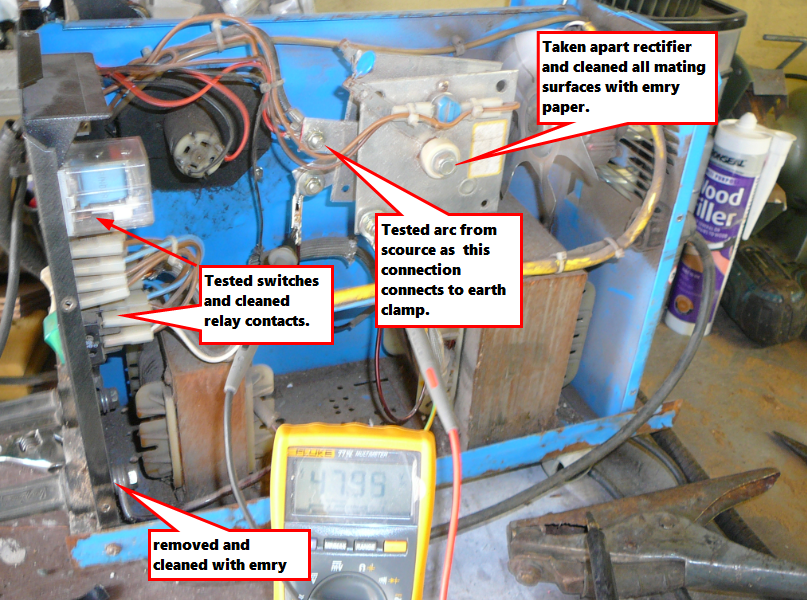

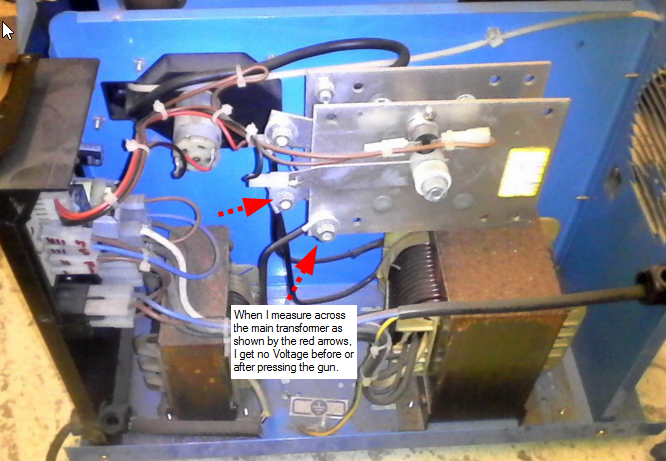

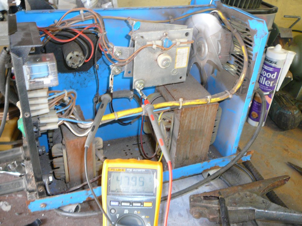

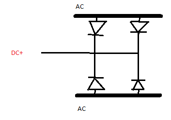

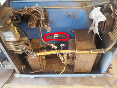

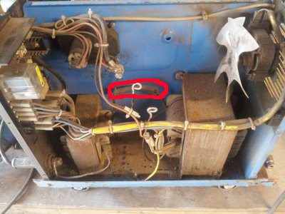

you shouldn't be getting a reading between the earth clamp and tip of the torch unless you pull the triggerThe output of the rectifier was 21 to 22 VDC. The Voltage across the terminals of the smaller transformer was about 21 to 22 VDC and also obviously at the gun tip and earth clamp, however when I pulled the trigger the volts go down to 15VDC.
Any further ideas on what to check? is it a PCB issue rectifier? Should I just bin it and buy another?

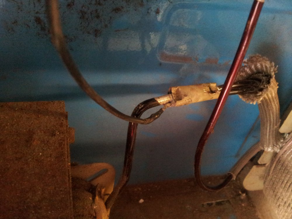

that's why I asked if the voltage changed when you altered the power switches, if it does then its working but you have resistance, glad you got there in the end
