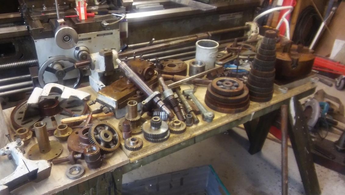

    My holbrook that was just over £300 came with everything! This picture was just some of it

    Even the relieving slide... Nice! Which model?
    I got a pretty bare lathe, Dickson QCTP, Pratt-Burnerd 3 and 4-jaw chucks, full set of collets/adaptor/drawtube, but the previous lathe (a Challenger from the 40's, worn out and no change-gears, cost me £70 with a 3HP motor...) came with an assortment of bits and pieces, most of which didn't fit (3 Morse etc.) but fit the Holbrook - I kept those!

    A nice selection of goodies
