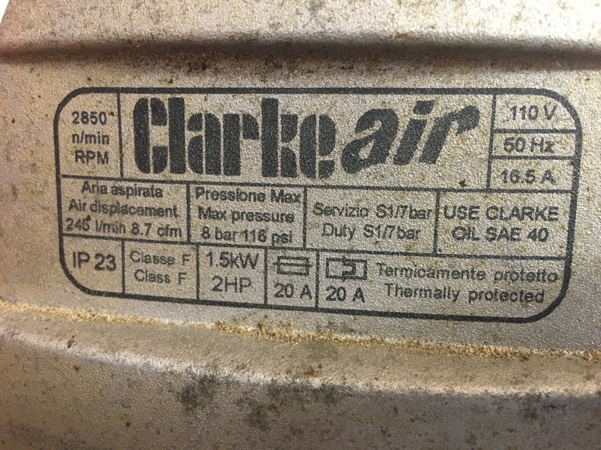

What HP is the motor?

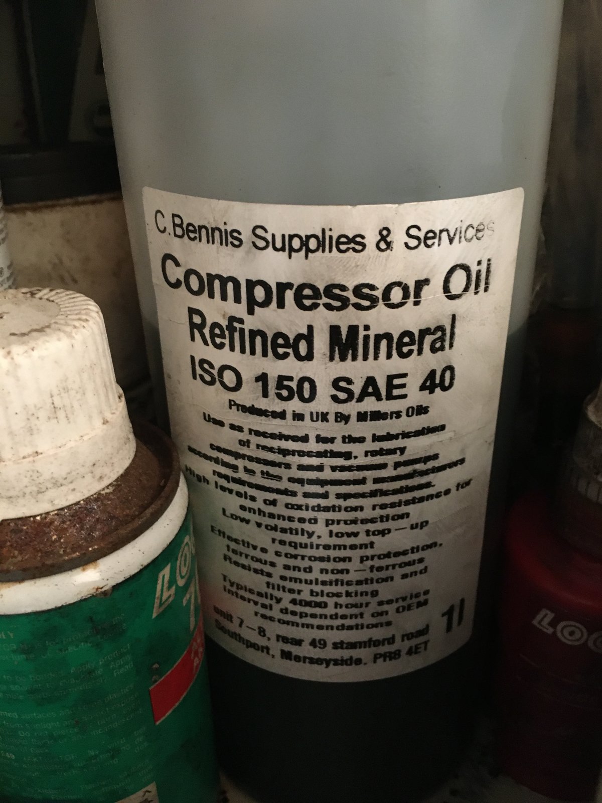

What grade oil did you use? I'm in the middle of refurbing another clarke and its developed similar after replacing the oil. manual states SAE40, but the WWW seems to advise SAE30 for clarke piston comps.
I am not sure of the rated motor power, there are no markings on it at all and I don’t have the manual for the exact model. It takes around 20 Amps after the initial starting current of 45-55 Amps, which is around 2.2KW or 3HP @ 110V. The original capacitor was 60uf 330v (measured 58uf), but I replaced it with a 60uf 440v item (no reason for the 440v except that’s all I could get quickly) and it made no difference.

I thought the current draw was the problem until I remembered it is 110v.
Still I'd expect it to be drawing slightly less than that, if it's 3HP it's working hard and on the limit.

I used ISO 150 (SAE 40) mineral compressor oil when I did the oil change. The oil I dropped out was the original oil so I assume this spec too, and the compressor used to run fine. My original thoughts when I had this problem was corrosion in the bore as it had stood unused for 8-10 years until this year. When I stripped it down it was like new inside so I dismissed that theory.

duty is 7bar. you dont run it any higher do you? I'm assuming that the 16.5a is based on a service duty rather than max pressure?
Oil is too thick(not letting go of that one haha!!)
