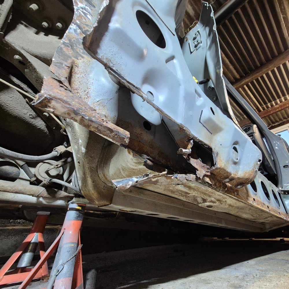

It's a mk1 mx5, but fairly heavy restoration as it was quite bad.What car are you restoring?
